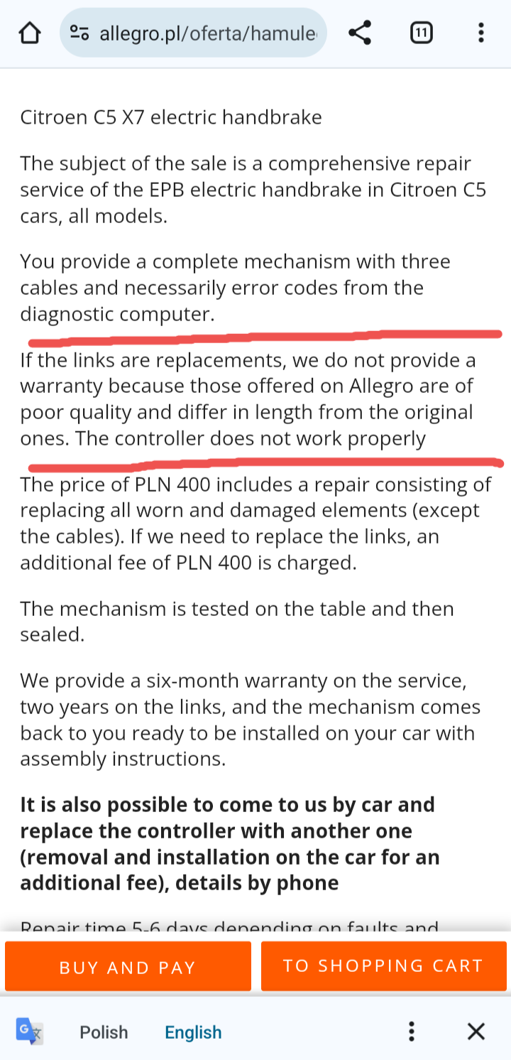

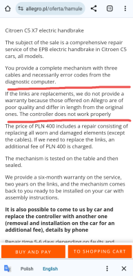

Hmmm, this page on the Polish site: https://allegro.pl/oferta/hamulec-reczn ... 4440595732
Seems to undermine confidence in the cables offered on that same site! I'm taking "links" and "cables" to be one and the same (and a translation error)
They offer rebuild of the motor but seem to expressly exclude the cables!
I'm coming to the idea that the site is a "selling platform" (I e. eBay, Amazon Marketplace, equivalent)

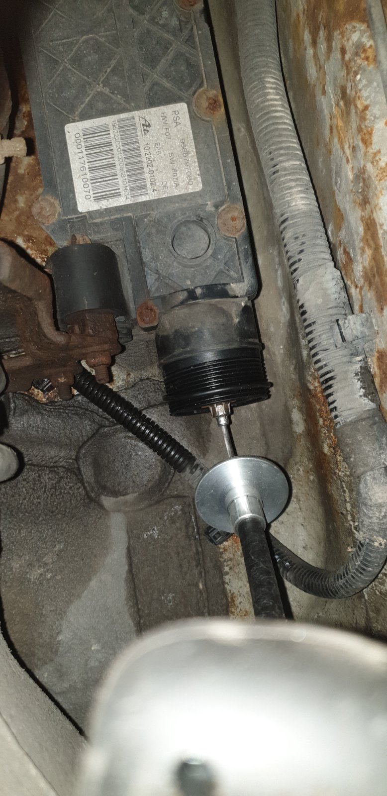

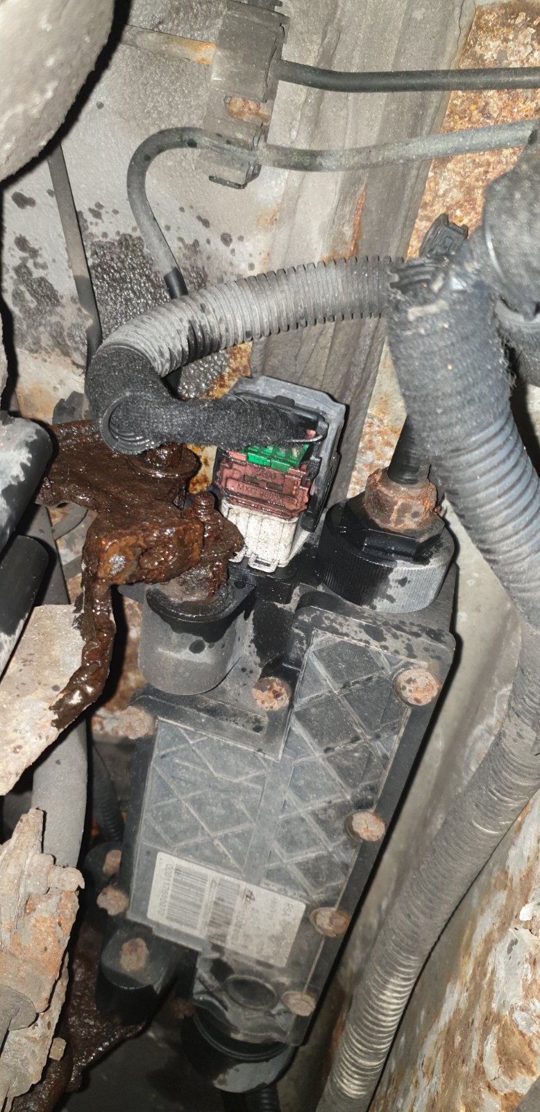

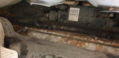

I thought I'd add my experience to this thread, to help anyone else who stumbles upon it...
So first of all, contradicting what has been said previously, you do not need to remove the brake motor assembly. You also do not need to pull it apart... which is just as well as the bolts holding the motor on rust like crazy!!

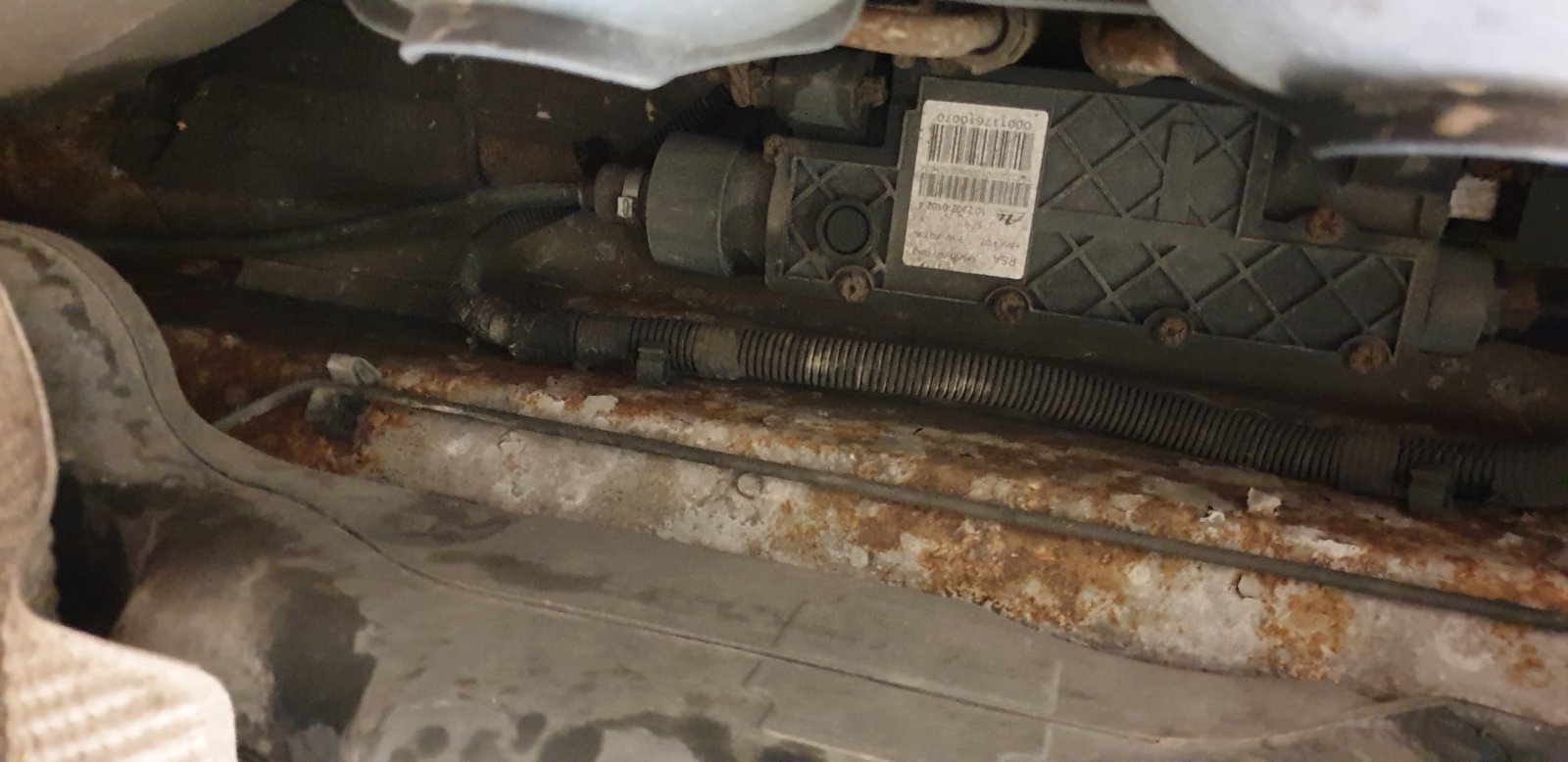

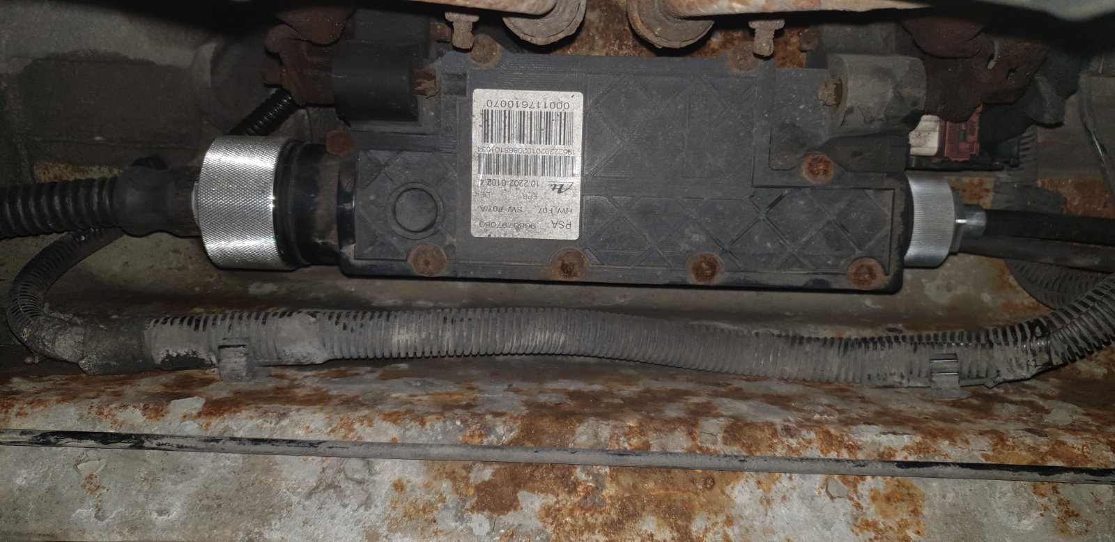

This is the said motor, with rusty fixings!

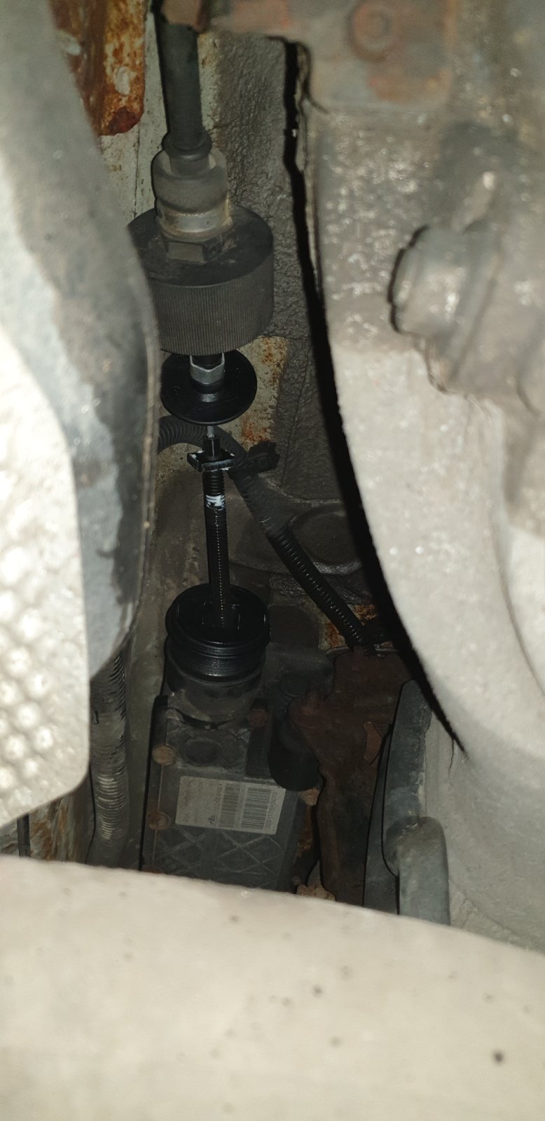

But it does help to understand what's inside. The motor works because one side of the cable (the drivers side) is hooked on to a sliding motorised rotating female thread, and the other side of the cable (the passenger side) is attached to a threaded rod that is pulled in/out by the said female threaded motor. These videos do a good job of showing the principlal, though its on a Renault motor.
This video is also helpful, as it shows how to release the cables from the rear wheels. But it does not show the motor.... For information, the plastic parts shown in this video came with the new cables when I bought mine, but it's probably worth checking they do with your new cables.
So with that knowledge... you can then proceed to do your own cables.
First you need to buy the cables themselves, and there is lots of info on that further back in this thread. I can imagine the availability of those will change over time
When you have the cables, the motor needs to release the existing cables so they can be removed, I used Diagbox to put the brake in service mode.
THEN DISCONNECT THE BATTERY SO CAR CANNOT RE-APPLY BRAKE
Then put the car up on axle stands in all four corners, so that it cannot roll away

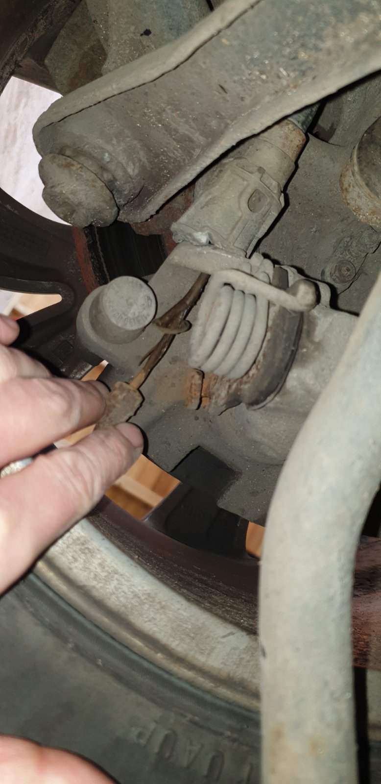

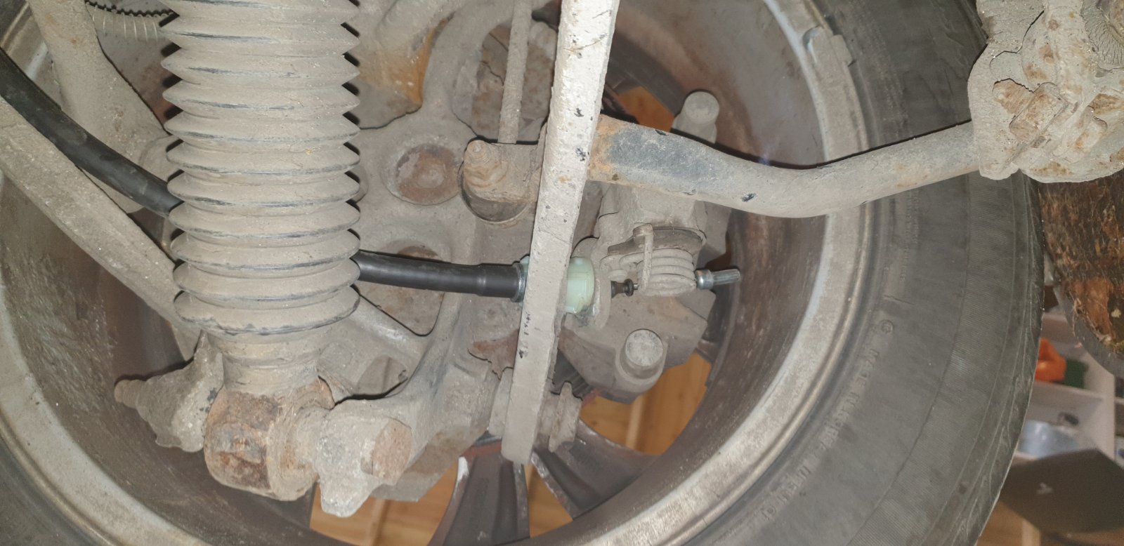

Release the cables at the rear wheels.

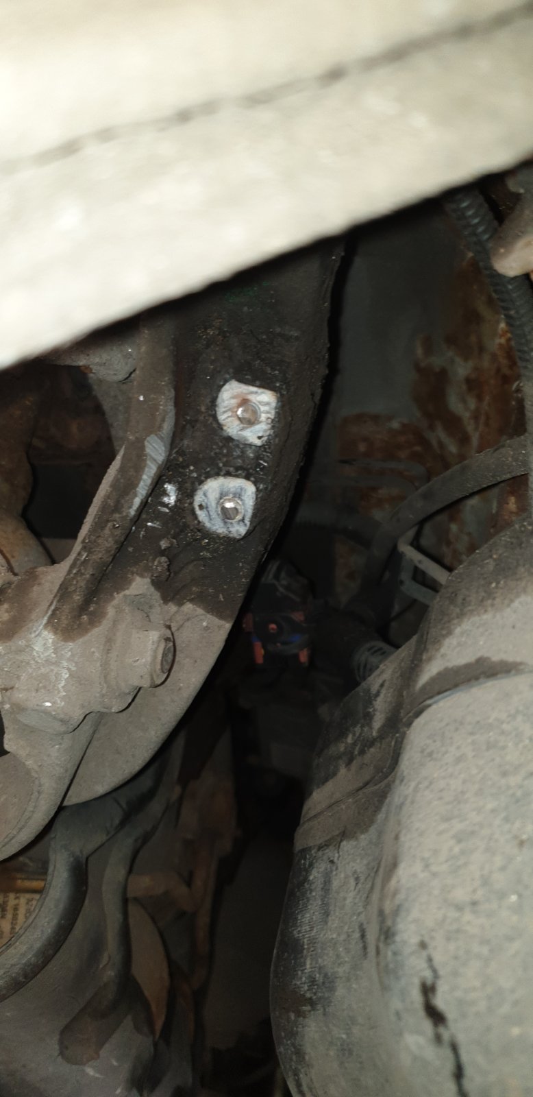

There are brackets holding the cables in place between the motor and the wheels. Mine had completely rusted bolt heads, which had to be grinded off... Do not worry about replacing these if you need to do the same. They are nice to have, but the cables are short enough that it does not harm if you do not have them fitted.

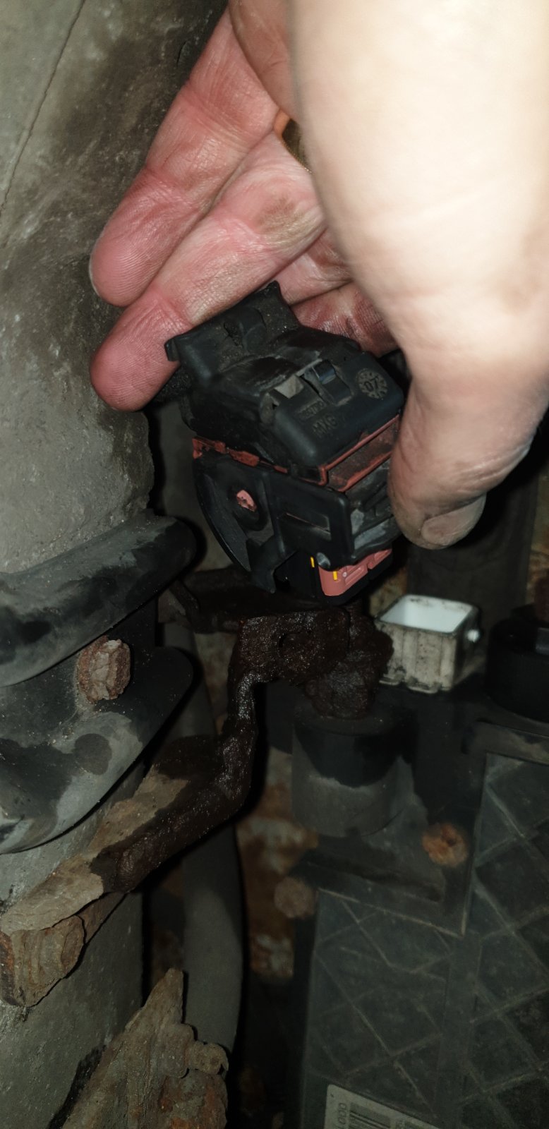

Slide off the electrical connector protective cover.
Release the electrical connector on the brake motor assembly. It releases by a button which you cannot see as its on the other side. Find it and the slide rotates away and releases the connector.

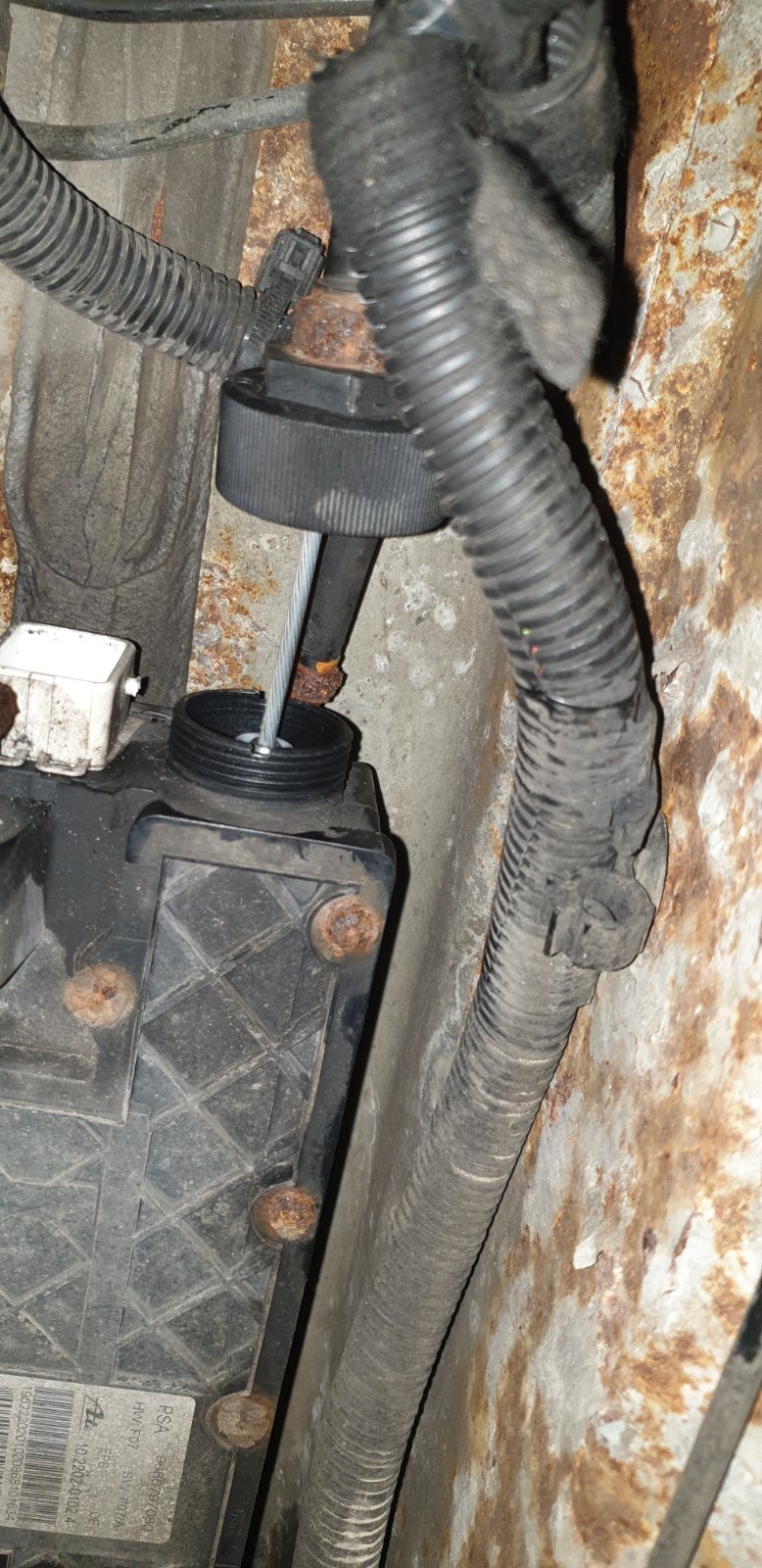

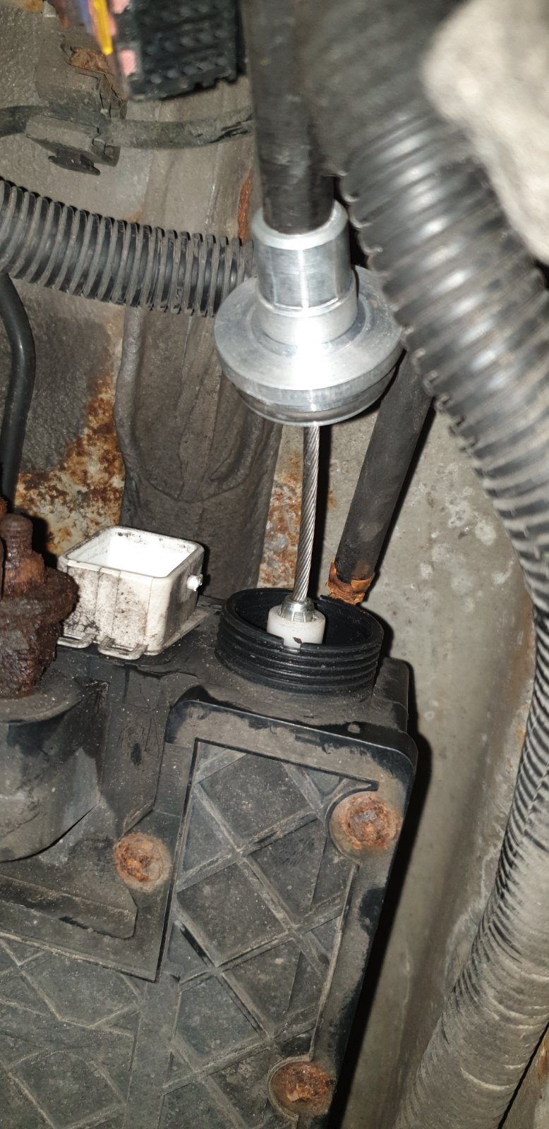

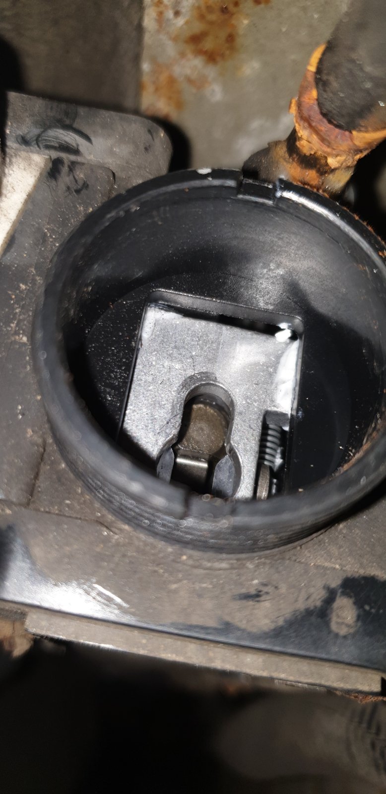

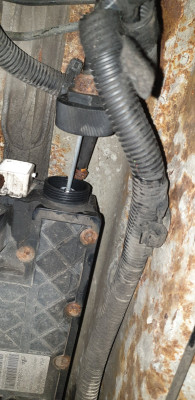

Then you remove the cable end caps each side of the motor assembly, by twisting and unscrewing the them. They were made of black plastic on mine, but I noticed my new cables had aluminium end caps. They do just unscrew, but might need help from a pipe wrench of similar to get them started.

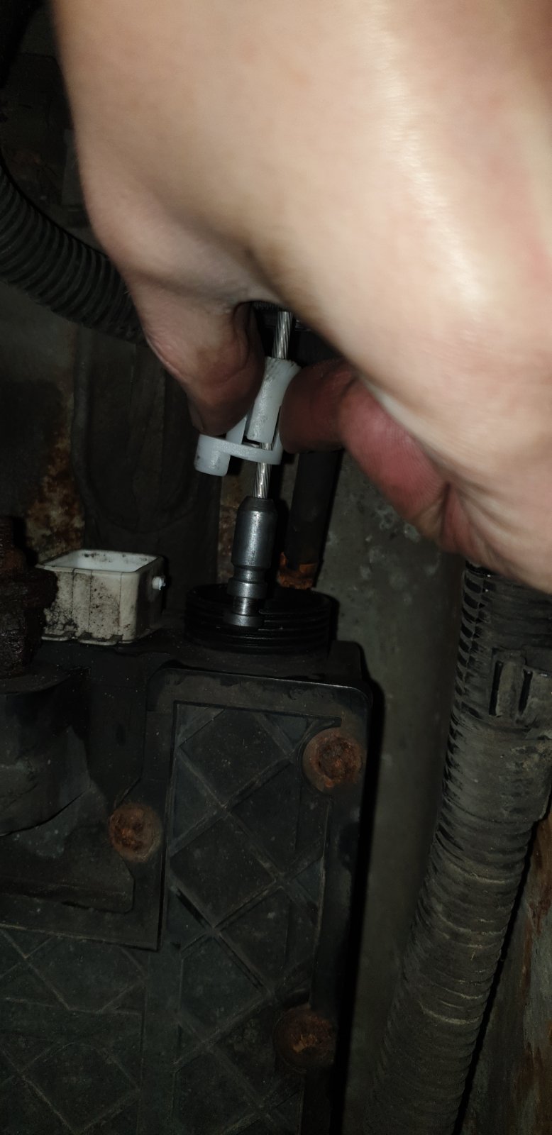

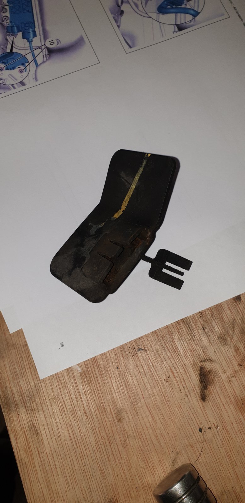

On the drivers side of the motor assembly, the cable is fixed using a keyhole shaped catch in the motor. The cable end has a special shape that makes it captive, which slides up and into the keyhole, then a white plastic end cover has a special shape that fills in the bottom of the keyhole, and stops the cable end sliding down and releasing.
So to remove the old cable, you have to wriggle and unclip the white plastic cover out, then this allows you can slide the cable end down, and out of the motor. Hard to explain, but hopefully the pictures will help to show what I mean...
This is what's left... so you can see the keyhole shape.

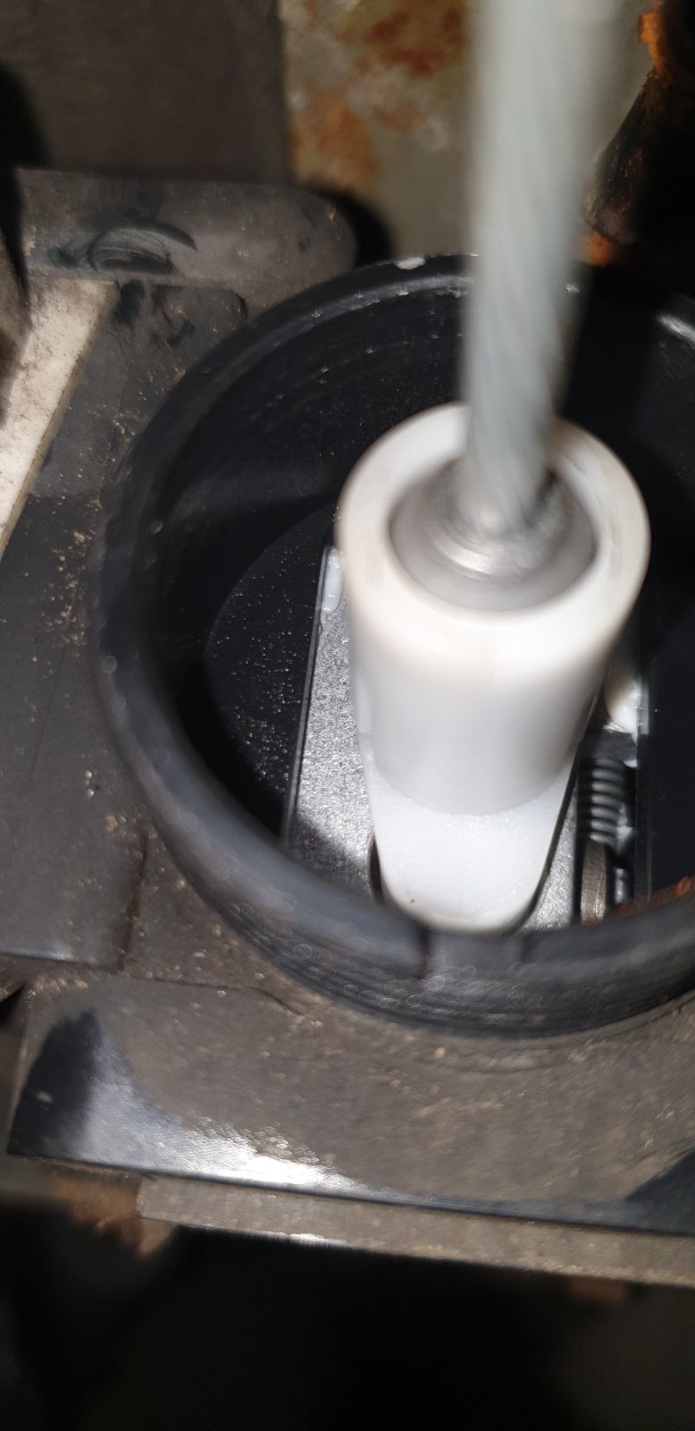

Then you simply slide the new cable end in and up into the brake motor, before pushing the white clip in, which snaps into place and holds the cable end in.
But don't tighten the screw cap yet...

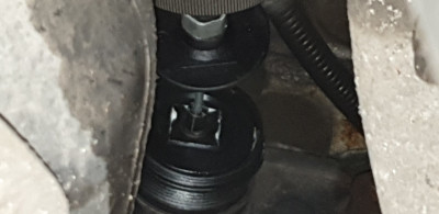

Next go to the passenger side cable end at the brake motor.
Again release the plastic cap which unscrews.

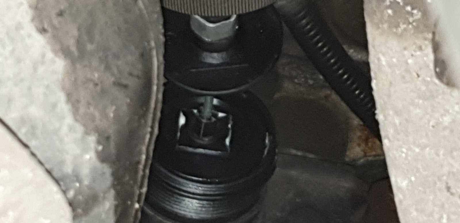

But this time there is a square end at the brake motor...

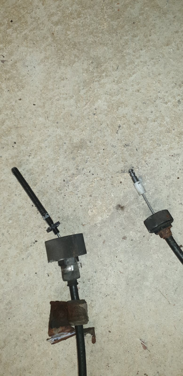

Pust the drivers side cable in to the brake motor, and the passenger side one feeds out, you may need to unscrew the threaded end to fully released it.
It looks like this when out.
So then to feed in the new one, put the new threaded end into the brake motor, and then push the drivers side cable in as far as you can. This pushes the motor thread to the passenger side of the motor. Then wriggle the threaded end of the cable around until you find the threaded opening inside the motor, and then rotate the square end of the cable to thread the cable end into the motor.
Then you can push the square end into the motor, and screw on the end cap.
You can also then replace the drivers side end cap too, and thats the motor part done.
Next thread the cables through each side, and fit at the wheel ends.
Thats the cables fitted. You can lower the car back on its wheels.
Reconnect the battery.
Do a "Park brake calibration" in diag box.
Then that should be it.
I would imagine I did not explain all of that perfectly, but hopefully it will be enough to help others to do it without having to remove or pull apart the brake motor assembly.
