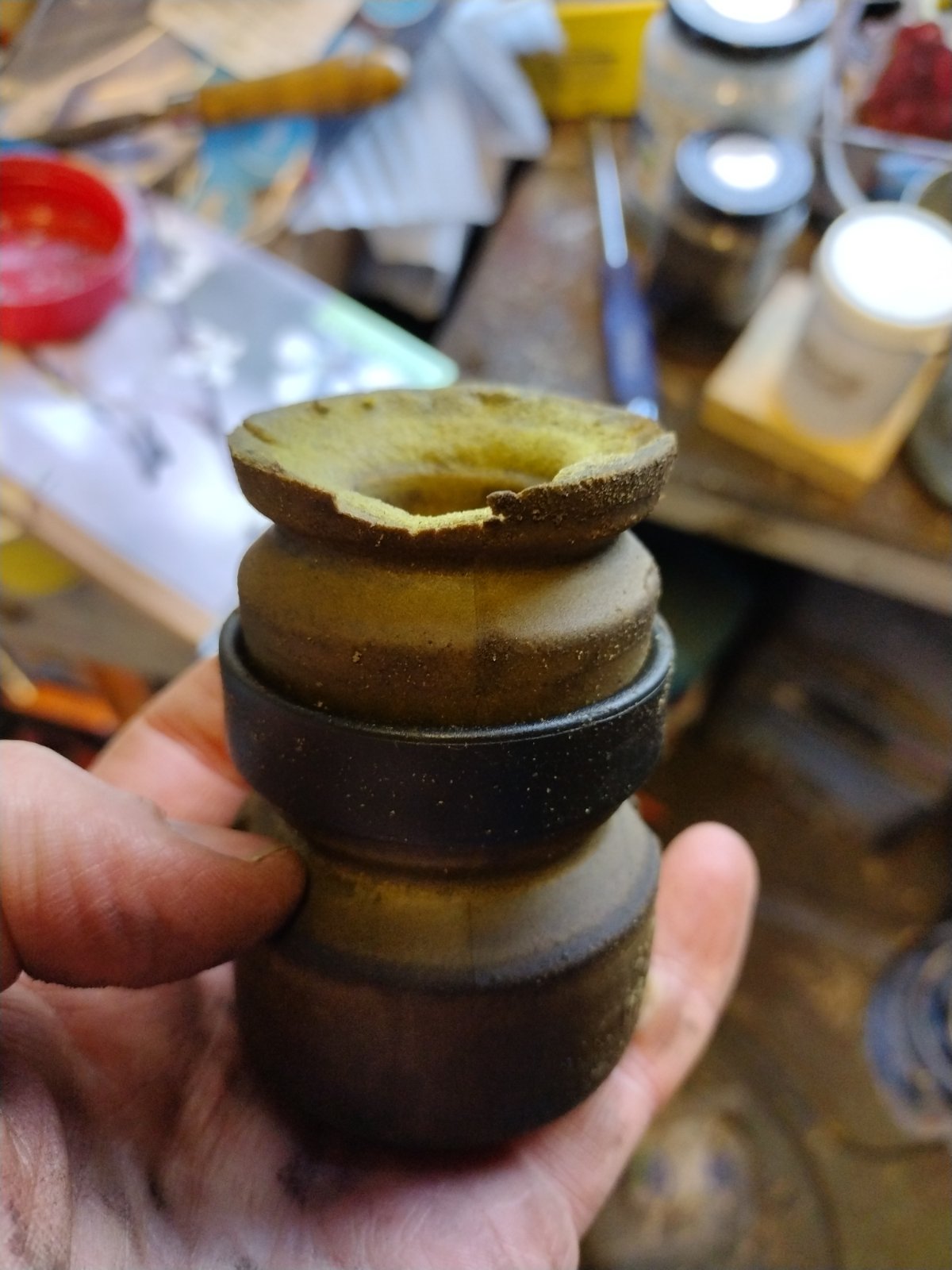

Wondering if this bump stop has been shortened, or this is generally how they tend to fall apart??
Other than some powdered foam dust, no sign of missing bit. Dust shield intact

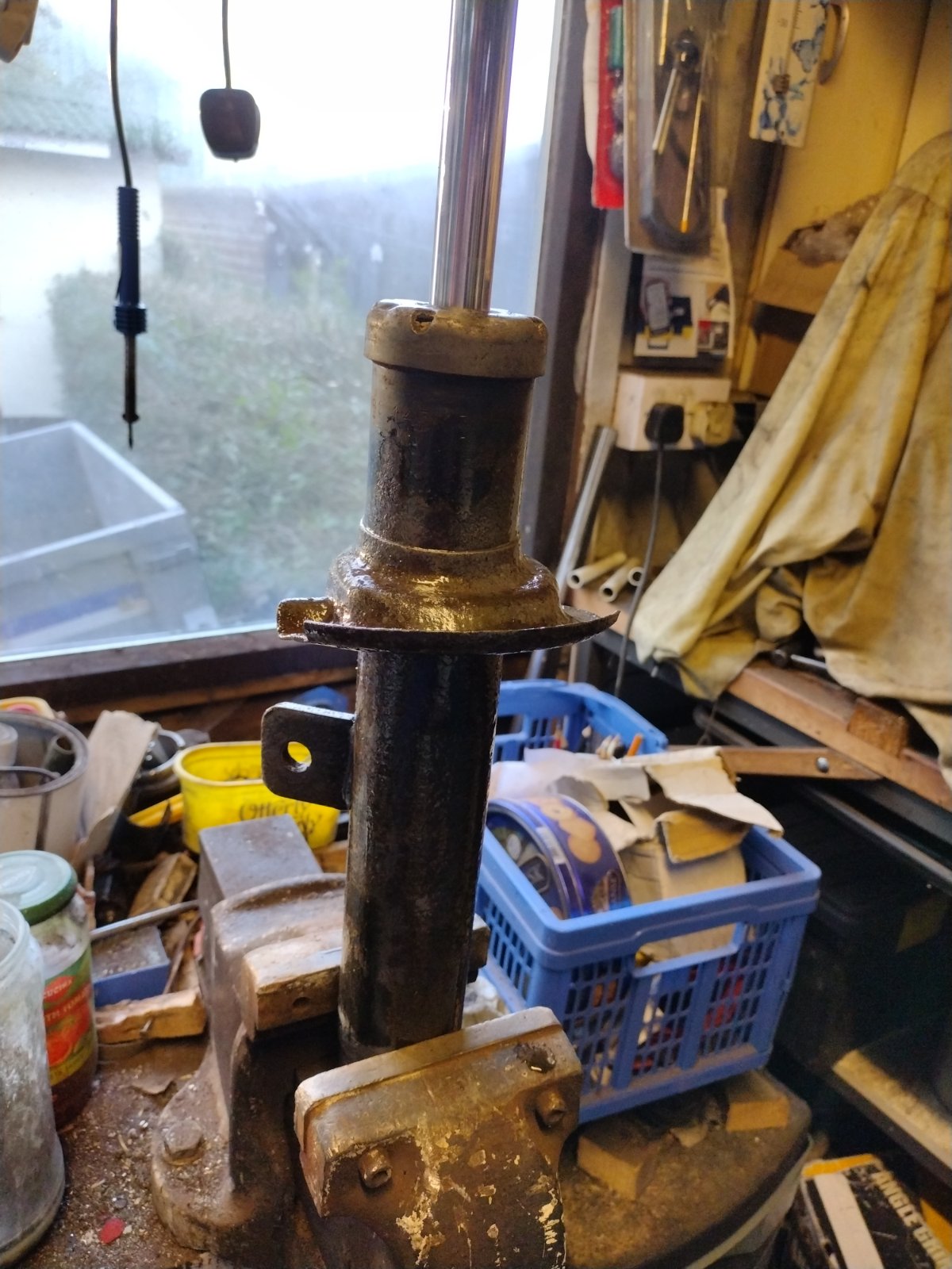

Post phosphoric, ready for paint

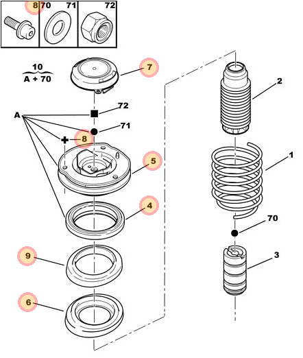

No problem, went all over the place seeking a solution to my rusty problem!Rp0thejester wrote: 25 Oct 2023, 18:23 I must have missed something, the 607 parts are compatible with.....???
406 Coupe, front suspension upper components, info courtesy of Marc of course!
And from here:GiveMeABreak wrote: 25 Oct 2023, 12:53 That boat's sunk Matt:![]()
(4) Shock Absorber Ball Thrust Bearing, part: 503554, (NFP)
(5) Shock Absorber Bracket, part: 503866 (NFP)
(6) Front Suspension Rest Cup, part: 503142 (NFP)
(7) Shock Absorber Fix Cover, part: 503533 (NFP)
(8) MUL Bolt with Captive Washer, part: 503613
(9) Front Suspension Rest Cup, part: 503147 (NFP)
Peugeot 607 front suspension upper components:
(Again, thanks to Marc!!)GiveMeABreak wrote: 25 Oct 2023, 15:44
(4) Part: 503554 (NFP)
(5) Part: 5037C0, NFP)
(6) Part: 503147 (NFP)
(9) Noise Deadening Mounting Part: 503364 (NFP)
As you can see, there's a little bit of overlap between the two.
Spring: different (does not have "pigtail' at bottom of smaller diameter, unlike the 406)
Damper: different (to suit spring)
But the bit I need "front suspension rest cup" confusingly number 9 on the 406 diagram and number 6 on the 607 diagram = 503147 = common to both!

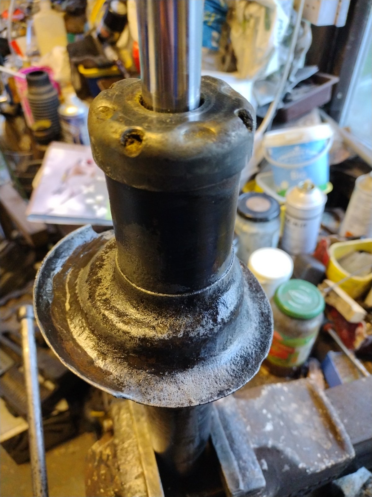

That rusty chuck of suspension needs to be swapped for something solid.
