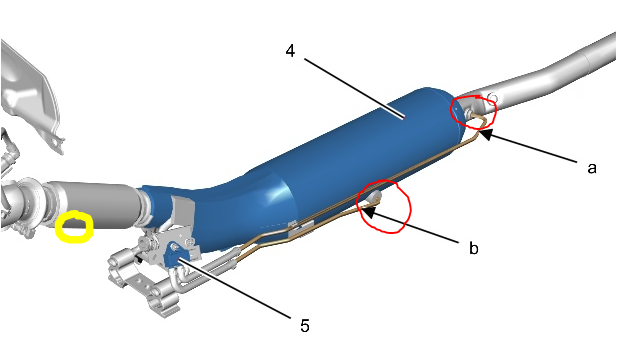

They are not related at all in that they have no interaction with each other and neither do the control systems.
So this is a one assembly module that contains the DeNox Catalytic Converter and then the DPF.
The particle filter pressure sensors are mounted upstream (before the DPF part) and then downstream (after the DPF filter).
The Adblue injector is way before there and once the adblue is sprayed in, it turns to ammonia from the heat and this reacts with the nitrogen oxides and the oxygen to convert it to water.
As you can see from my picture circled in red: 'b' is the upstream DPF sensor which would be just before the DPF (4) inside the assembly; 'a' is the downstream DPF sensor; the yellow circle is where the Adblue injector is located (though not physically shown on this diagram as this is for the DPF part of the system). (5) is is just where the differential pressure sensor is mounted are and where the pipes 'a' & 'b' shown connect back to, but the measurements are taken at 'a' & 'b'.
