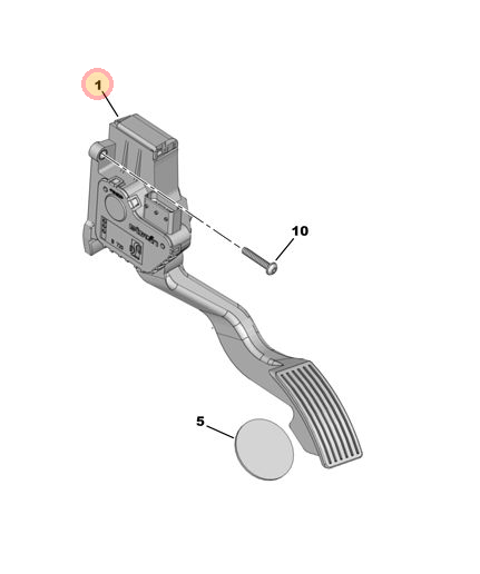

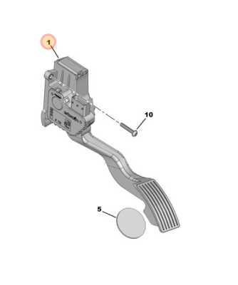

Re: Peugeot Boxer 2.2 110 NEW fault code P2137
Number on my pedal is 005332091900B7207163732215
Am I correct in cross referencing this to 16 139 981 80?
Ta
Ta
- Posts: 42019
- x 6955
No that's not the part number John. If you want the official part number for vehicle VIN ending 440:
(1) Accelerator Pedal, part: 1607290480, £243.17
Thanks Marc
That part number info is interesting, as that number seems to cross reference with a different MPN (01369473080) on the pedal
Different from the one that was fitted
Looked to be the original that I removed, as the blue dob on the bolt was intact, but I suppose could have been incorrectly replaced previously?
Now pondering on this a bit further....
What would the consequences be if indeed this was the wrong pedal that had been fitted?
Van was running, accelerated, and until this failed apart from the dpf issues wasn't throwing any other fault codes.
Could this have been causing the dpf issues...... or am I barking up the wrong tree again (bearing in mind that I'm on the Outer Hebrides, and trees are few and far between)
- Posts: 42019
- x 6955
All I can tell you that the fault codes, when present, will result in the downgrade modes as described in the fault descriptor, and the part number I provided is the correct one for this vehicle, so yes it could of been previously replaced by an incorrect one. So it's perfectly normal for the incorrect part in this situation to cause some anomalies.
PSA will often use the same part numbers across a range of vehicles that share the same engine management system for example as it is cost effective to do so, and would not commission different parts unless there was a requirement to do so. So there is a reason why the part number is different which may affect the operation of the part and / or the data generated and sent.
Also PSA can use their internal part numbers, which will differ to the manufacturer's or international part number. But in this case the PSA part number has not been superseded, and looks already to be the international part number, so looks to be incorrect on the face of it.
