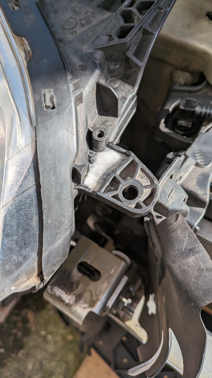

Dear colleagues,
when removing my front bumper I accidentaly broke away the bracket on my headlamp - the place in the picture, where the screw nr. 70 goes in. Any ideas, how to repair that? This part is unfortunately not available in the repair kits that are sold for the headlamps.
Thank you for any help!
Regards
Karel

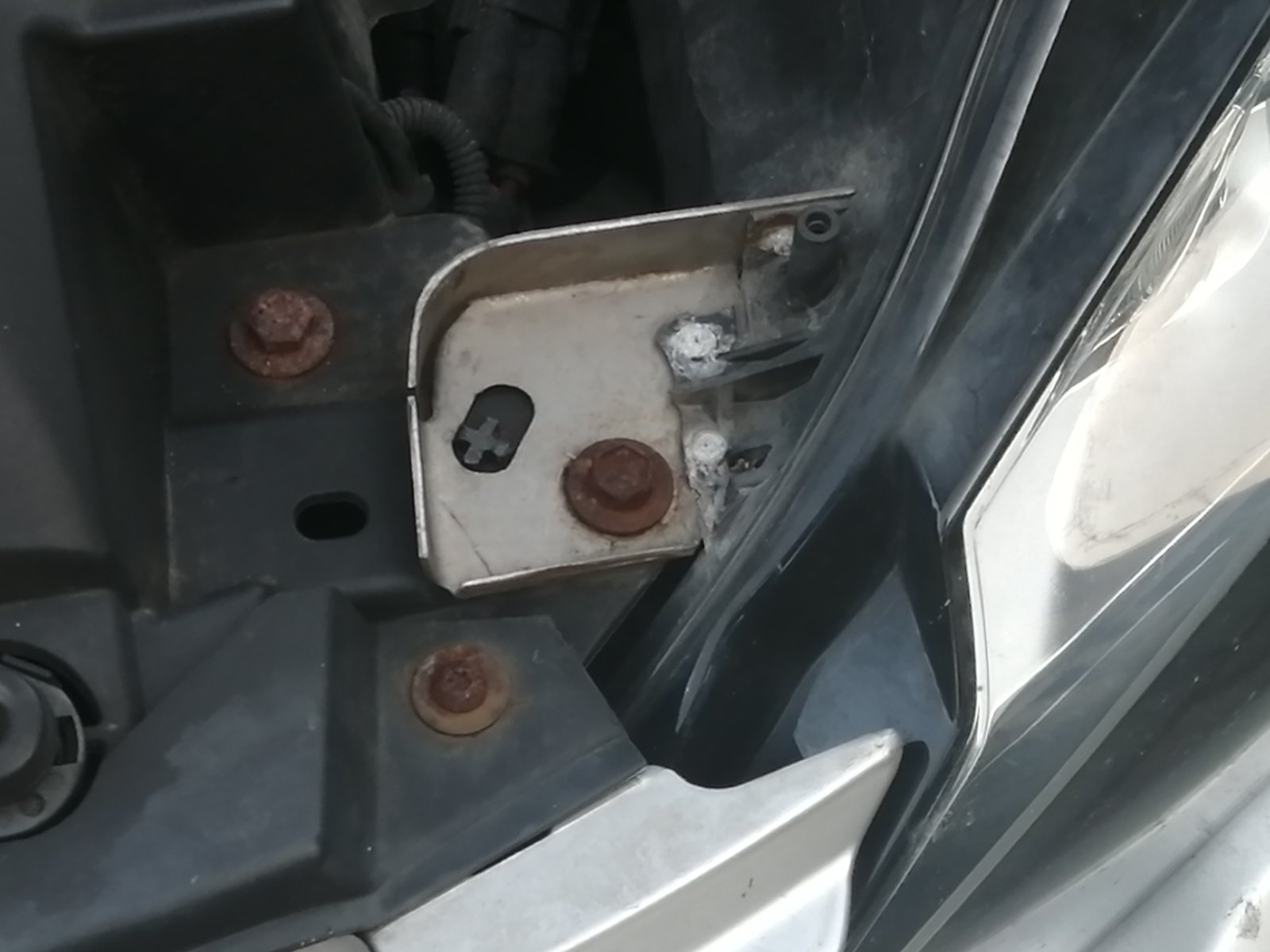

In a similar vein, this is the repair I did on the 308's headlight five years ago. The aluminium pop rivets are beginning to show their age now against the stainless steel repair but at the time I didn't want to use matching stainless pop rivets because of the greater force needed to pop them with the consequent risk of squashing the plastic.
I've checked the X7 headlight and the black plastic is polypropylene.

Dear colleagues,
thank you all for the constructive help! The polypropylene brackets on the headlamp housing can be successfully glued with a superglue/instant adhesive/cyanoacrylate. BUT only in combination with a PRIMER! I used Loctite 770. As a glue I took something from UHU with a filler https://www.uhu.de/de/produkt.7000518
Actually this is chemically similar to the hgpowerglue that was shown in the linked YT video above. Thoroughly clean the area before glueing.
After 3000 km still holds :-)
At the same time I reinforced the bracket on the other headlamp with the same glue and filler.
