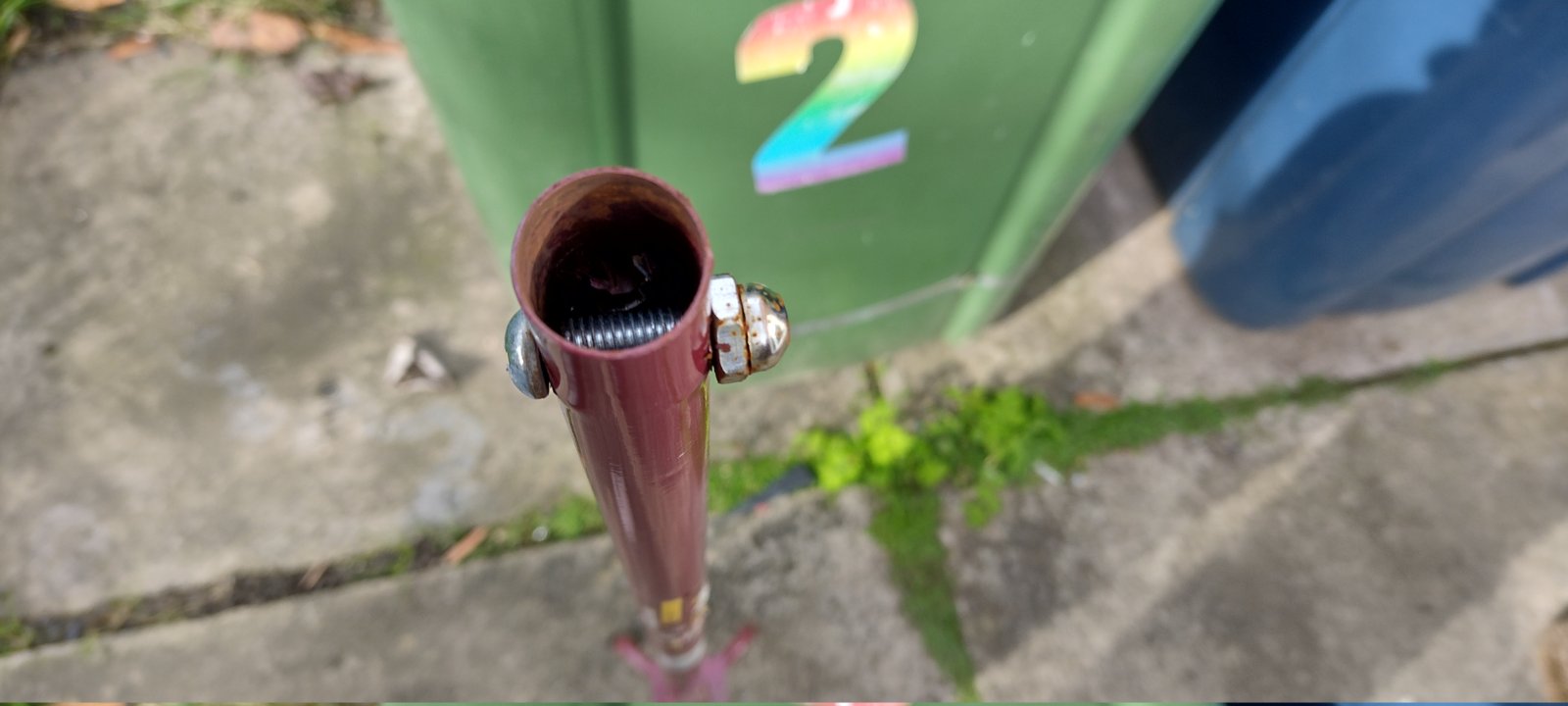

A recently purchased cultivator (thingy for churning soil up with).
It had a bit of slogger from new, the bolt securing the handle to the shaft was smaller than the holes it had to pass through. I knew it would fail eventually but not as soon as it has.
A bit of artisan bodging and we are back in business. A bit of some sort of tubing, perfectly stepped at one end to fit both inner and outer tubing, a chair leg rammed inside as a bit of additional strengthening, new correctly sized holes for the through bolt and a handful of self- drilling screws placed with random precision. Fixerizated as our American brethren would be likely to say.
Not pretty by any means and I will probably replace some or all of the screws with smaller through bolts.
Won't be keeping it outside any more as when I tipped it up half a pint of black and smelly water poured out.
The first photo's before the bodgering took place was to send to the seller for a bit of a moan and to demonstrate the inherent weakness of the design and construction.

Gosh that's terrible quality/ poor design on the cultivator/ manual rotovator! I'd be having a go at welding that back together, though looks very thin wall tube so perhaps an exercise in frustration.

That is far too industrial, mine is only needed in very small areas and that would be too much.
I did consider welding but don't have the necessary so would mean a trip to the car mechanics. Bodgery will suffice.
It is one of these:
It is one of these:
