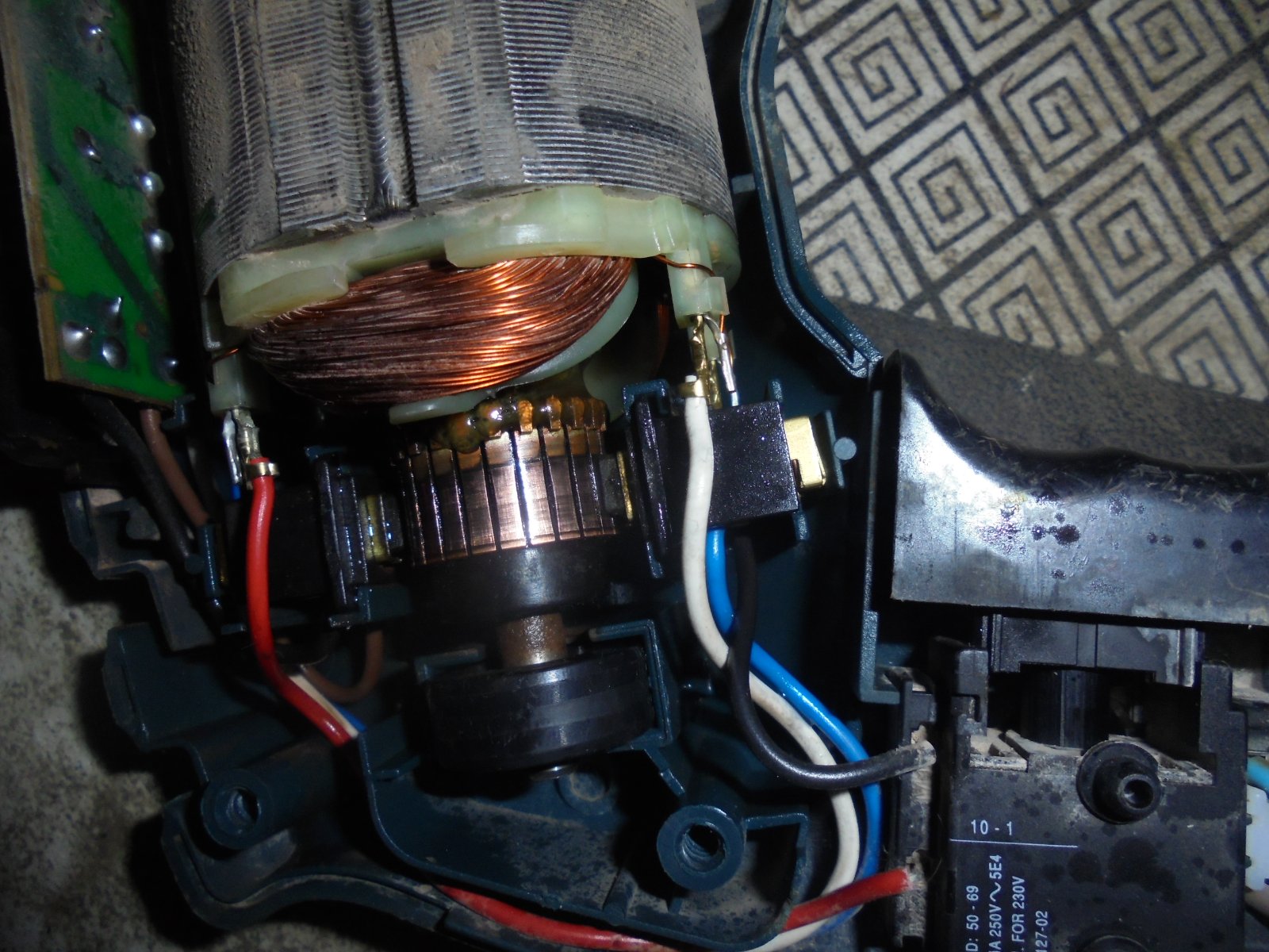

I think my black and decker of many years standing has finally thrown in the towel. Maybe not maybe just needs new brushes, but new brushes from B&D may well be more expensive than a new drill from LIDL. The brushes area is certainly where the popping and the lights show is coming from.
For the time being this has made a return to use after laying unloved and unused for some time. Neil

If it's been in use a long time, have you had the brushes out and see if they are just down to stumps?
I'd put the drill number in to eBay, being a household name I wouldn't be surprised if someone is knocking out equivalents

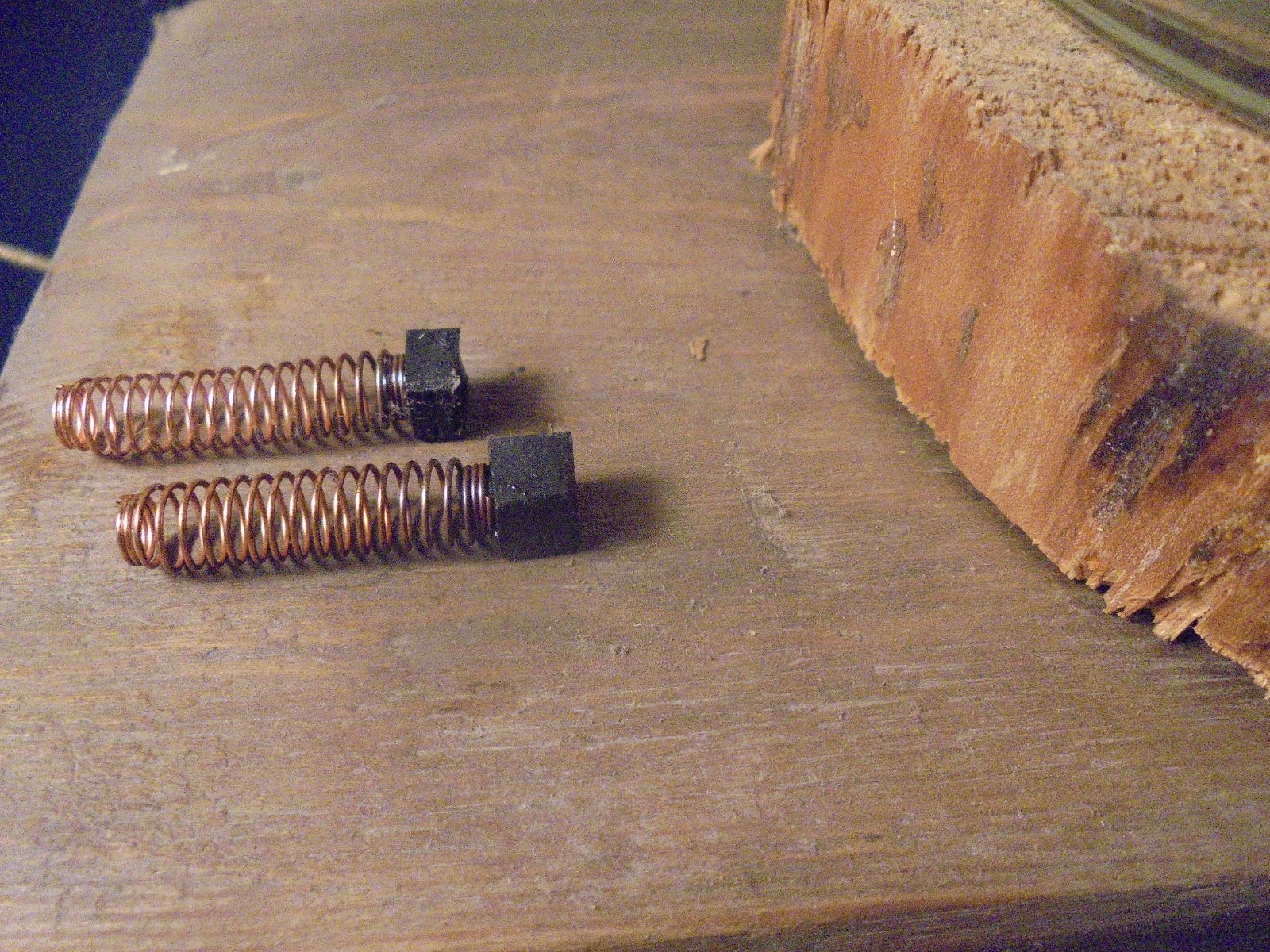

Here's the brushes....bit lopsided in their wear, but will new ones revive the drill? Not much money if equivalents can be found.MattBLancs wrote: 16 Oct 2023, 19:49 If it's been in use a long time, have you had the brushes out and see if they are just down to stumps?

Well they do look pretty worn! Normal seems like the spring is near coil bound with new brushes so would think they are 2/3 to 3/4 gone.
I'd measure the dimensions - cross section easy, length is obviously a best guess - as as myglaren says, can cut down over long replacements if needed. If can find some say less £5 then worth a gamble. Obviously a good clean up of the commutator as is very tarnished at present. Wet and dry, pretty fine grade for that.
It is worth noting that the fireworks could be one set of windings has gone short circuit though, it is likely game over if so.
Might be able to test this with a multimeter on resistance setting, put quite laborious given so many windings to check.
If it were me (and bear in mind am a cheapskate/keen in recycling!) I'd try the following in order:
Measure brush dimensions.
Check brushes slide freely up and down their guides (can be jammed with carbon muck - need to slide freely to make good contact)
Clean up the commutator with wet and dry
Try that and see if any better. If massive improvement then keep using the drill (and research brushes as lower priority task / forget about it until it conked out again)
If no better either price up brushes of suitable dimensions - if nothing cheap available then days are numbered for that drill as the brushes are pretty much gone.
If cheap then either first try the multimeter check of windings or else cross fingers and just try a new set of brushes and see what happens.

The clean up and rebuild using the same brushes had no effect specific fireworks at the brushes and a rapidly depositing layer of carbon on the commutator. Motor span to start with.
Did check the commutator with the multimeter, every "finger" showed continuity with every other finger without exception.
Wasn't as thorough as this didn't measure just put the meter on "beep" continuity test.
I think the problem is the brushes, the Drill ref is KR550RE dimensions 6.3x6.3x11mm

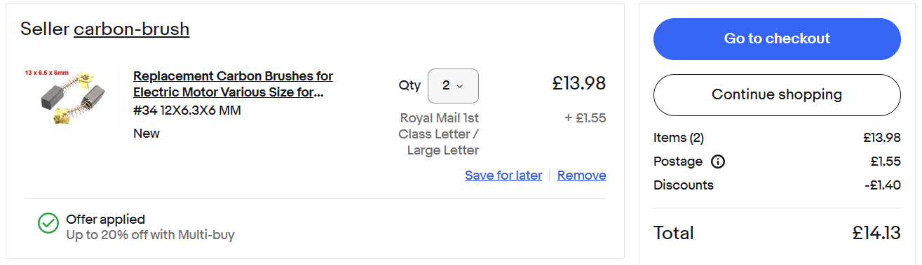

Thanks Matt...closest from that seller 12mmx6.3x6 more expensive than the landing page selection.MattBLancs wrote: 17 Oct 2023, 12:41 A quick trawl:
https://www.ebay.co.uk/itm/125364741626
£3.99 free p&p![]()

Many thanks for all the the searches Matt. I will have to give one of them a go at those prices, and see if I can resurrect the old Black and Decker.MattBLancs wrote: 17 Oct 2023, 21:45 https://www.ezee-fix.co.uk/shop/carbon- ... blck-deck/
£1.88 / pair, £2.48 delivery
A late entry takes the "cheapest size match spot" there!![]()
