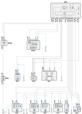

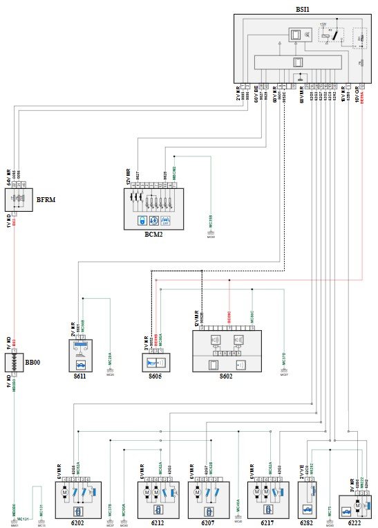

wheeler
- Posts: 7931
- Joined: 21 Sep 2002, 19:07
- x 1055
JOE+TECH
- Posts: 47
- Joined: 21 May 2023, 21:10
- x 4
Re: ALARM FAULT
Thanks Wheeler for diagram information ,I think I will be able to check it out now
It is a exterior fault When rechecked it had fault with no communication with siren module so with your diagram I was
able to check the power supply fuse No 9 5amp in bsi all ok .I will have to get to the siren wiring to check further
I see all the exterior , doors bonnet , rear hatch goes to BSI, Can the parameter list show if doors are showing open / closed correctly

wheeler
- Posts: 7931
- x 1055
Re: ALARM FAULT
Yes you should be able to see all the alarm inputs on the live data

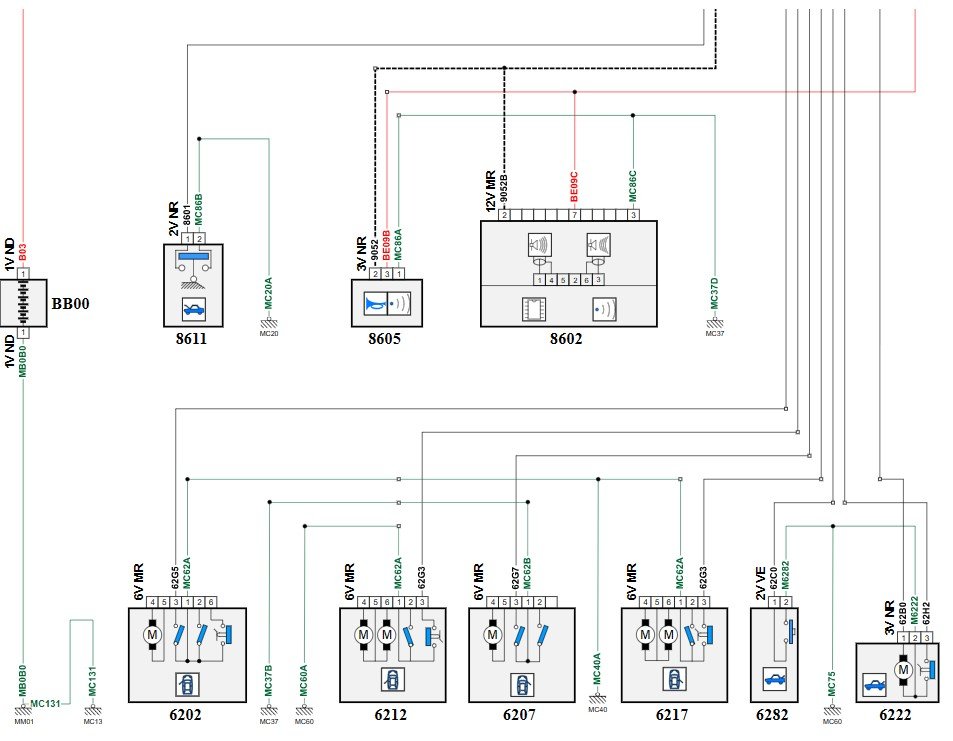

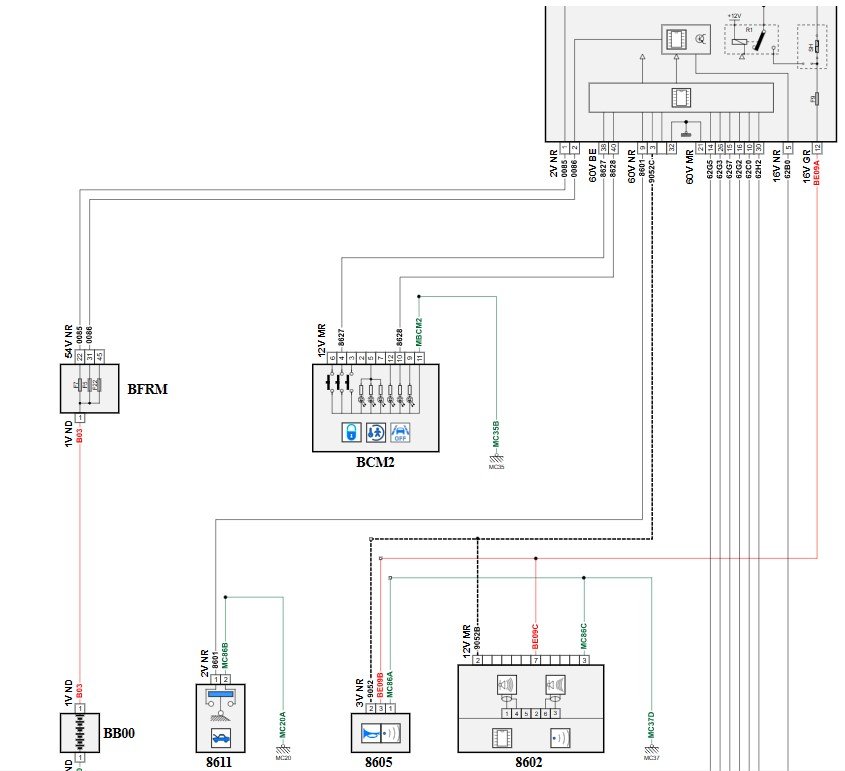

Re: ALARM FAULT
Hi checked siren it is new, earth ok pin 1( yellow) wire , pin2 ( grey) wire .o2 volts from bsi is that the comms from bsi pin3 ( pink wire)
No power to siren ,checked fuse 9 bsi batt power ok to supply siren on diagram
Now can you assist with location of plug 16 V GR on bsi where power should be supplied to siren
does 16 v gr mean 16pin grey plug and it should bee pin 12 on diagram
A diagram of the plug location on bsi would be great help
also what should I be expecting on pin2
wheeler
- Posts: 7931
- x 1055
Re: ALARM FAULT
Yes that is correct, the power supply to the siren (and also the alarm ECU) output from pin 12 of the 16 way grey connector on the BSI.JOE+TECH wrote: 17 Oct 2023, 21:50 does 16 v gr mean 16pin grey plug and it should bee pin 12 on diagram
There will only be one 16 way grey connector on the BSI so it wont be hard to find.
