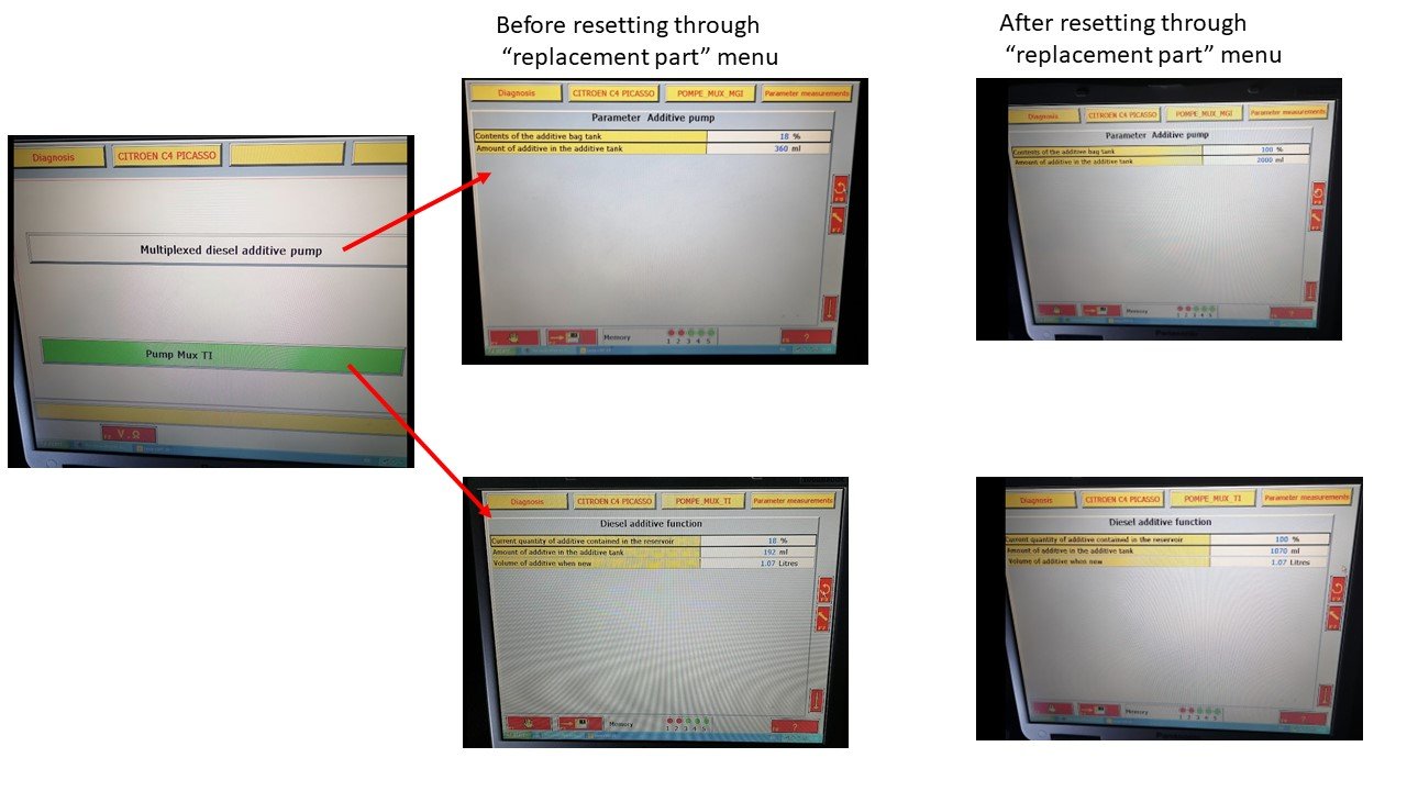

Thanks for all the help on this I have got some more "one last questions" - sorry....
I have been into the Lexia tool and founds 2 pumps / reservoirs related to DPF additive and inadvertently reset both of them.
I have successfully got rid of the warning message fault code too.
Plan to refill on the weekend, or at least get the tank off to confirm what to put in it.. (powerflex hopefully)
(However the Lexia is describing an additive bag tank.)
I attach a picture of the before and after resetting the volumes on both pump/tanks . (DPF additive repalcement on Lexia v0.02.jpg) Does anyone know why there are 2 pumps/tanks described here?
Have I reset 2 different tanks? If so what is the other one? (do I need to top up something else now I have told it I refilled it !!!)
As always so grateful for all the help here...
Richard

No idea, I always use Diagbox not Lexia, it's probably the same thing, or one of them is the integrated part in the Engine ECU. Anyway, as long as the light has gone off, it's all good!!

I've heard of this on several other models - probably specific to this engine, where there are 2 places that the reset needs to be done - in the engine ECU and the pack repair option and only after it has been reset in both places does it accept it.richarda wrote: 11 Oct 2023, 14:10 Thanks for all the help on this I have got some more "one last questions" - sorry....
Richard

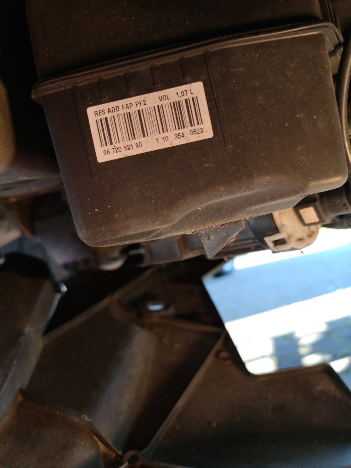

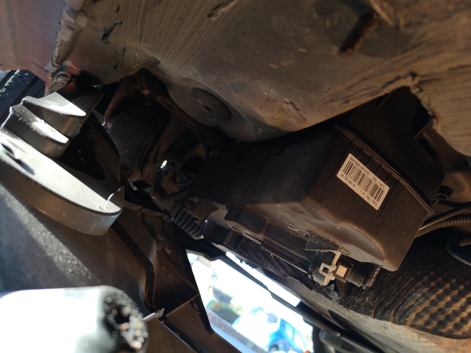

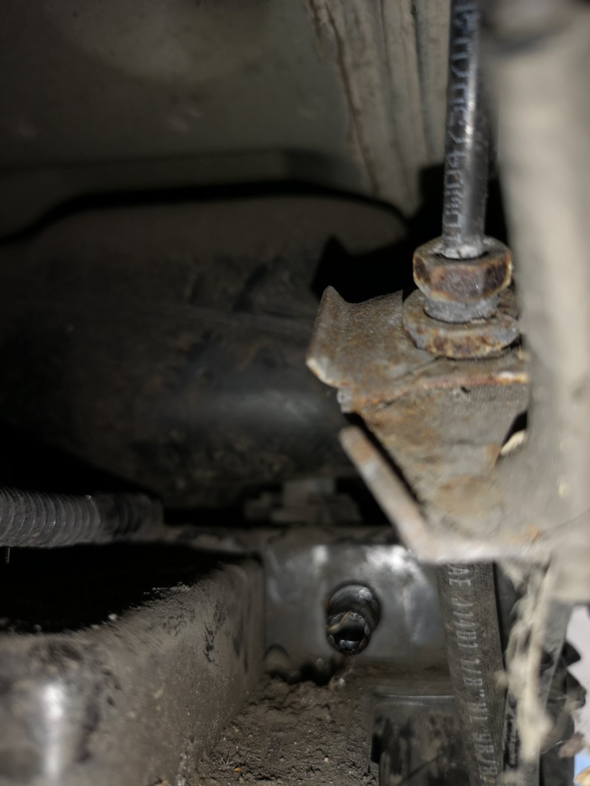

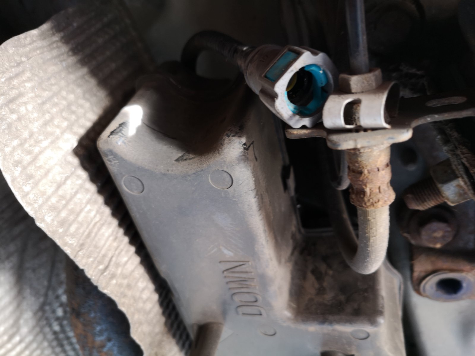

Hi There
Managed to get the cover off this morning, bar code sticker shows RES ADD FAP PF2 VOL 1.07 L.
The tank cover shows TI Automotive - that matches up with one of the "pompes" on the Lexia tool, indeed the 1.07L one and not the 2L MGI one.
I also managed to decouple the filler hose without removing the tank.
So will refill with PowerFlex fluid as suggested.
I add some pictures for your pleasure...and for anyone else with this problem...
Again always grateful for the help on this.
Richard
