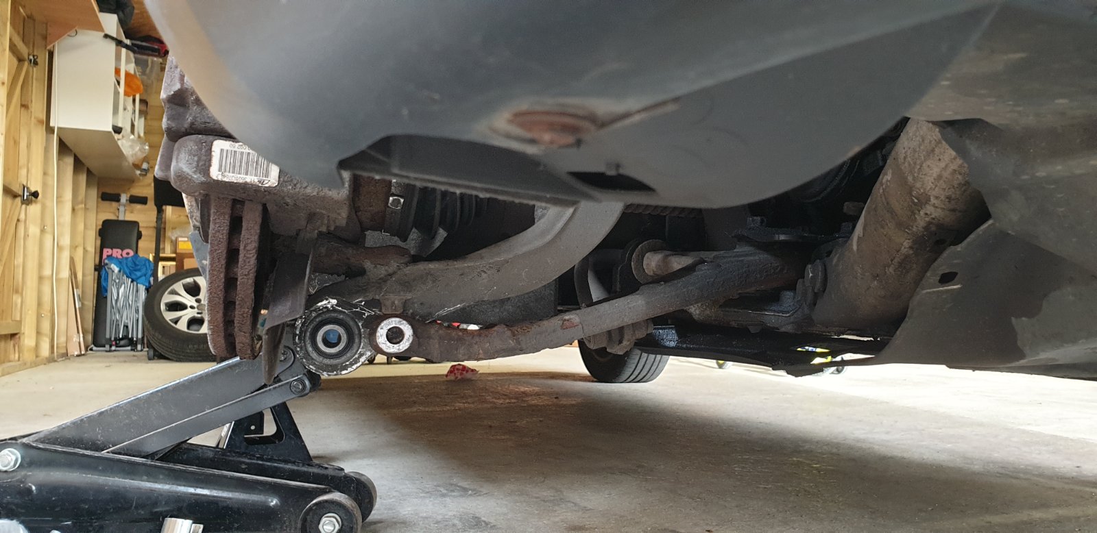

I was all smug this afternoon, when I successfully replaced the lower arm bush on the passenger side.
But then I moved on to the drivers side, and I have replaced the Bush, but cannot get the arm and hub carrier holes to line back up... they just won't go back in!
It almost feels like a solid resistance of some kind, and the sodding thing won't go inwards, just up and down. Tried with a crowbar, and tapped hub end with a hammer. It won't go back in...

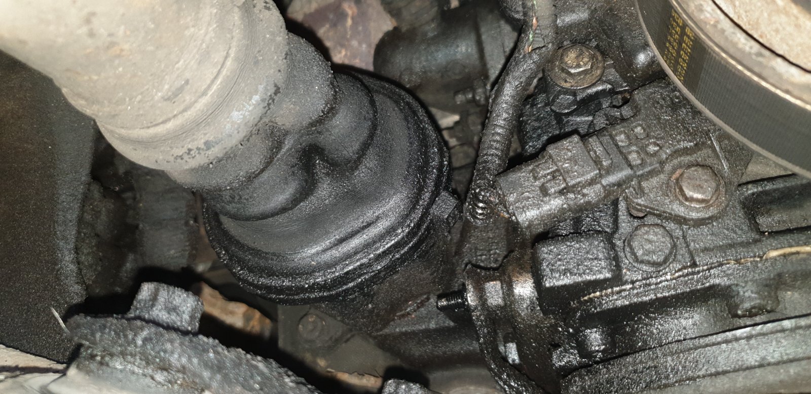

The CV joint looks OK from the outside, but I did wonder if the driveshaft had pulled out. Must come out very easily.

Judging by how the gaiter bellows have expanded to just about their fullest extent and the look of it, I'd say there is a likelihood it's come apart... Compare with its partner on the other side...
You should be able to pop it back in with a bit of fiddling... You may need a helper to take the weight of the suspension whilst you jiggle it back into place.
Worst case, one of the rollers may have come detached from the tripod and split its needle rollers. You'll then need to remove the shaft, slip the gaiter off and reassemble it on the bench... Let's hope that hasn't happened...

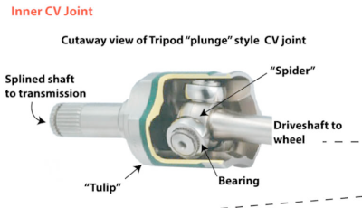

Its possible that the spider has pulled out of the tulip. best bet is to remove the large gaiter clip and have a look inside. be very careful, if the bearing covers come off you will have needle rollers everywhere.

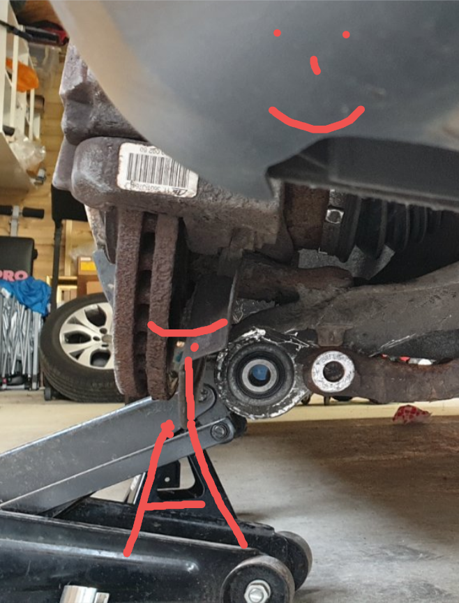

I hope you have more support under there than just that jack.

Gibbo2286 wrote: 07 Oct 2023, 19:00 I hope you have more support under there than just that jack.
THIS
Yes two axel stands

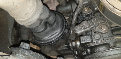

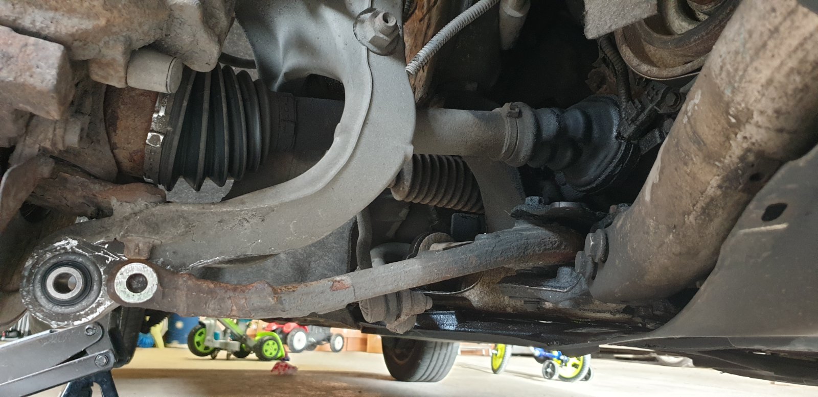

I agree the inner CV boot looks taught so could be the source of your struggles.
As others have said 35mm sockets size but more commonly available 36mm can be used. Halfords certainly used to stock the 36 (but not a 35)

p.s. thinks I'd win a game of Axle Stand Hide and Seek!

Also I'm amazed that CV could have pulled out, seems very much more keen to pop out the gearbox and give a puddle of gearbox oil in my experience!
