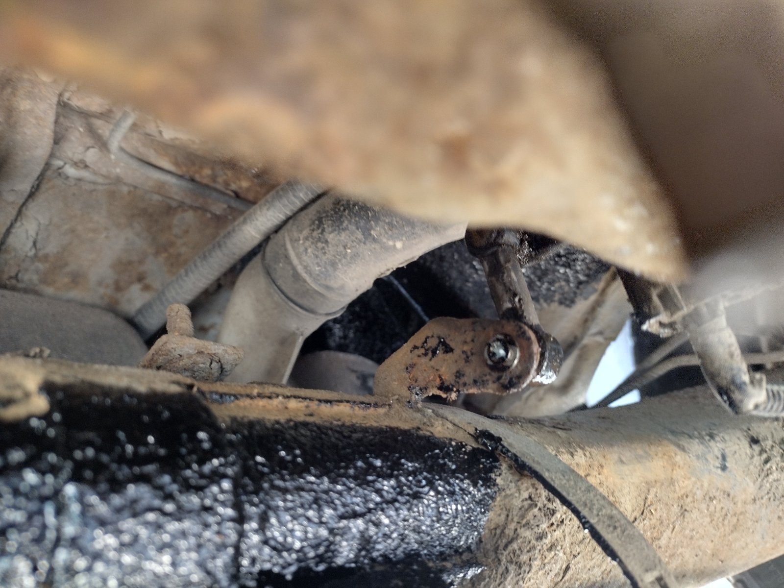

Computer points the finger at the rear sensor. A look underneath confirms....
The link is MIA
Not available separately and the sensor is over £200 and I can't easily find one so it would have to be Pug. Given the price, there must be scope for having a go at making a link first!!

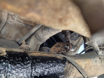

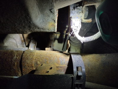

Got it on the ramps today. In fact the link is still there, the top joint has seized up causing the bottom plastic fitting to break off the suspension cross beam. However, I've seen some daft things in my time, but this is well up there. The sensor, in a pretty exposed position under the car, is fitted with PHILLIPS screws FFS, and the bracket is riveted to the car. Needless to say the bottom screw is a rusty blob, so the sensor is not easily coming out. Not even sure how I would get it off, there isn't room to get in to drill them out, so I think would just have to smash it. Anyway there was enough pin left on the bottom, and I got the top joint freed up, so it's wired back on. Will see if it stays - it's only temporary - unless it works!!
Recommend that anybody who's got these gets some lube on the ball joints!!

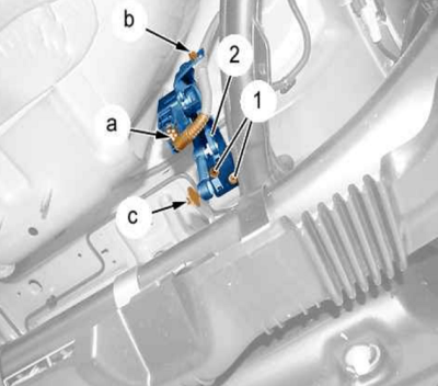

Rivets? That's daft and it seems they expect it to be re-rivetted when removed too:
The bracket (3) has to be in contact with the crossmember (as "d").
You're probably aware, but watch out if removing it Richard, as they say the headlights need a headlight calibration performed after replacement of a height sensor or control unit, and after any operation on the suspension necessitating the uncoupling of the link rod or the removal of the sensor.

It's other bracket that the sensor mounts to which is riveted to the car above the cross member, no room to drill the rivets out.

I think it's to do with the self-check to make sure it's within tolerances after removing any part of the rod or sensor.
Disconnect the connector "/" (as "a").
Unclip the electrical harness (as "b").
Unclip the link (as "c").
Drill the 2 rivets (1).
Remove the sensor (2).

Ah yes, looking at the parts dia it comes with the bracket. Gawd knows how you are supposed to drill the rivets out above the rear axle....

Temp repair mark 1 lasted 18 months - joint had gone stiff again and broken the wire off. Freed up again, wired it back on, and liberally greased it, perhaps will get 2 years this time!

Nope
Realised that there was actually a hole in the end of the ball joint bit, so managed to get a screw in it this time. Looking pretty crispy in places under the back, so scraped some bits back and put some undersal on, should get an MOT this year, but next might be a stretch....
