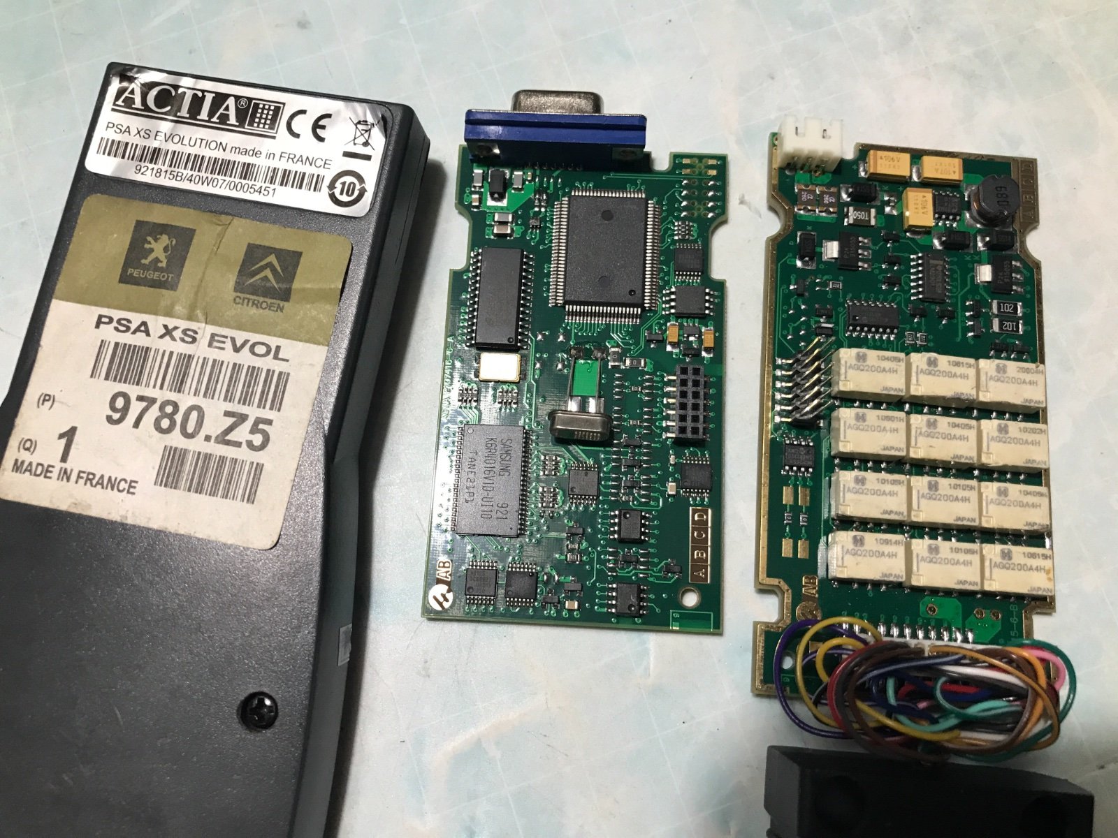

If it helps anyone to make sense of this, my unit has 9780.Z5 on a bar coded paper label and marked on the body in black ink. On a silver label with the CE mark on it it has the designation 921815B/40W07/0005451
Posts: 42019
x 6955
Re: Normal Lexia behaviour with C5?
No problem, have a look on my post here with the picture showing the location:
viewtopic.php?f=51&t=59785&hilit=10k+resistor#p570919
Note: to see the area in close up, click the same image a few posts up on that link without the arrow that I copied to superimpose an arrow on to show Gibbo where the resistor was. It will zoom up significantly on that picture.
That serial number (921815B) indicates it is a revision 'B' unit, which is the older kit. Could be another reason for the communications problems.

I fitted the missing 10K resistor to the interface unit.
I didn't see any change in the way the interface communicated with the car. Comms with the Module Below Steering Wheel still had a "?" for its status - so much for the missing 10K resistor fix.

There is no guarantee that the 10k resistor will provide the fix - it is not something I would of bothered with as there are plenty of other components missing in the non full-chip kits and as I've mentioned on other threads, there are just too many variables to factor in when determining faults with the clone devices.
Personally I would get a new full chip unit (there is a discount code for members from Easydiagnostics) if you look at the announcement section of the Diagnostics section of this Forum.
The C5 is one such car that is known to have known communications problems with clone devices that are not full-chip kits. The annoying thing is the Chinese suppliers are still selling older clones with missing hardware - making out they are the bees knees, but if you see any thing for less than £100 be extremely suspicious about what you are getting. Some sellers do declare in the smallest of writing buries in the blurb that there are comms difficulties or that it won't work with the C5 and Peugeot 308 - but not all of them.
I'm sorry that you didn't get a fix, but it is just not a guarantee. You may have some of the Optocouplers missing and a few other parts required.

I bought my Lexia / diagbox set up quite some time ago thinking I had a good one, but after rational got the better of my ignorance I opened it.
Going on the photos and info here (thankyou GiveMeABreak):
viewtopic.php?f=51&tImage=59785&hilit=10k+resistor#p570919
I see that I’m missing the 10k restistor,
also a blue flux capacitor,
and a row of small monopoly house looking Nand/nor gate like circuits.
I’m handy with a soldering iron, but think it wise to ask if it is worth it? Or buy a new reputable one per some kind soles link please?🙏

If it was me, I wouldn't bother to be honest as there are other components including a different chip on the newer full chip kits.

Parts would cost more than a new unit, I bought mine from eBay and works so far but I can't guarantee it's not a fake. There is a supplier on here whose some what recommend, Easy diagnostics
