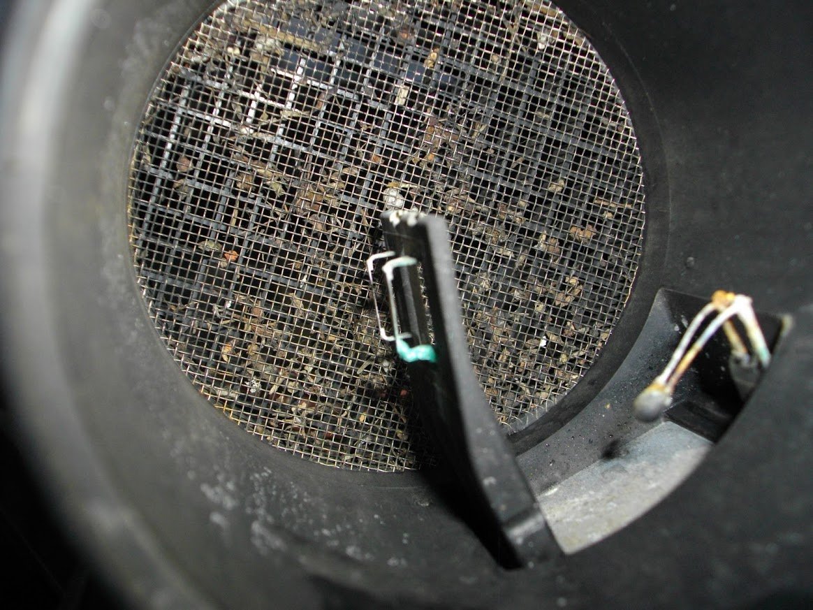

It took me a week or so to spot this, and than many more weeks to finally give up trying to work out which safe place I put my Lexia in. This morning, I speculatively unplugged the MAF, expecting the car not to run. And it's TRANSFORMED. Seems to run perfectly and climbs hills with ease.Huskyxantia wrote: 30 Aug 2023, 14:36 I may of solved your issue check the element inside the maf sensor ... is there one or has it burnt out.
I suspect it's running a bit rich, but not sure. I don't really understand how it's running at all without the sensor.
Anyway, I shall now go and source a replacement. Thank you! (I'm kicking myself for not trying this months ago - but it was giving a reading which looked rational with Lexia, so I thought it was working.)

If the MAF is unplugged the ECU goes into default mode. As you have discovered a quick and easy test to see if the MAF is functioning correctly.
If you can access it you may be able to clean it. I used carburettor cleaner but ther is now a dedicated MAF cleaner (same thing I suspect).
Mine was ailing as the wheel arch liner had exploded and exposed the air + water, grit and leaves intake and made a mess of the MAF and filled the air filter with water and roadside crap.
A couple of squirts and it was OK. Don't touch the wires with anything other than the spray and don't drop or shock the MAF, they are exceptionally fragile.

It will revert back to default settings , not sure if it would pass an mot as the emissions will be slightly higher.tearing hair out wrote: 28 Sep 2023, 09:25It took me a week or so to spot this, and than many more weeks to finally give up trying to work out which safe place I put my Lexia in. This morning, I speculatively unplugged the MAF, expecting the car not to run. And it's TRANSFORMED. Seems to run perfectly and climbs hills with ease.Huskyxantia wrote: 30 Aug 2023, 14:36 I may of solved your issue check the element inside the maf sensor ... is there one or has it burnt out.

Wow that did need a clean .myglaren wrote: 28 Sep 2023, 10:10 If the MAF is unplugged the ECU goes into default mode. As you have discovered a quick and easy test to see if the MAF is functioning correctly.

Certainly did but worked OK for years after.

I'll take it off tonight and see if it looks cleanable (rather than just broken) - thanks.
