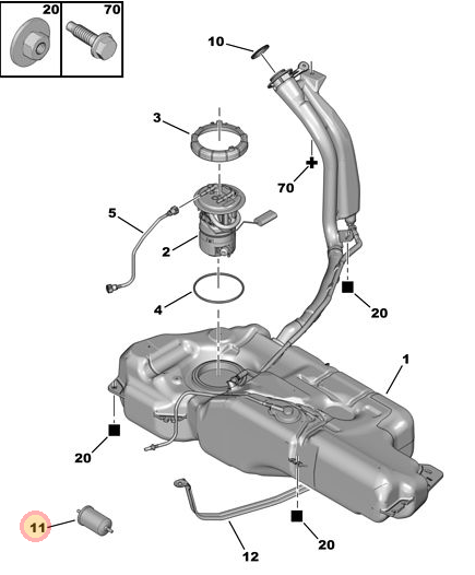

It turns out that it was a clogged fuel filter.

Is that the fuel filter near the tank? European market vehicles generally were not fitted with a fuel filter.
I wonder what it was clogged with?

Here Mike:

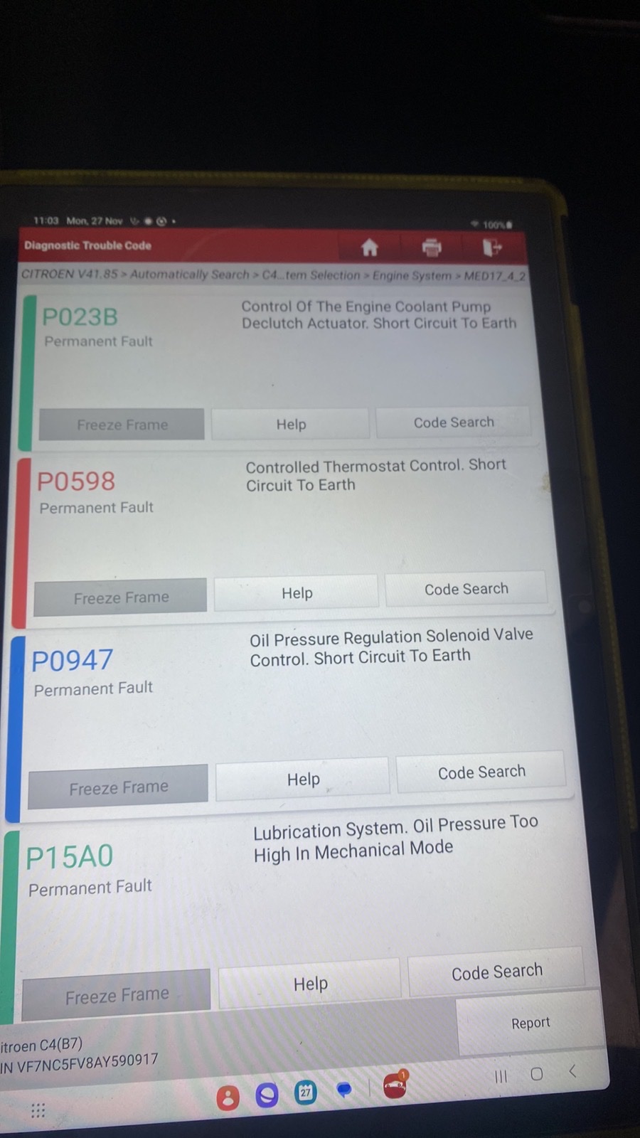

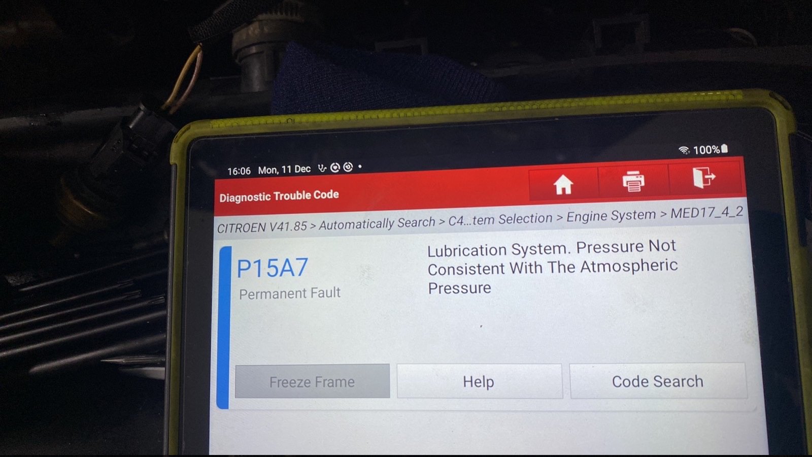

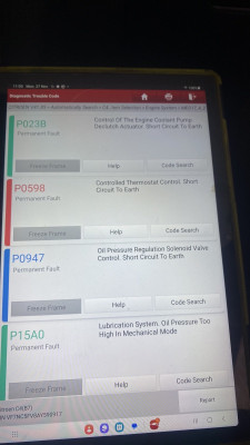

Hello, I need help, does anyone have the original software for Citroen c4 1.6 thp 156ps 2011
Can anyone help me
Can anyone help me
