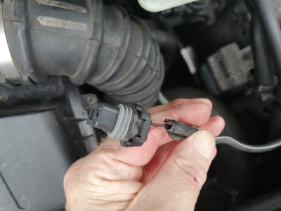

As I reached the end of the work I found that there was connector left over. It comes out of the loom going to the left hand headlamp but all four headlamp sockets are filled and, anyway, it's longer than those.
So what is it for? It seems to fit into a plastic clip on edge of the front panel and that's where I've left it doubled back to keep it from dropping down. The first photo shows it pulled out to full length and the second more detail of the plug end. Just two wires, red and black.
There is sign of verdigris so it may not be used on this model but I'd just like to know.

I'm open to guesses!

Just two wires would suggest spot lamp fog lamp or horn.

There is an unused connector as well for foglamps behind the LH wheelarch liner. Horn is connected and behind the bumper. This one is up top and is just so strange. My brother reckons that it's for a sensor of some kind given the small size of the terminals.
The brake master cylinder looks pretty new and I wonder whether the old one had a switch to detect if one circuit fails. There's still a fluid level switch in the reservoir so it's not that.

Connect a bulb to it and see if any of the switches turn it on.

Good thinking. I was in too much of a hurry to finish the main job to do much investigation band daughter was champing at the bit to drive down to Glastonbury. If I get some with it when she gets back I'll investigate further.

Did you ever find out, exactly the same scenario but have this spare slightly corroded on 1 pin 2 wire connector hanging spare of the near side front light loom.

No I didn't. And nothing that worked previously had stopped working either. I came to the conclusion that it was a spare connector for something on another engine or trim.

Cheers for replying. noticed theres another one thats clipped to the side bulkhead (4 wires I think) that had nothing connected either but weird this one is just hanging about with a detached clip on it. I'll just clip it up somewhere
I had a sensor reading when scanning ODB port from AIT (°C) -40 (minus) so wondered if there was a air temp sensor missing somewhere in the bumper like others have said. maybe from a previous botched repair attempt.

Hi. I was searching the net for the same loosely hanging connector today and that brought me here. I've been told it's a connector to the hood open sensor / switch, and if you don't have a car alarm (I don't), it can be left unconnected.
