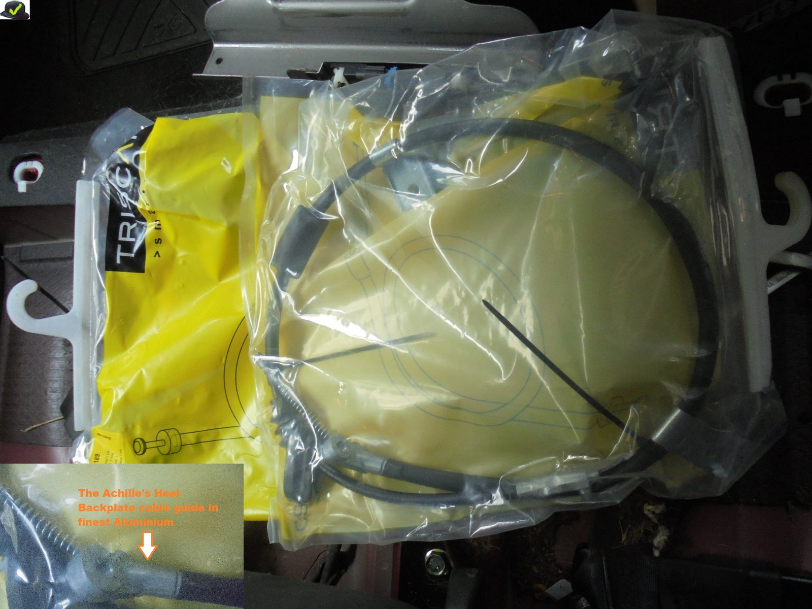

Cleevely have got the Falcon Business and while not having investigated whether the nearside parking brake cable is needed I have gone ahead and just ordered both nearside and offside cables. Even if the nearside is not strictly needed at the moment, it will be shortly!
The offside one is functional and not beyond the possibility of bodging a makeshift back-plate cable entry clamp, but far better to have a new cable altogether now that one has been sourced at not too outrageous a price.

NewcastleFalcon wrote: 08 Sep 2023, 10:32 Cleevely have got the Falcon Business and while not having investigated whether the nearside parking brake cable is needed I have gone ahead and just ordered both nearside and offside cables. Even if the nearside is not strictly needed at the moment, it will be shortly!
Wise move by the Falcon there...the nearside is strictly needed right now. Exactly the same as the offside, perfectly serviceable cable seized rock solid to the backplate aluminium cable guide with with corrosion.
Cleevely have processed the order, so a bit of a break until the package arrives.

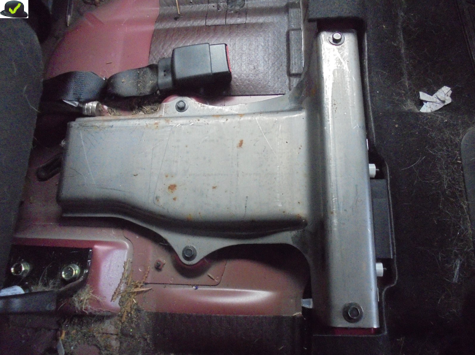

The parking brake replacement job-Nissan Leaf The start
Steveev My Nissan Leaf https://www.speakev.com/threads/nissan- ... st-3327895

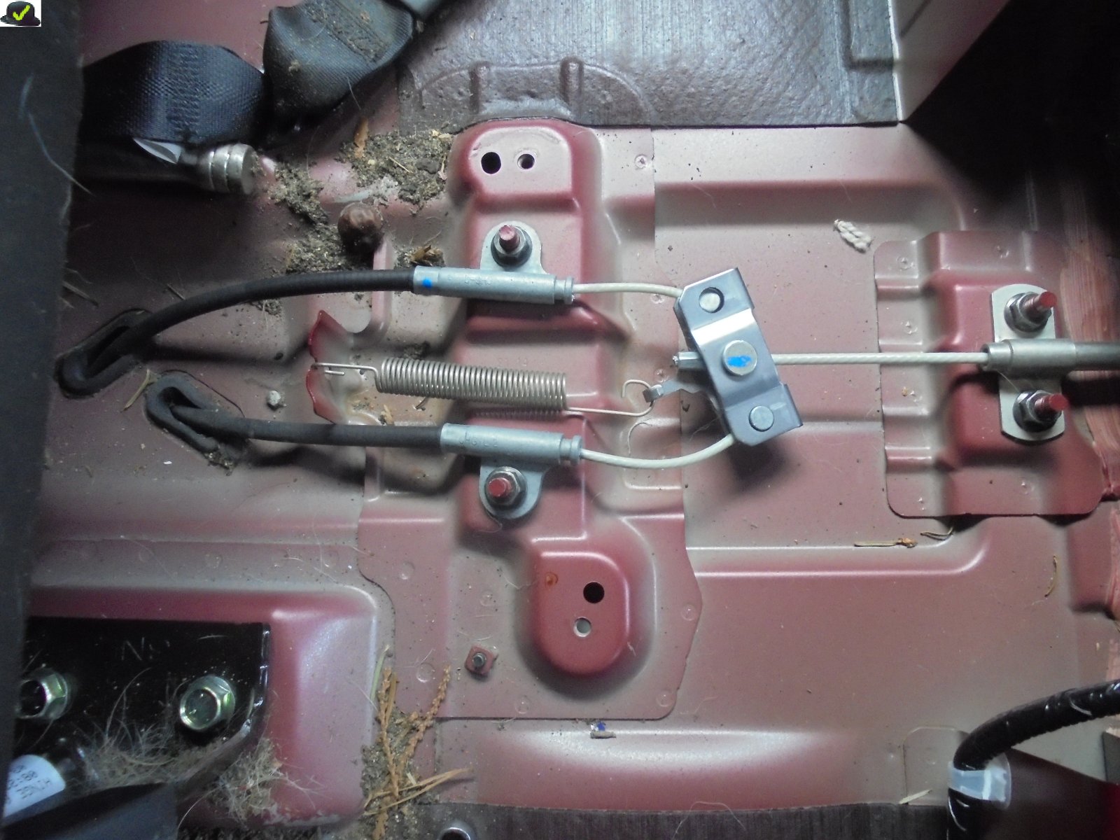

The "interior disassembly" amounts to pulling up on the rear seat squab. The rear seat squab just requires a decent forceful yank upwards, not attached by any screws front or back, and removal reveals this picture...
Undo four bolts to remove the cover plate under which is the handbrake cable joint between the single cable to the front and the two rears - one to each wheel.
