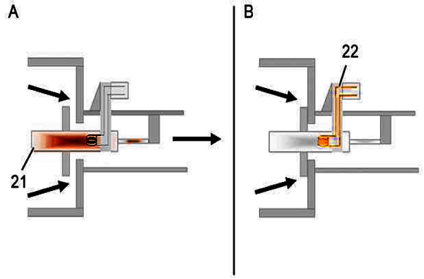

(i) Do you know what the function of the 'Pilot' is included in the thermostat? ( My Haynes repair manual omits to explain this unit)
I'm attempting to trace a possible electrical fault to this component, (not the component itself as I've replaced the whole thermostat complete)!

EP3 and EP6 engines are equipped with a 2-speed cooling fan.
The engine cooling fan is triggered in relation to the coolant temperature and the control of the piloted thermostat.
At the low controlled thermostat regulation setting (below 90°C), fan engages at low speed at an engine temperature of 97°C and at high speed at an engine temperature of 108°C. The trigger thresholds of the fan are spaced for the upper regulation settings of the controlled thermostat.
The piloted thermostat permits:
"B": Thermostat closed.
(21) Wax.
(22) heated resistor.
The wax (21) contained in the controlled thermostat melts at a temperature of 105°C.
During normal operation, the thermostat is not piloted, it regulates the coolant temperature at 105°C.
The regulation of the controlled thermostat is controlled by an RCO signal from 75°C (100% control) to 105°C (0% control) depending on the requirements of the thermal engine.
If 100% is required, the engine management ECU controls the controlled thermostat heated resistor (22) to add the 30 °C which are lacking to the 75 °C of the coolant to melt the wax (21).
Piloted thermostat operating phase
The operation of the piloted thermostat is also determined as a function of the following parameters:
- The engine temperature to rise more rapidly for better control of the exhaust gas depollution
- A higher engine temperature for reduced friction and therefore improved fuel consumption
(21) Wax.

- Controls the thermostat at a low threshold
- Limits the exhaust temperatures
- Controls the activation of the additional fan
- To control the lighting of the stop warning lamp on the instrument panel

Re: DTC P0011; P11A9 Peugeot 1.6Lt VTi petrol
Wow Marc,
The above explanation has taken my understanding of the cooling system to a 'whole new level'!
* My next step is to solve why there's not 12V flowing to the VVT solenoid valves (Intake & Exhaust) - as per this 'You Tube' video:
* Any further guidance will be greatly appreciated.
Thank you so much for your interest and help.
Loftie+1
Loftie+1
- x 6954
I think the video should help you determine if the solenoid is faulty or not.
