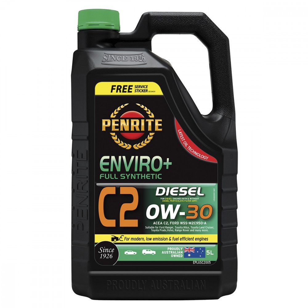

Those of us living in the southern hemisphere can get some odd packaging as Total isn't readily available.
- Posts: 42019
- x 6955
Re: Engine oil 3008 MK1 1.6 petrol
So this is a good example where 'Australia' is classified by PSA as a 'Very Arduous Country', so the OPs vehicle in this case would be recommended to use 5W30 Oil that conforms to the B71 2297 specification.
It's not so much a Brand, but the specifications it meets and the Country of operation (temperature, dust and other conditions etc.)
