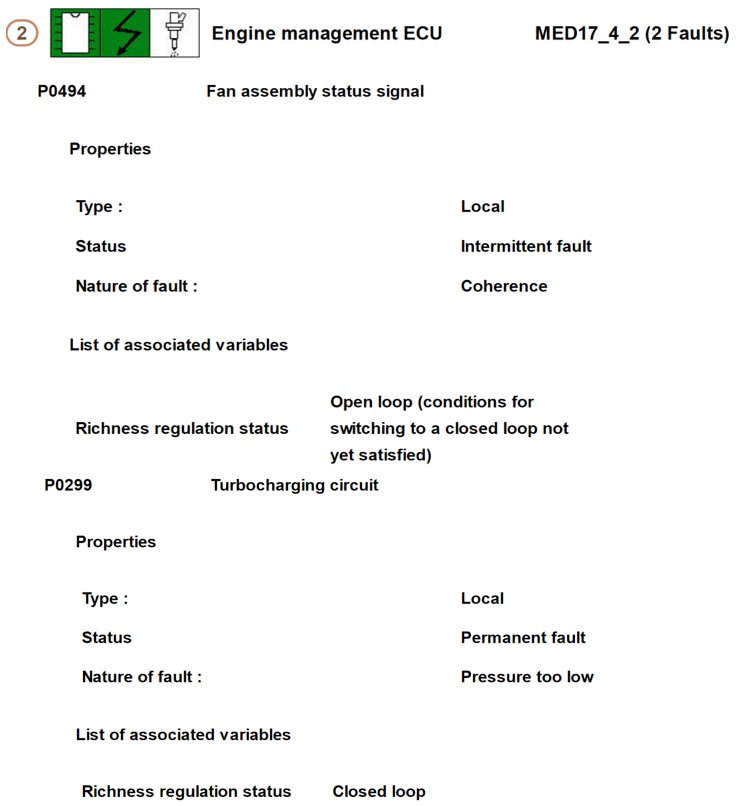

Peugeot 508 SW VF3**************[VIN obfuscated, can be read by forum staff] 2012. 252.000Km 1.6 thp 115KW
When driving, check engine started, engine showed lack of power.
Diagnostics showed errors P0494 and P0299 .
When the errors are eliminated, the engine runs normally, until it turns them on again while driving.
Does anyone have any idea what is going on and if these errors are related to each other or is it a coincidence.
I appreciate every reply.
