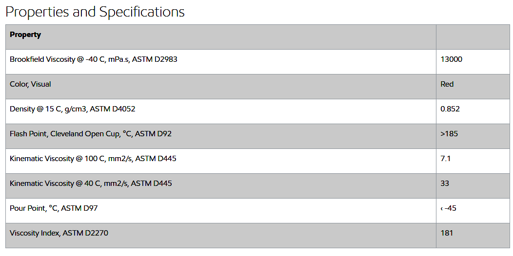

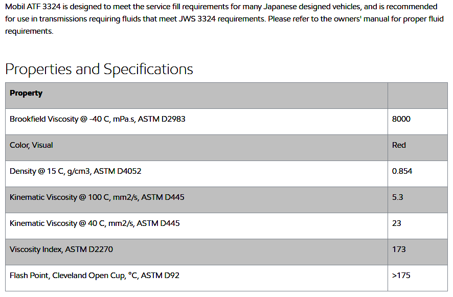

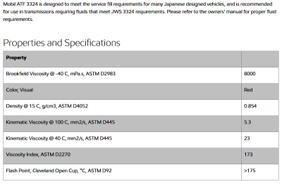

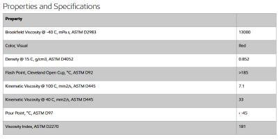

As you can see the 2 oil types have significantly different viscosities and other properties:
Click Images to Zoom
JWS 3324 (Euro 5)
JWS 3309 (Euro 4) Later EAT 8 Speed Gearboxes use AW2.
JWS 3324 (Euro 5)

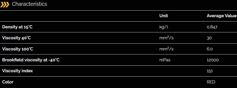

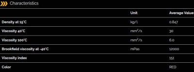

Re: Gearbox Oil reset counter
This is the specs of the oil i used.I think and hope is in spec for AW-1 that my car requires.Most oils state that "do everything". Must be very careful.
