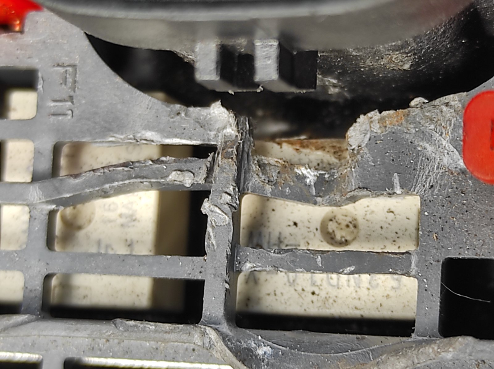

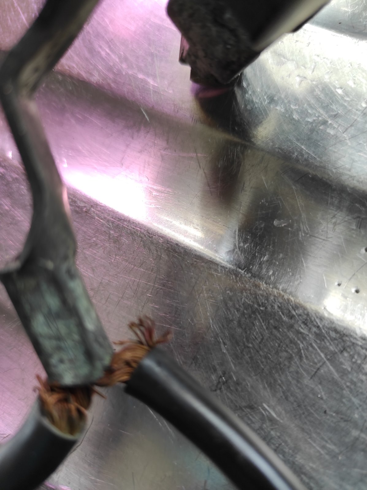

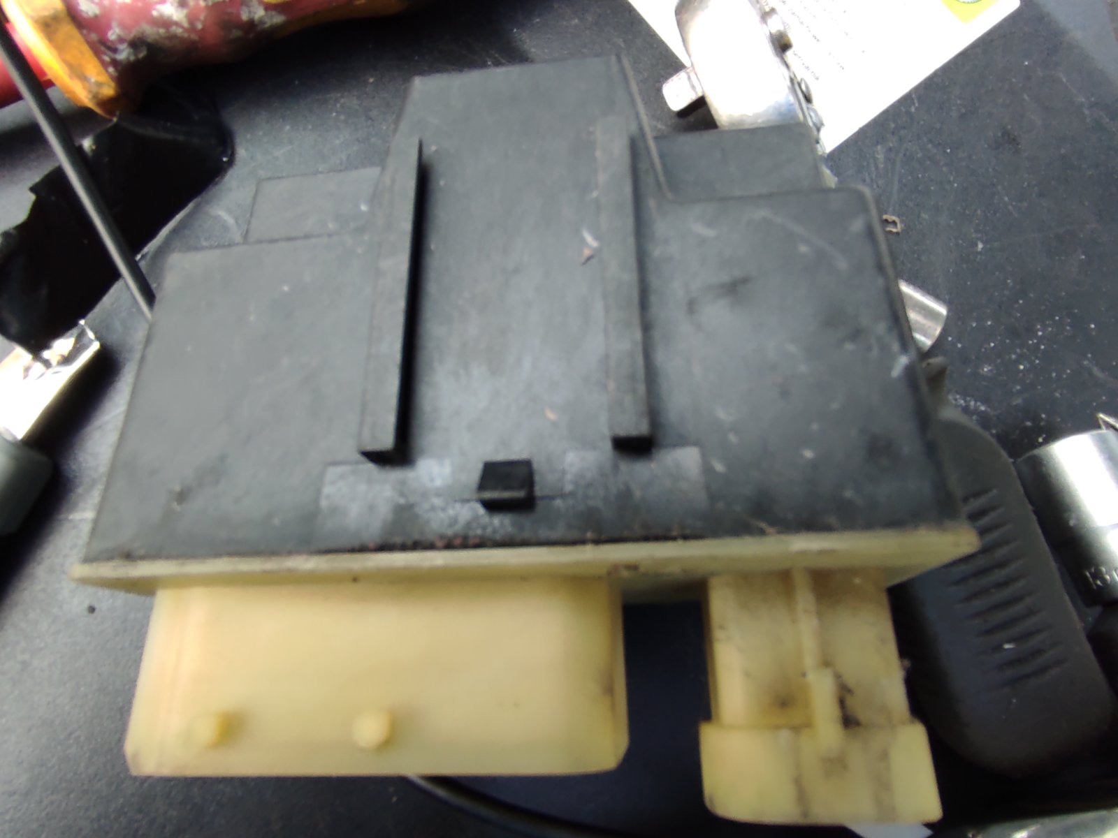

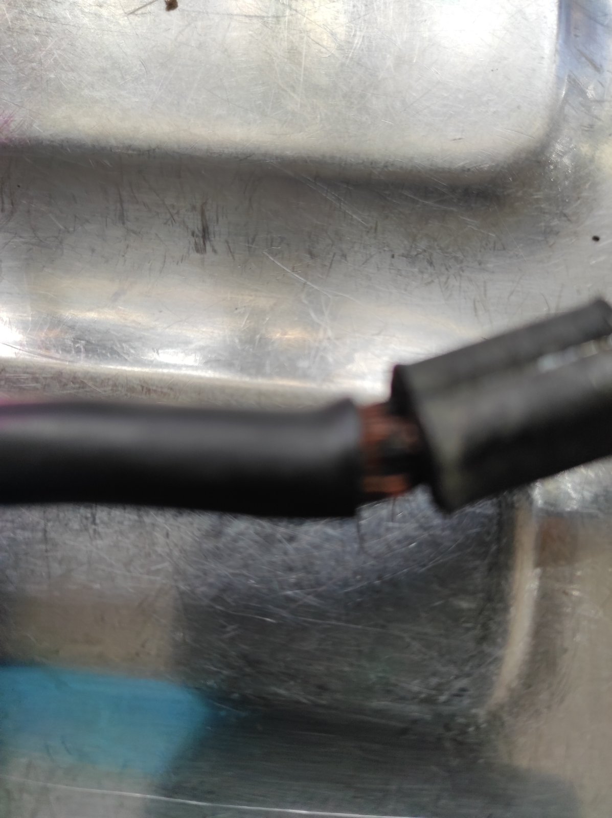

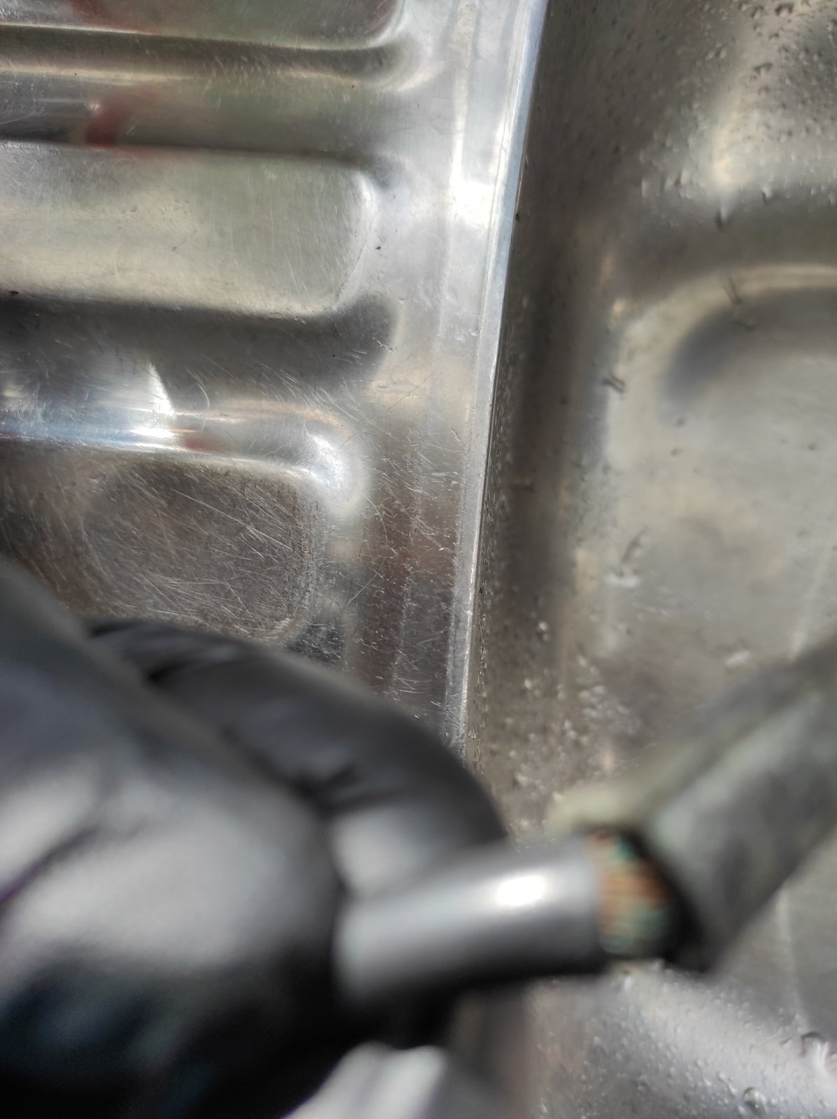

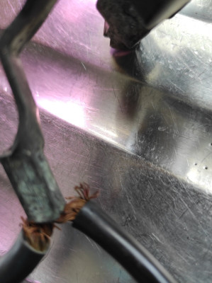

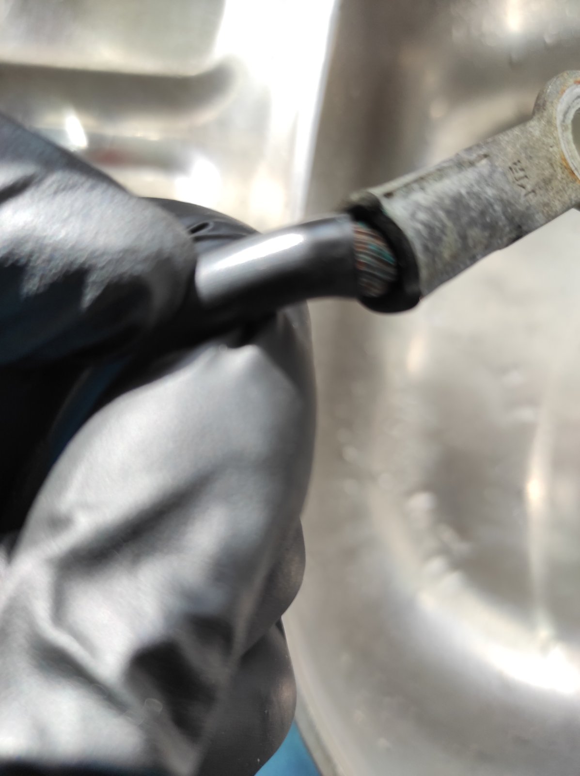

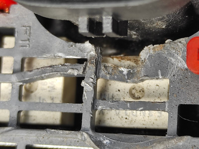

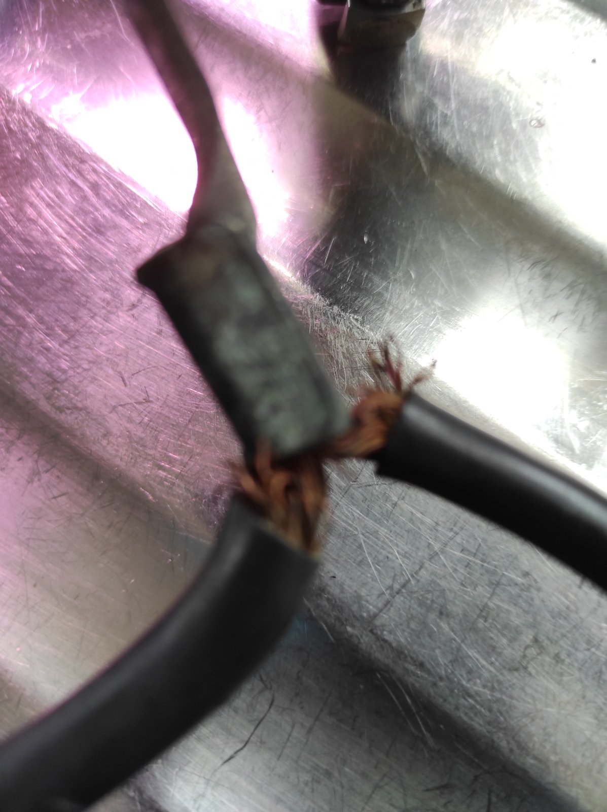

I have taken a few pictures of the questionable cable as you can see it is badly frayed. EDIT I am also wondering what the small rectangular unit is. The fuse board has a relay with a chunk out of the top of it would this affect anything I can't remove it to test it as it is a sealed unit. I don't know whether it was me who damaged it or not. I also got a picture of something a bit different.

My mate said that it is most likely an earthing fault at the ECU or somewhere between.
darbuck
- Posts: 1612
- Joined: 25 May 2014, 16:45
- x 289
Re: P1210 fuel pressure regulator fault
That's what I am thinking myself at this stage, the exhaust temperature sensor is high voltage possible cause bad earth. The regulator is showing open also a symptom of bad earth. Coolant temperature sensor reading negative but when I tested it it was good through the range. I think I can rule everything else out. I am convinced it's a bad earth I found a used good negative battery cable on fleabay for 20 EUR so when it arrives I will throw it in. For the sake of a score it's worth it. I can only assume that the only thing else it can be is either a bad earth or bad computer earth internally but because it is graphing and trying to control tells me it's an external earth to the module. It was the computer I think I would have more problems.

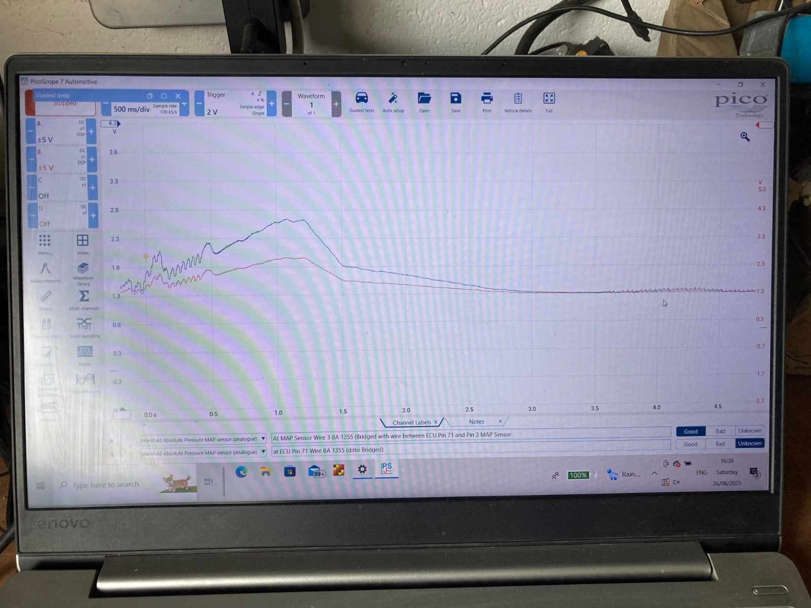

I’ve been scoping my MAP sensor today.
Scoped Pin 71 (MAP sensor signal wire at ECU) and Pin 3 (MAP sensor signal wire at MAP sensor) using 2 channels. They overlaid perfectly once I had back probed it properly.
I failed to do that at first and was getting variable results.
First picture is with bad back probing.
Second picture (I’ll need to upload when I am back up at my mate’s next week if I remember as I forgot to take a photo but I saved the data trace) has both channels overlaid and signal is identical. Red or blue trace appears depending on which channel I turned off.
A fun day.
