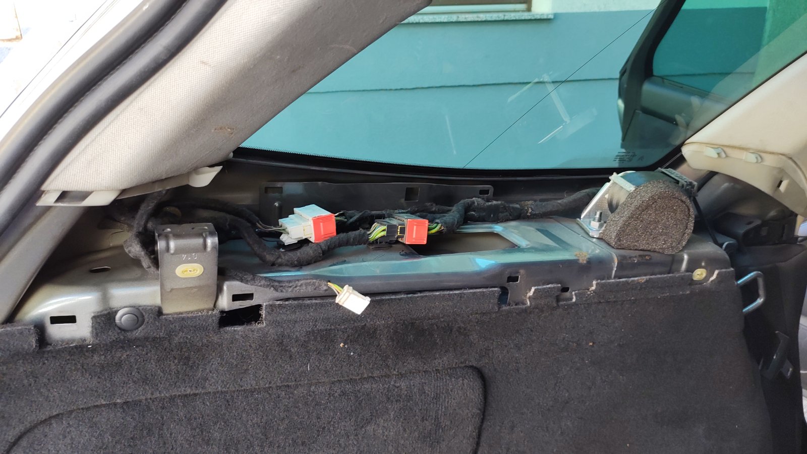

I need to fix left reversing light that is not working. Problem is most probably at squeeze point where loom leaves the body. Did look around but found no obvious damage.
If that's it I'll run the bypass wire and be done with it but for that I need a pinout of connectors in boot, under upper rear wing trim if somebody would be kind enough to provide it.
That's how they look with plastics removed:
Car is Citroen C5 X7 Tourer with VIN VF7**************[VIN obfuscated, can be read by forum staff]

Have a look here - I've already put one up and it's the same for your vehicle after checking:
viewtopic.php?p=747572#p747572
