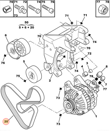

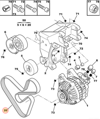

Here you go. There are 2 possibilities and this depends on whether you have the Sanden or Delphi Compressor fitted.derbyshirewhaley wrote: 18 Aug 2023, 14:11 Is the auxiliary belt (or serpentine belt) I need the part number for. I have the timing belt.
(2) Alternator Drive Belt
OEM Sanden, K6 LE 1740, part: 5750VS, £54.05
OEM Delphi K6 - LE 1750, part: 5750YG, £54.05
Cheaper POLY V for Delphi Compressor, part: 1606353980, £25.94
Cheaper Ply V for Sanden Compressor, part: 1606353880, £21.46

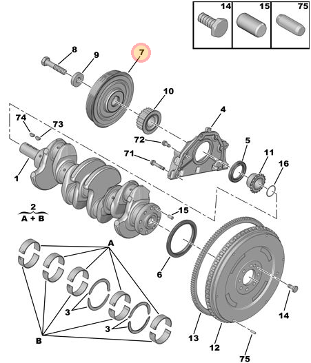

(7) DOUBLE DAMPING PULLEY, DIAM 162X30 EP 37 6V, part: 0515V6, £304.25
(8) Crankshaft Pulley Screw (M14X150-70), part: 051660, £8.47
(9) Pulley Washer, (DIAM 14X40 EP 8), part: 0516A6, £5.41

May I be cheeky and ask what the part number is for part 5 on your last posted diagram? I know it’s the crankshaft oil seal at the idler pulley, and I’d like to be prepared to replace it in case mine is leaking. There seem to be so many profiles for it, I want to get the right one!
After that, I’ll have everything I need ordered to do the job.
- x 6945
Re: 406 2.0 HDi -- Aux. Belt Replacement
No problem.
(5) Crankshaft Seal, part: 032622.
