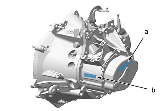

These are the ratios for this gearbox type - you'll have to know what the markings indicate on the actual gearbox you have to identify it and as you can see there are different ratios:
"a" location of the engraving of serial and gearbox numbers.
"b" Identification label.
| Stepping of the gearbox | 1st | 2nd | 3rd | 4th | 5th | REVERSE GEAR |
| BE4/5N | 11/38 | 15/28 | 31/40 | 41/39 | 47/35 | 12/40 |
| BE4/5J | 11/38 | 15/28 | 31/40 | 41/39 | 44/35 | 12/40 |
| BE4/5S | 11/38 | 15/28 | 30/40 | 37/39 | 43/37 | 12/40 |
| BE4/5T | 13/38 | 15/28 | 30/40 | 37/39 | 43/37 | 12/40 |
| BE4/5P | 13/38 | 15/28 | 31/40 | 41/39 | 47/35 | 12/40 |
| BE4/5L | 11/38 | 15/28 | 32/37 | 45/37 | 50/33 | 12/40 |
| BE4/5V | 11/38 | 15/28 | 30/41 | 37/39 | 44/35 | 12/40 |
| BE4/50 | 11/38 | 15/28 | 35/39 | 46/35 | 54/31 | 12/40 |
