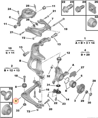

Wishbones:
That's not a valid PSA part number, so can't help you with that. The following are the correct parts for your X7:
(6) Front Wishbone:
Citroen Original Part Left, part: 9666244080, £462.54
Citroen Cheaper Part Left, part: 1682731680, £212.92
Citroen Original Part, Right, part: 9666243980, £469.94
Citroen Cheaper Part Right, part: 1682731380, £157.31
Wishbones:
(6) Front Wishbone:

Thank you for that. My part number is equivalent to 9666243980. They are certainly a diabolical job to fit on a car with Steel Springs. I threw away my scaffold pole when I acquired a 5 foot 3/4" torque wrench.
i think maybe that is how I changed the Left Hand side.
