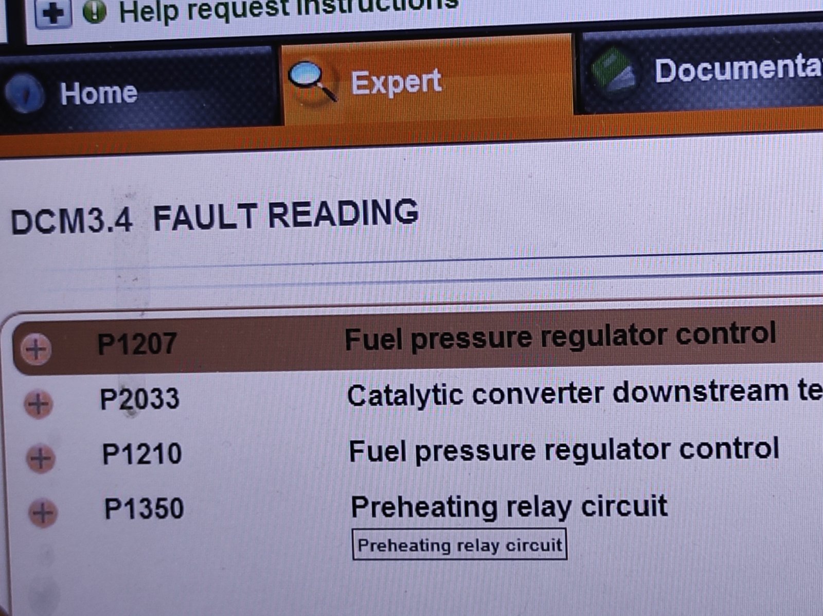

Ok p1207 and p1210 both pressure regulator faults. I forgot to get the description before my laptop died again. My power steering seems to be working with no leaks took about 1 and 1/4 litres to fill and activation was successful no faults recorded. Can anyone tell me the description of the faults

Quickly checked codes
P1207 "Fuel pressure regulation electrovalve short circuit to -ve"
P1210 "Injection control pressure above expected level"
Basically fault diagnosis check
Injection control pressure regulator
Wiring to regulator
Plugs to regulator
Modulator
Hopefully Marc can confirm the above but a possible area to look at.

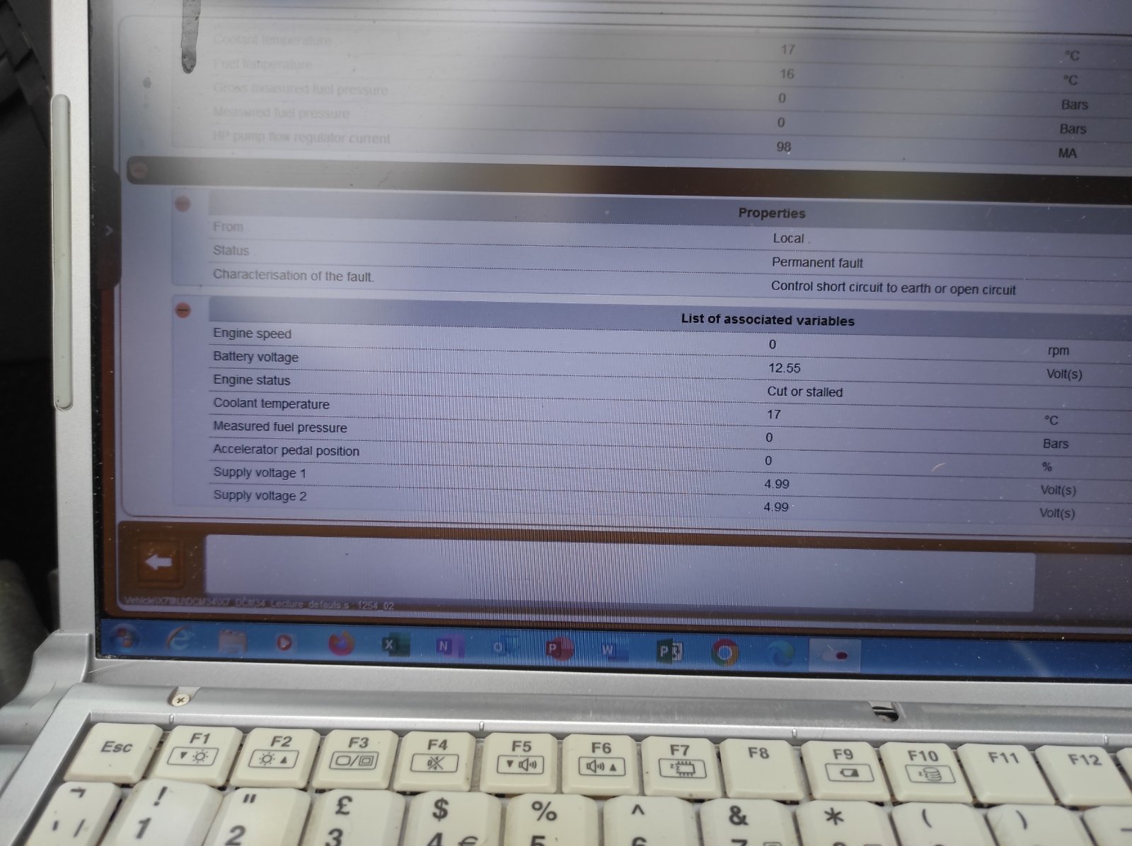

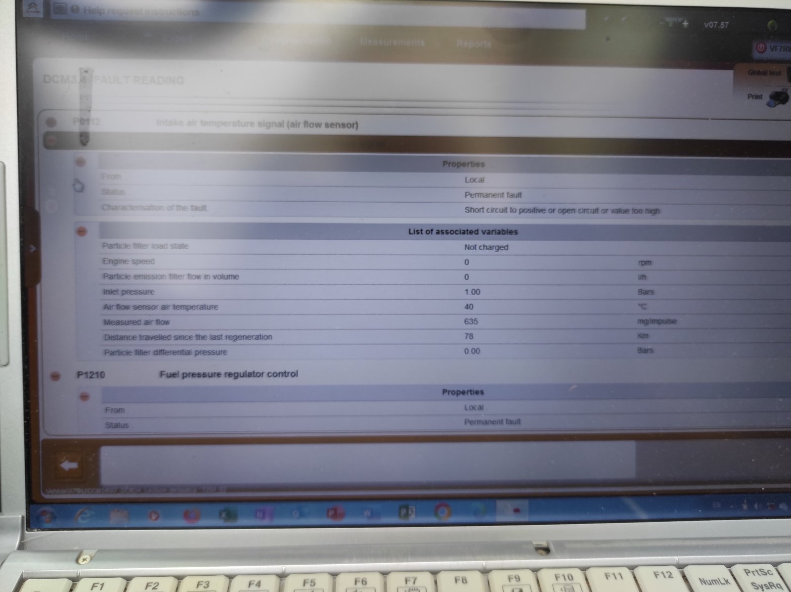

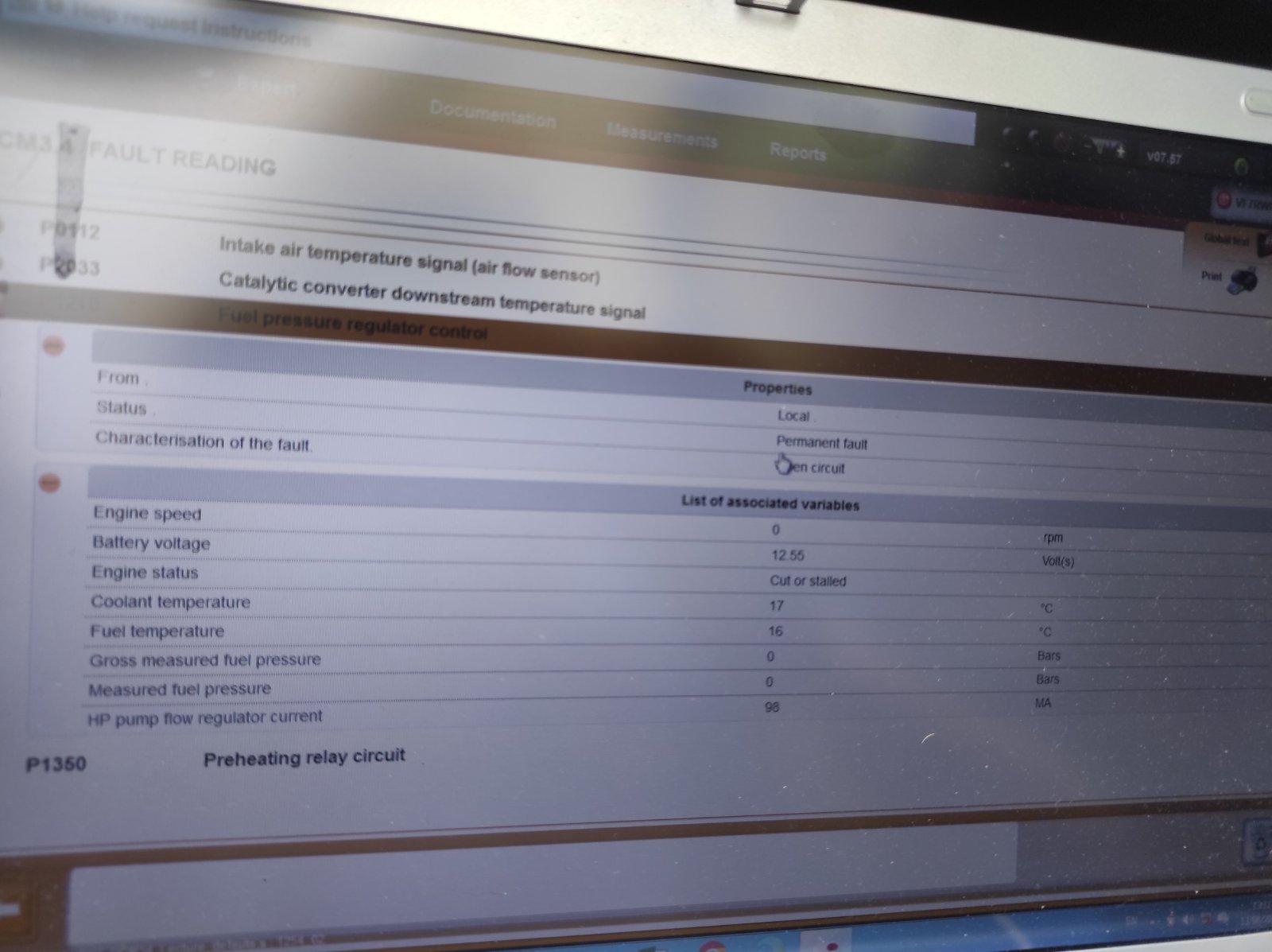

Hi Kenny, yeah I plugged it back in this morning, Pulled the connector off and cleaned it P1207 is now gone just P1210 left , exhaust temperature sensor fault and glow plug relay so only one that would stop it running. It is showing zero fuel pressure which makes me think it's stuck closed there is no fuel at any of the injectors either. So I need to pull the regulator I think. Any other suggestions welcome. I checked the wiring to the sensor and it looks good.I think it's the regulator, maybe it got damaged sitting for so long.

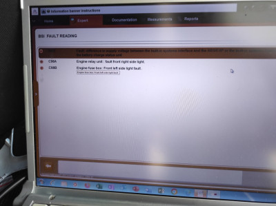

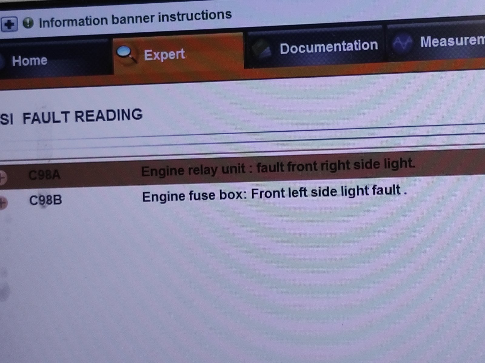

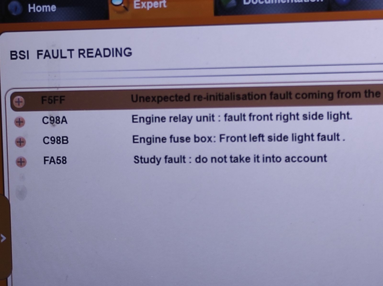

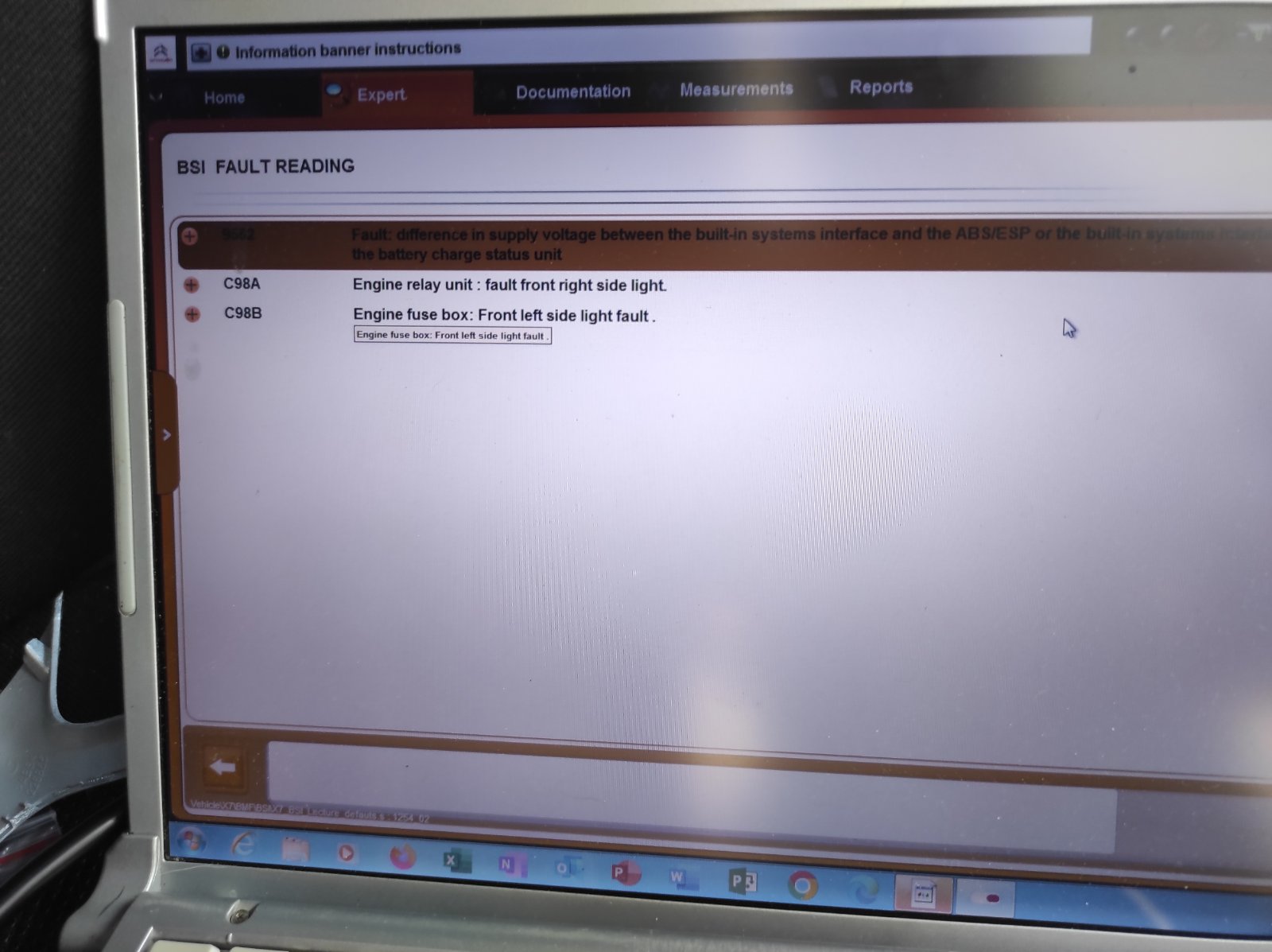

Right I tried a bit of easy start she ran for a few seconds a bit rough but ran. She is being starved of fuel.so I am leaning towards a bad regulator but need to do a bit more investigation.i have added photos of my recent diagbox session.
Darren

Re: Injectors misbehaving but trying to understand the numbers
Darren,
A lot of these faults will clear after an unplug clean and plug back in.
The glow plug fault ignore, the re initiallisation fault is caused by not following the disconnection and /or start up procedure.
I think your main problem is the fuel pressure regulator.
Kenny
Kenny
Hi Kenny I agree it's the regulator that is causing the no start,the bsi reset I will do when I have her running it shouldn't interfere with the car starting and the glow plug relay is always there.
