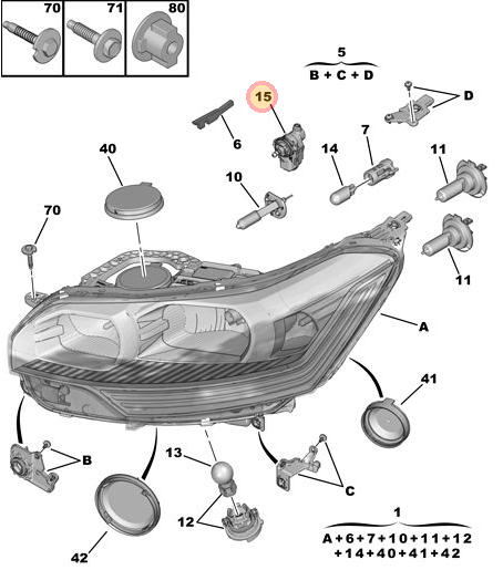

(15) Headlight Corrector, part: 6224S7, £137.98 each.
Your build date is 12266.
From 13844 (October 2014) new reinforced headlight adjusters were used. So yours certainly fall into the affected date. Are you getting a message up on any of the LCD or screens concerning this when you try to adjust the lights when they are switched on?
Anyway check with Diagbox, but if you are are NOT getting the specific fault code C1146 then it needs further troubleshooting.

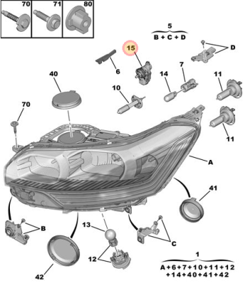

So as I've marked on the diagram the adjuster is item 15 if you are getting the specified fault code.
If not that code, then you may have an earthing problem on the circuit.
