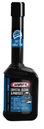

There's always the issue of Adblue Crystallisation. This can block up the injector, first on the inside where the build up continues then it can manifest on the outside of the injector showing signs of white crystals.
Of course there's always the possibility of a leak in the supply pipe. But I do recommend when you get to the bottom of the issue, that you bung in some Wynn's Anti AdBlue with each full top up to help prevent this from happening:
There are some tests I think that can be run - such as pump operation - and the pressure readings - but you have to be careful as this system only operates under certain conditions - so beware of this.
