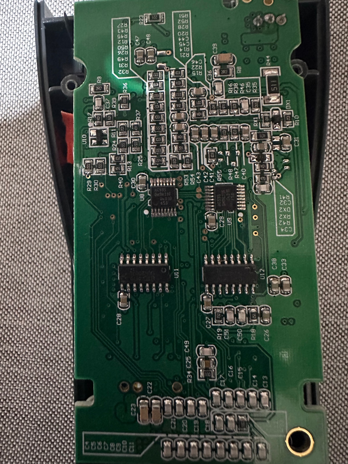

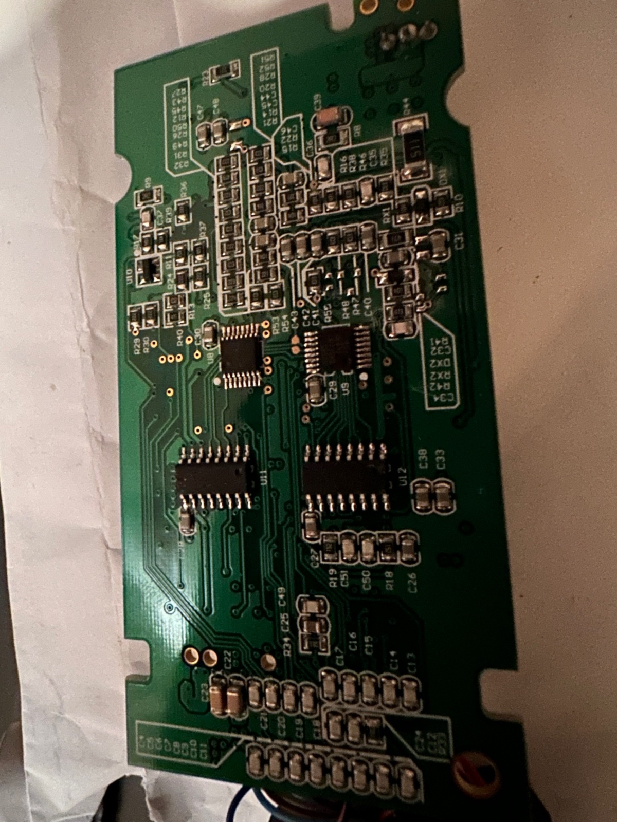

Re: PSA interface tester
Does it look like a fake?
- x 6962
I would need to see good quality images of both sides of both boards.
Also, please upload your photos directly here - no need to use third party image hosting - it's a lot more hassle.
Just use the FULL EDITOR & POST button, hit the attachments tab, browse phone, PC or MAC for images and select multiple images to upload, then use the PLACE command to put them inline with your text.
- x 6962

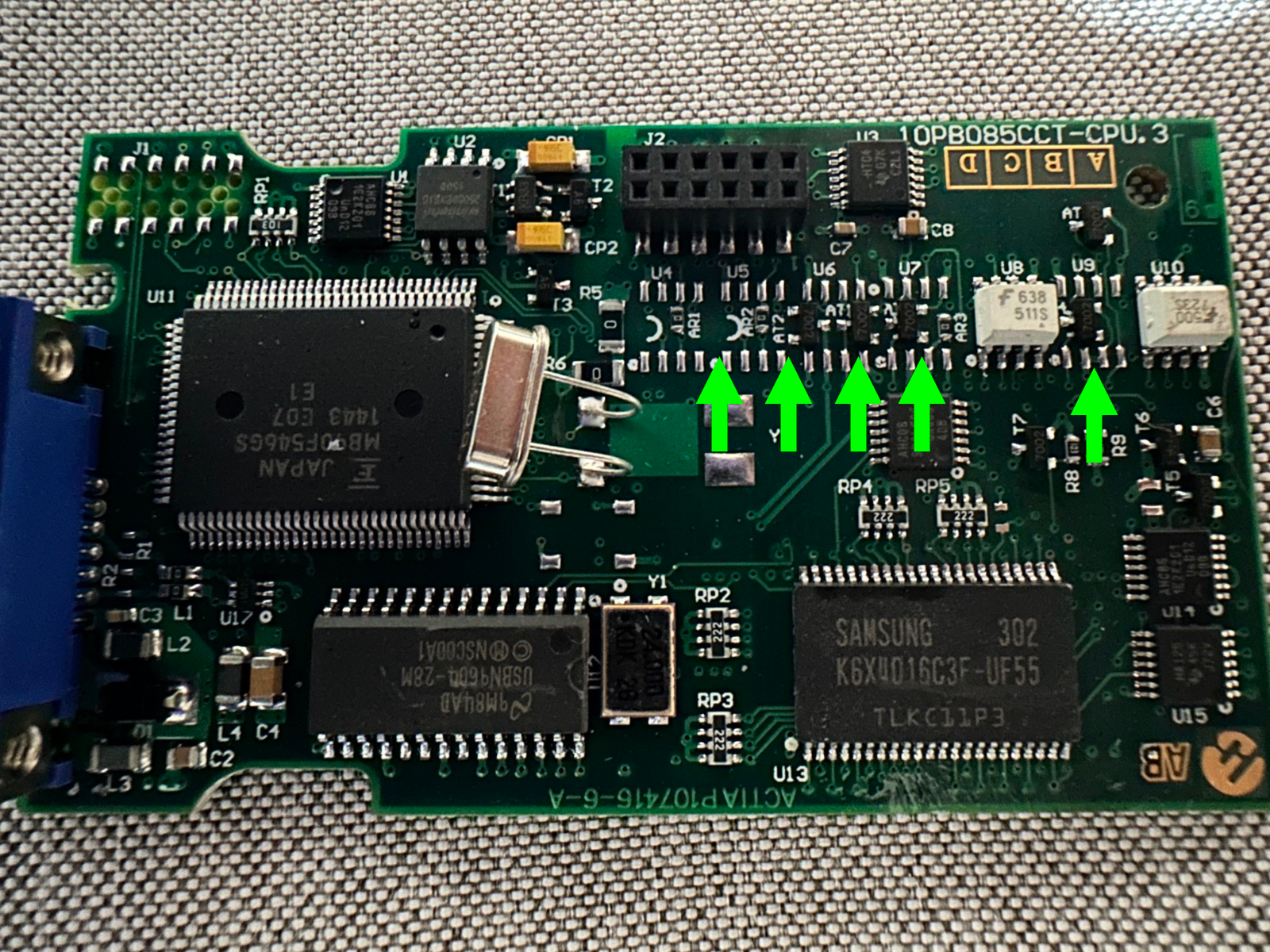

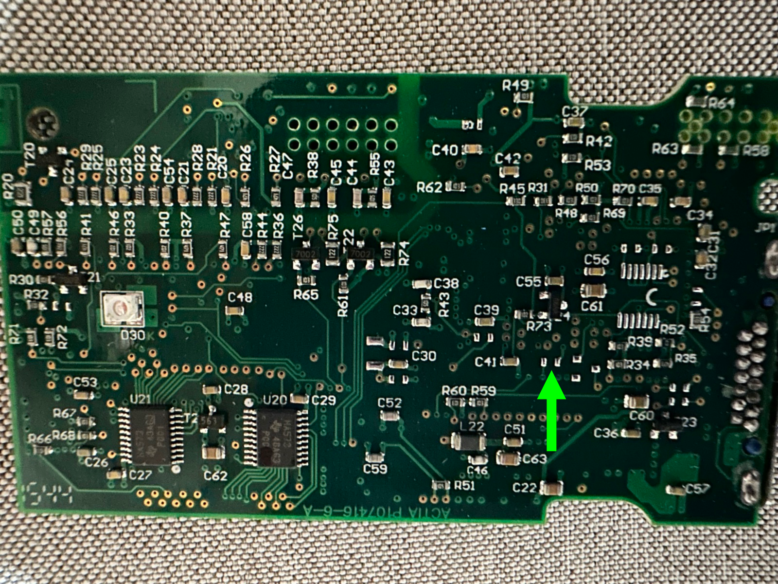

Ok, I can see from some of the boards that they are missing most of the Optocouplers and the 10k Resistor (highlighted below to give some examples - I haven't highlighted everything though), plus a load of other components. Suffice it to say it's the 'lite' version, so won't work on modern vehicles.
