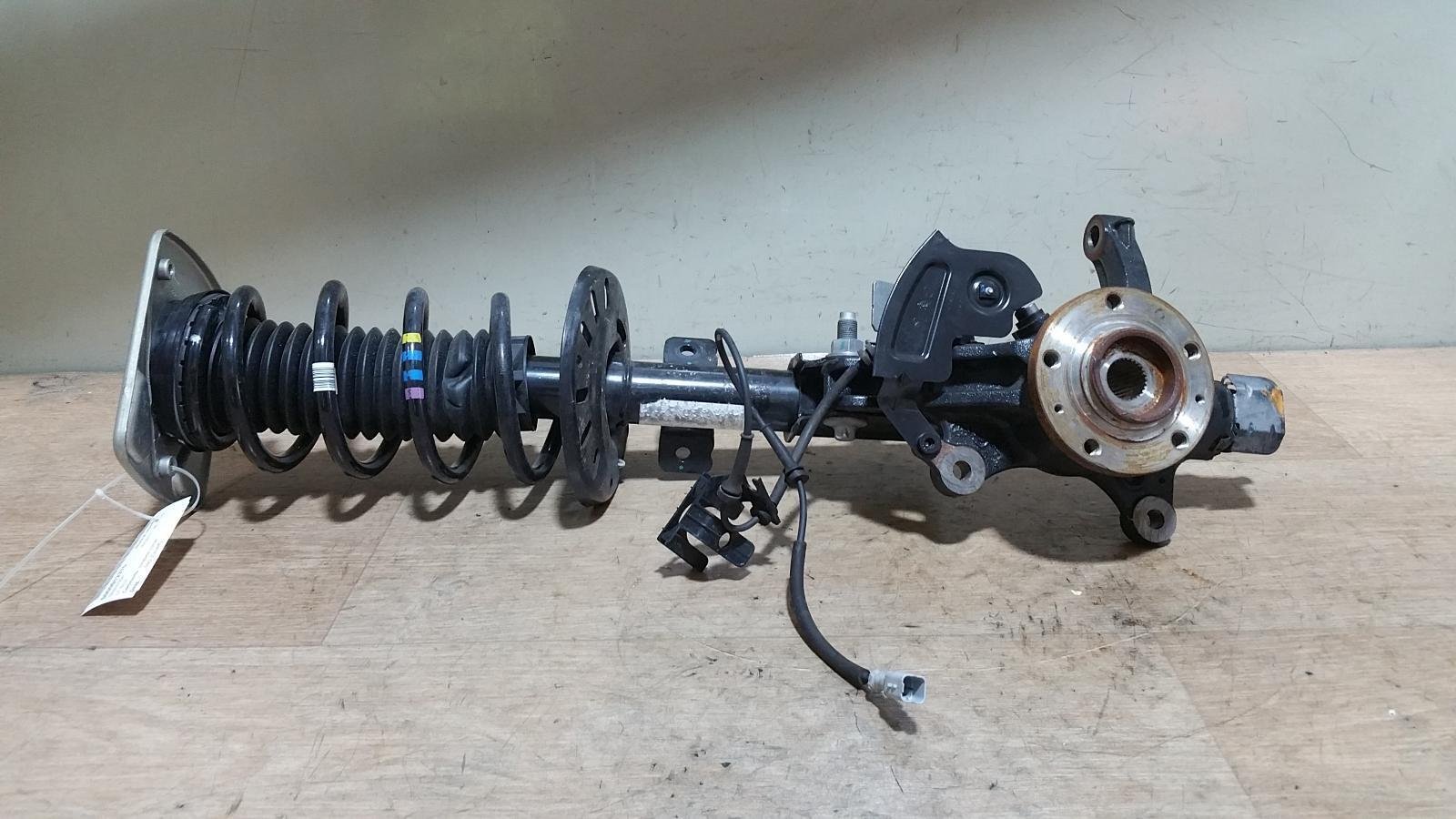

Could be but I can't remember if these have top ball joints, there is a lower arm with the bottom ball joint, then the strut which has the anti roll bar attached and the steering arm, don't recall seeing anything else on it.mickthemaverick wrote: 26 Feb 2023, 17:03 The only time I have come across that type of problem I found the front upper ball joint on the opposite side of the car had excess play allowing the outside wheel to alter camber resulting in a sudden tightening of the steering angle and an apparent dive to the left. That was on a C15 van so may be worth a check!!![]()
This is a picture of the complete strut and it only seems to have places to connect the sway bar, brake calliper, bottom ball joint and track rod end, doesn't seem much to go wrong with it really.

That being the case I'd suggest you check the offside strut top mount to ensure all is well. Purely speaking logically something must move to alter the steering angle once cornering forces are applied and as you say there aren't that many possibilities!!

I'm thinking if the rack was bent it would also pull to the right. Have you checked the suspension strut for straightness? It's the only thing I can think of that would cause that if you've checked everything else. A slight bend wouldn't be noticeable in a straight line but taking corners would exaggerate the issue. Is tyre wear an issue on that side?
