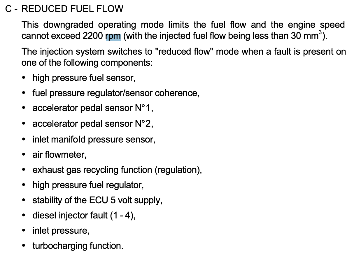

OK - some more diagnostics.
Cap presence sensor - it definitely has a sensor, and a pair of magnets on the cap to trigger it. Closed circuit indicates cap present. If I disconnect the sensor from the loom, Lexia now shows "cap present". With the sensor connected, tested with a strong magnet, it always shows "cap absent". So, I think my sensor is bad (or an incorrect replacement, since it doesn't look original). I will leave it mostly disconnected and trigger it manually when I top up the fuel for the moment. I still don't know if the additive tank is actually adding anything, though I suspect it is.
I have a copy of the Bosch injection ECU technical manual, from a source that I possibly shouldn't mention. It describes "DOWNGRADED MODES OPERATION", which I assume is what we generally refer to as limp mode, as: That's not what I'm getting - I only really have hill-climbing torque above 2000 RPM (and I think less than I should even then). So I don't think it's in an unreported limp mode.
I'll try to take a look at the wiring, etc, for the injectors and glow plugs next, I think. Though I might have limited success given the access space.

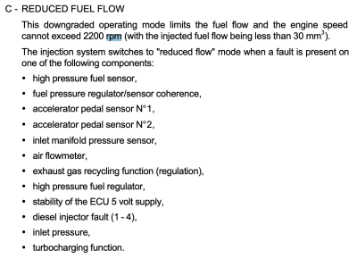

My issues the same as tearing hair out, my car will also go over the 2200rpm so can't be limp mode. I'm at the stage now where I do 30 mph in second gear incase there's a hill or slight incline, also in an attempt to get the engine hot enough for regeneration
Champion of Where's CitroJim
