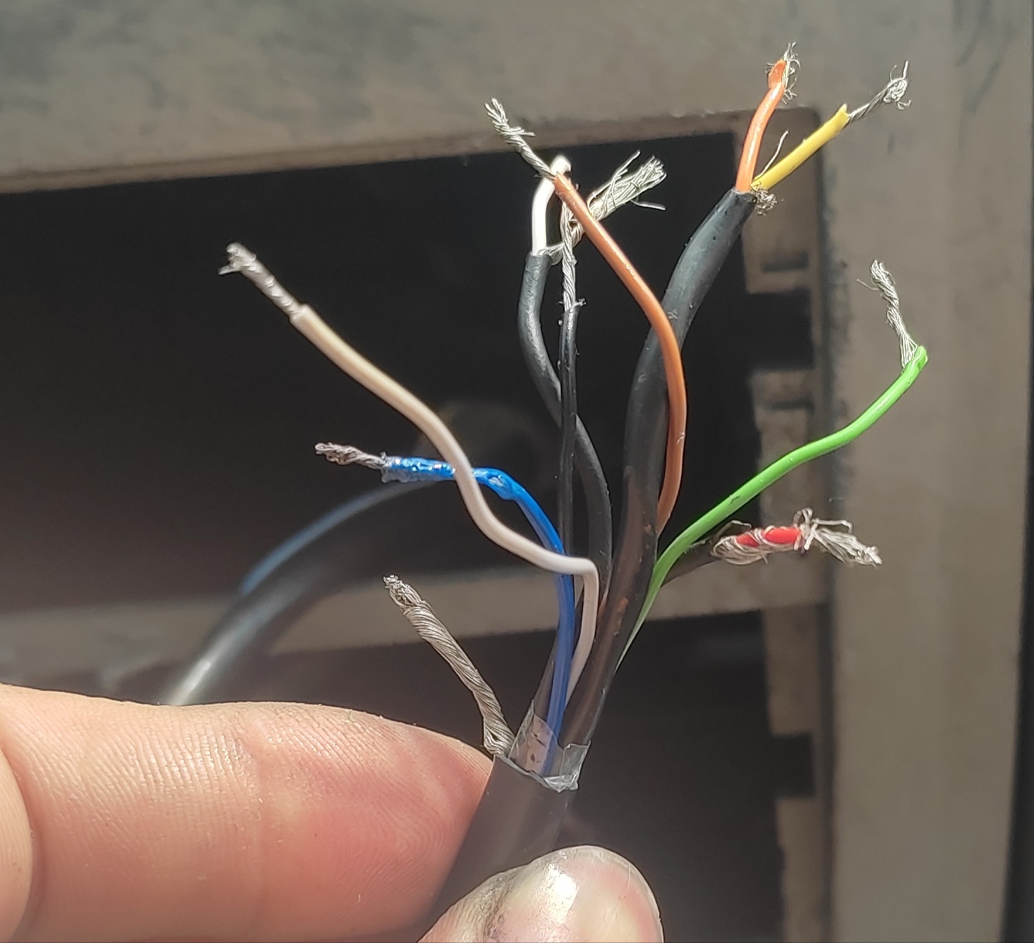

does anyone know the colour codes for a Megane Mk2(2004) radio?
Someone cut the connector and I want to mount an kenwood radio since I do not have the original .

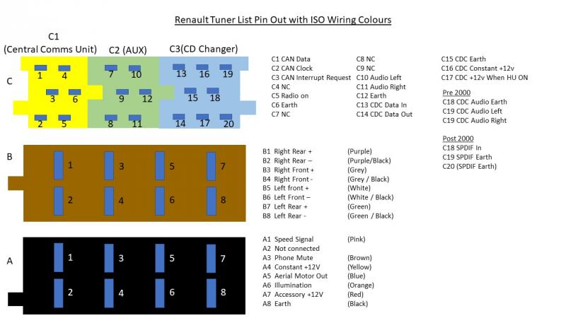

The cable you are holding looks like the "A" connector cable of the radio that was fitted to the car, there will probably be another one( or maybe two) cables in there some where, because between the Update List Radio's and the Tuner List Radio's there is no difference in the A connector, here is an image of the connector(s) of the Tuner List stereos with the colours and what they do
