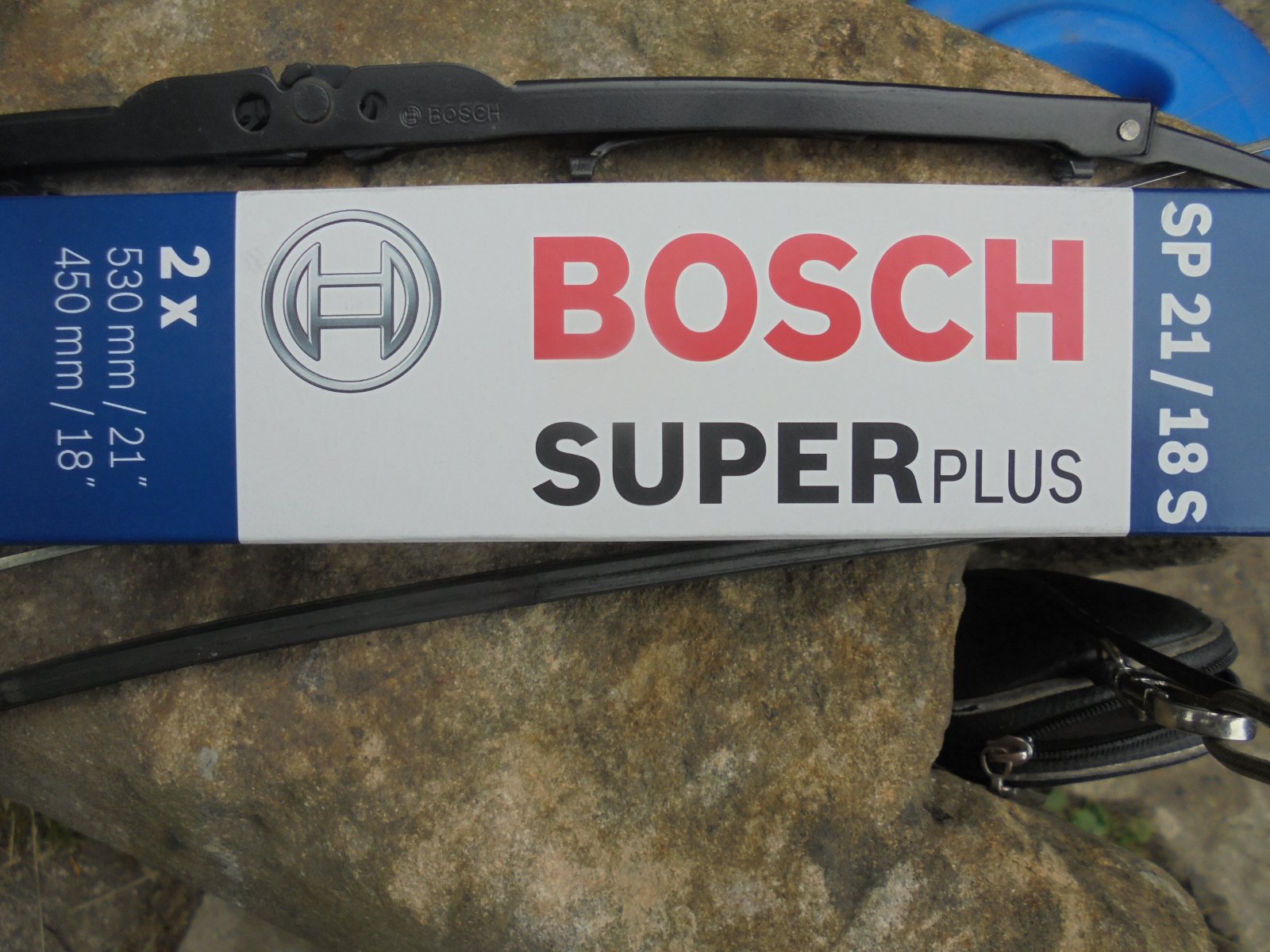

Gave the Bargain Basement Micra a bit of a treat today...new wipers back and front. This 2-pack front, and the rear one were surprising good value at about £20 from Halfords.
Falcon Original<br />Bosch via Halfords
Falcon Original
Bosch via Halfords
Falcon Original
Falcon Original
MOT/Tax at the end of the month, mile-o-meter is now at 74,792 from 72,851 at the last MOT. Around 2,000 useful workhorse van like miles around the doors, with just the occasional bit of pleasure motoring.

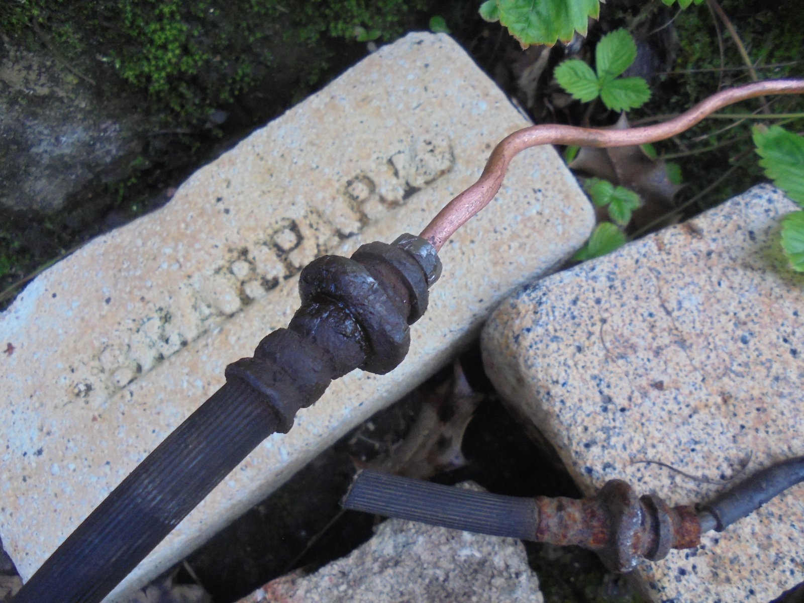

Last MOT I did the flexible brake hose at the RH front, its a double length thing with a silly little hook thing and a banjo fitting at the caliper end. To pre-empt a possible failure and it does no harm to present a bit of newnesss, I intend to replace the LH one. Went to my usual source of unbeatable prices the much maligned Eurocarparts and even cheaper for the same stuff sidekick Carparts4less, only to find things have changed. Overpriced at Eurocarparts at £32 ish and the same price with none of the usual additional discount through Carparts4less. GSF have it too but same sort of price £32.51 (after discount so they aren't any better)
I may have to take my bargain basement pound somewhere else. :-D Quick look at the net and without trying many options for the right hose at £20 and less inc new Quinton Hazell branded, and free postage. Just looked back, and the RH one as below was £30 last year :-D. I must have grown more bargain basement than last year being shocked into looking for something cheaper :-D
Last years part
NewcastleFalcon wrote: 01 Aug 2022, 20:25 Doing some more shopping at carparts4less. Flexible brake hose to sort the rusted ferrules. Micra's is like this at the front
£30 after discount at ECP, check every time but there is an Extra £6 discount if you order through Carparts4less

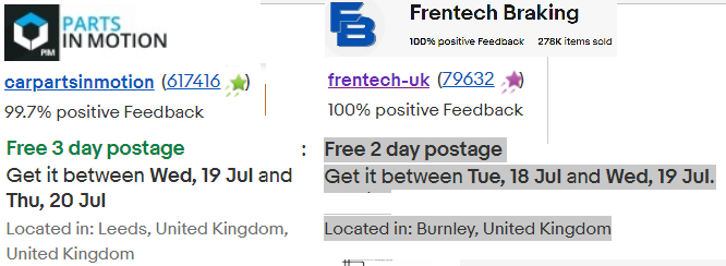

Partsinmotion on e-bay have had a few mentions on here in the past, generally positive, and they have a Bosch branded LH front Brake Hose for the 2005 Micra K12 1.0 at £19.82 with free postage. Referenced up nicely with the Nissan Original Part no 462109U01A.
Partsinmotion
https://www.ebay.co.uk/itm/235006608455 ... %3A2047675
As well as the full set of Nissan Technical Manuals for the BB Micra being available on line, the parts catalogue is too
https://nissan-europe.epc-data.com/micr ... 2/46201MA/

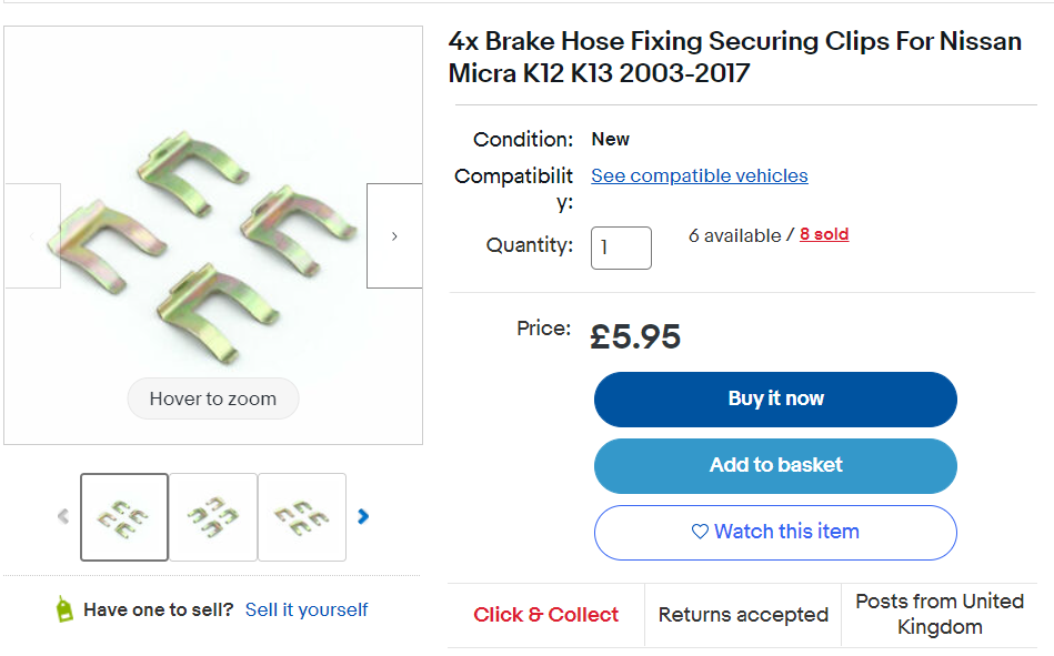

Re: Bargain Basement Motoring
Looks like its Leeds, and Burnley who have won the Falcon pound for the hose, and the clips respectively.
Posts: 26415
x 7164

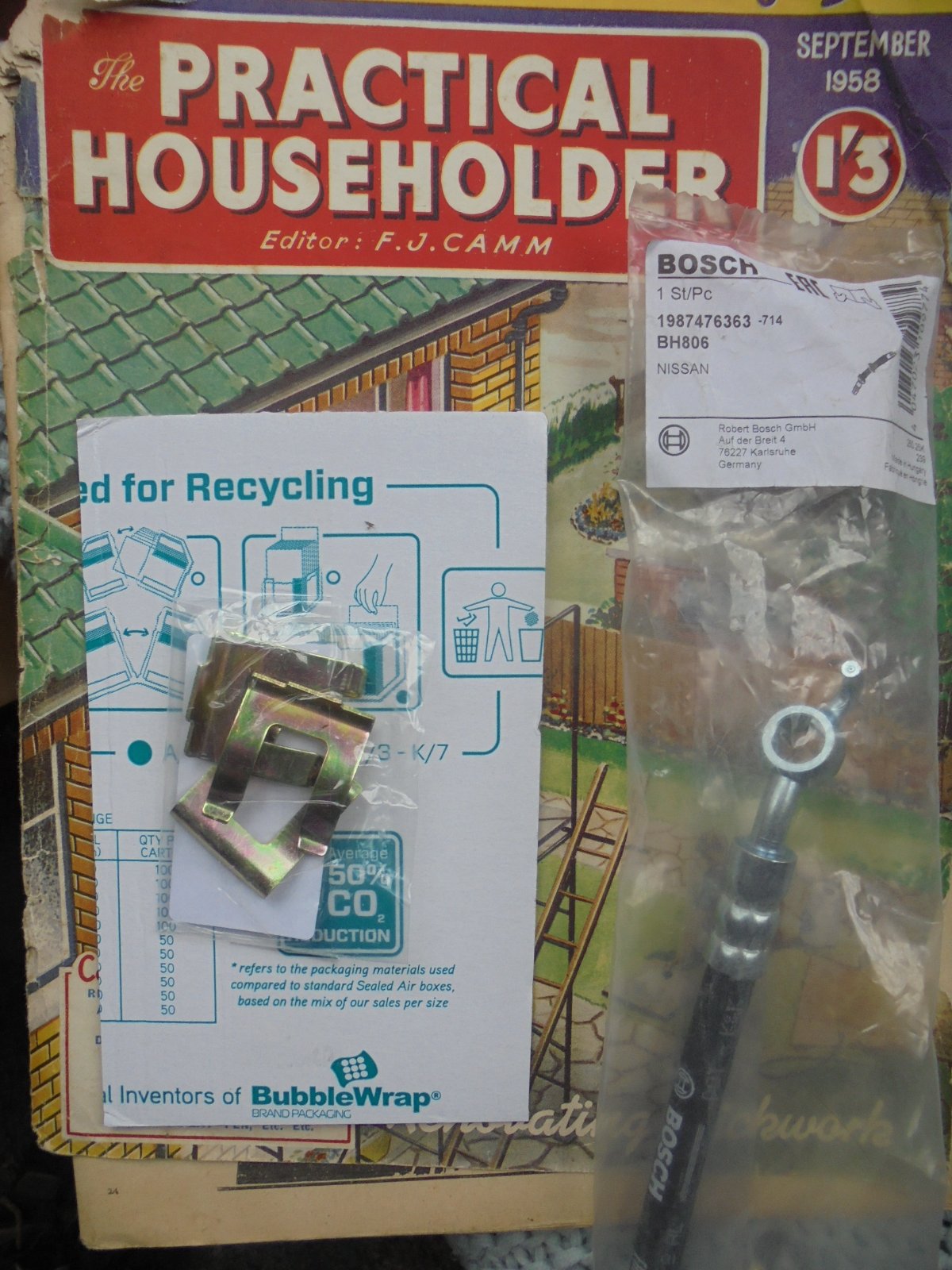

NewcastleFalcon wrote: 16 Jul 2023, 12:43 Looks like its Leeds, and Burnley who have won the Falcon pound for the hose, and the clips respectively.
..and Leeds and Burnley have come up with the goods today
Falcon Original
Falcon Original

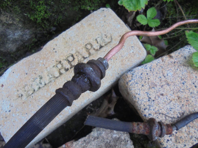

Thought I had better make a start and fit my new parts. Simple job...undo a metal brake pipe to flexible hose union, and a banjo bolt at the calliper end. Remove old hose, fit new one.
I have the appropriate hex brake spanner and unlike last years struggles...there was a cunifer pipe and decent hex on the union nut. Promising. Fascinating trivia the cunifer name comes from ( copper, nickel and Iron (yes the fer bit)).
Same story as last year as it turned out. The join between the metal pipe and the flexible hose would just not undo. Sorted it by making a new pipe with new ends going from the ABS block to the flexible hose.
You know what I should have ordered...new banjo bolts and copper washers. Never come with the flex hose and where do you get them from...the internet only I am guessing. Had to nip it up tighter than I felt was right to dry up the drip. That's enough prose...like to keep things visual...
Falcon Original<br />The Undoable Nuts 2023 and 2022
Falcon Original

That job nearly became a bit of a 'mare Neil...
I know what you mean about new copper washers and banjo bolts. Seems crazy not to include new ones... I think I'd get new ones given you are not 100% happy.
I've tried annealing previously used copper washers in the past but I still find nice new uncrushed ones work better...
