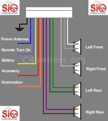

Would you happen to know if I could get something like this, but for the 2nd Gen C4GP?
I've got red / purple wiring to my NS door speaker and I'm unsure which is the positive?

Re: 2014 C4 GP Adding Carplay & speaker upgrade.
As you provided your VIN already I have the info you need for the fitted unit:
Most of the hardware codes are on the wiki:
https://frenchcarforum.co.uk/wiki/Elect ... ring_Codes
As for wiring, focus on wiring codes printed every so often on the wiring insulation and not on the colours as they change on PSA vehicles.
