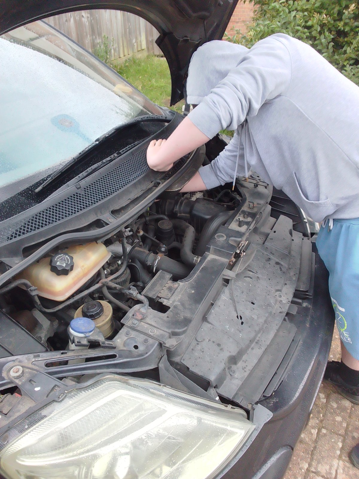

I need some advice on tape that will survive engine heat/vibrations. In other posts I've mentioned that I've had an issue with an air pipe 'popping off'. Is there a tape out there that would work? And no a jubilee clip wouldn't work

I tend to use ally tape for that sort of job Ryan, this is an example of what I mean:

Thanks Mick, just ordered a roll. I think that will be cheaper than a new air pipe. I think the original pipe has shrunk over the years. Another tick off the list before my Lexia turns up

As an extra aid I tend to overlap the tape a fairway along the pipe from the split and then use cable ties to fasten to the outlet rather than jubilees which can cut into the tape and render it useless!! Good luck

It's arrived, taped it up, well my boy did. and then I realized...I use this stuff everyday!! We call it silver tape and we get rolls and rolls of it to help stick plastic sheeting to the wall. Oh well £3.95 for a lesson learnt is cheap

Well I can confirm it sticks like sh1t to a blanket, I've done quite a few runs with her and that tape ain't moving!! Definitely does the job, I would recommend it.MattBLancs wrote: 22 Jul 2023, 21:49 Absolutely, wasn't knocking Mick's suggestion at all - interesting to hear how it performs really
