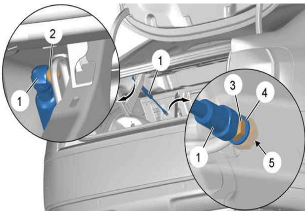

I think you've taken the wrong part off! You've removed part of the strut from it's own fixing instead of removing it from the vehicle side. Now you're left with half of it still attached to the vehicle side ball joint:
First make sure you have the boot supported!
Unclip the gas strut (1) from the ball joint (2) of the boot hinge using trim removal tools.
Loosen the ball joint (3) with the washer (4) of the gas strut (1) holding the nut (5).

If you look at my diagram you will see that the nut (5) is actually behind the blue metal panel. so you need to hold the nut at the rear (careful not to lose it) whilst unlocking the nut on the other side (3) as far as I can see.

I followed what you posted and managed to loosen (3), but I still can't remove the strut (1) from the ball joint nut (3).
I could remove 3 and 5 and take out the strut with the connector and joint(3) attached. But i'm not sure if that is the correct thing to do. Per the diagram, I should just loosen 3, not remove it. Is this correct?
Are there any next steps or is the strut(1) just supposed to come off after with a bit of a wiggle after loosening the ball joint(3)?

That's all there seems to be - I 've never had to do this on mine, so can't help you with the job other than what it shows.
