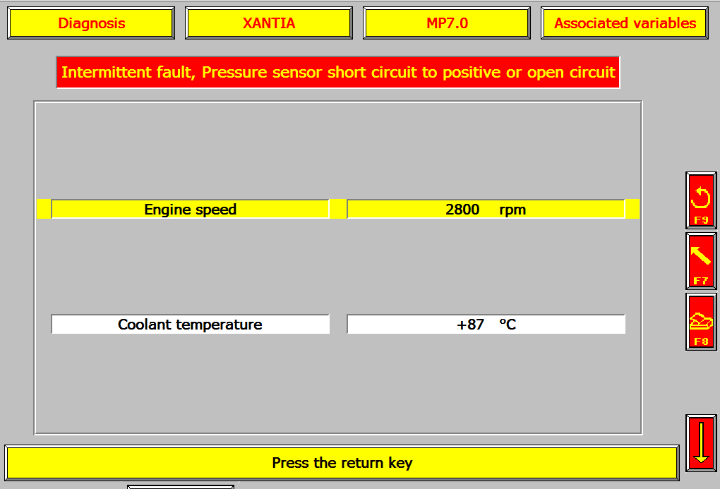

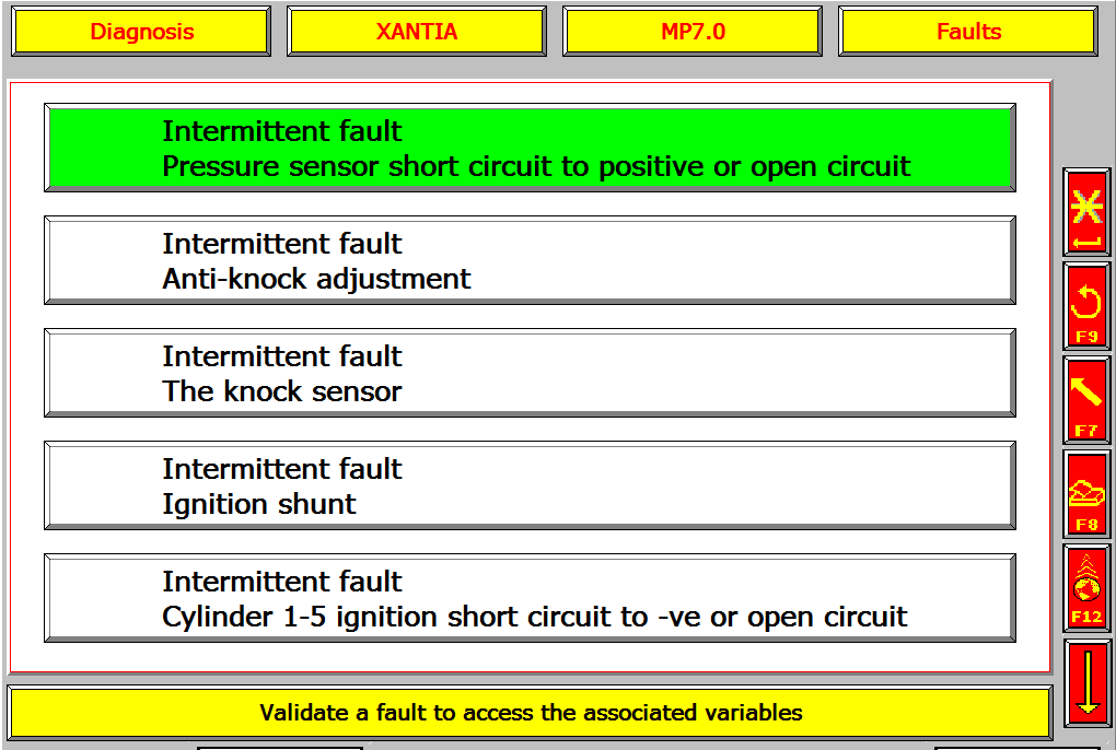

So, since I last posted things have not gone well with the Xantia and I fear maintaining the car is starting to get out of my depth.
It has been off the road for around 3 months now with (probably) two different engine faults and I've only just had a chance to have a quick look today, and it's not good.
First some back story. For years there has been an intermittent problem causing momentary cut-outs in the engine which are occasionally enough to stall it if its idling. I haven't been able to identify any cause and it has gradually got worse.
On our big trip down south last year the first part of the trip went fine but it started intermittently "tugging" as if the engine was cutting out slightly - it got bad enough at one point that I was sure we were going to break down. On the return trip it did the same for a while and then went away again.
A month or two later in local driving it took a major turn for the worse - where it would be running fine one moment and then instantly felt like it was running on only four cylinders with barely enough power to pull across a junction, and making a kind of "putt putt" noise when you tried to put the accelerator down.
It continued to do this until I pulled over on a safe spot and was struggling to even idle. However I turned the engine off and back on and it was immediately running smoothly again. I then set off and about 20 seconds later the same happened - it felt like it was two cylinders down on power.
It did this a couple more times and then started to behave and we made it home uneventfully and I parked the car up and decided not to drive it until I had time to investigate.
When I did look into it nearly a month later I found two very worrying problems - one was LOTS of scary looking engine fault codes on the Lexia.

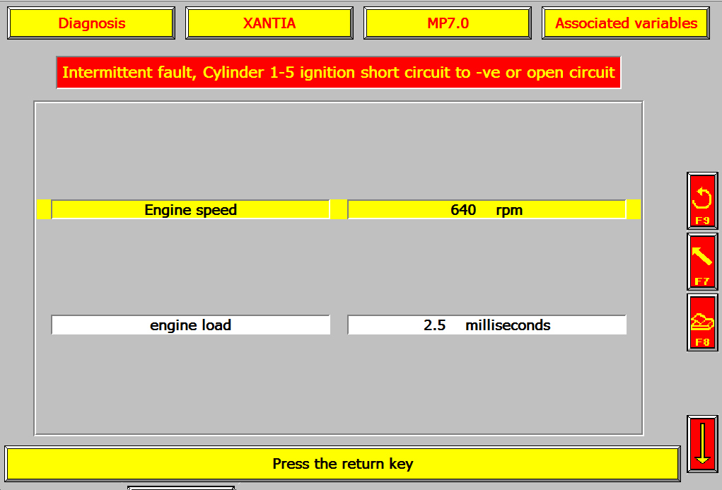

This seems to be too many separate faults not to be related ? I suspect the core problem is the "Intermittent fault, Cylinder 1-5 ignition short to -ve or open circuit" ?
I'm assuming that would be a fault in one of the coils in the coil pack so I could be needed a new coil pack ?
I think I have a spare one somewhere I have previously removed because I wasn't happy with the way the car was running with it, (I think that one was playing up when it got hot) so I'm not sure if I should try swapping the coil pack over.

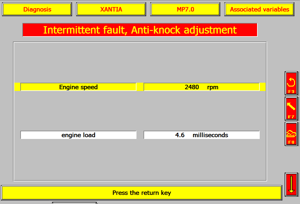

I'm assuming the knock sensor code is not actually a faulty sensor (god I hope not given where it is) but a result of the engine presumably running on 4 cylinders ?

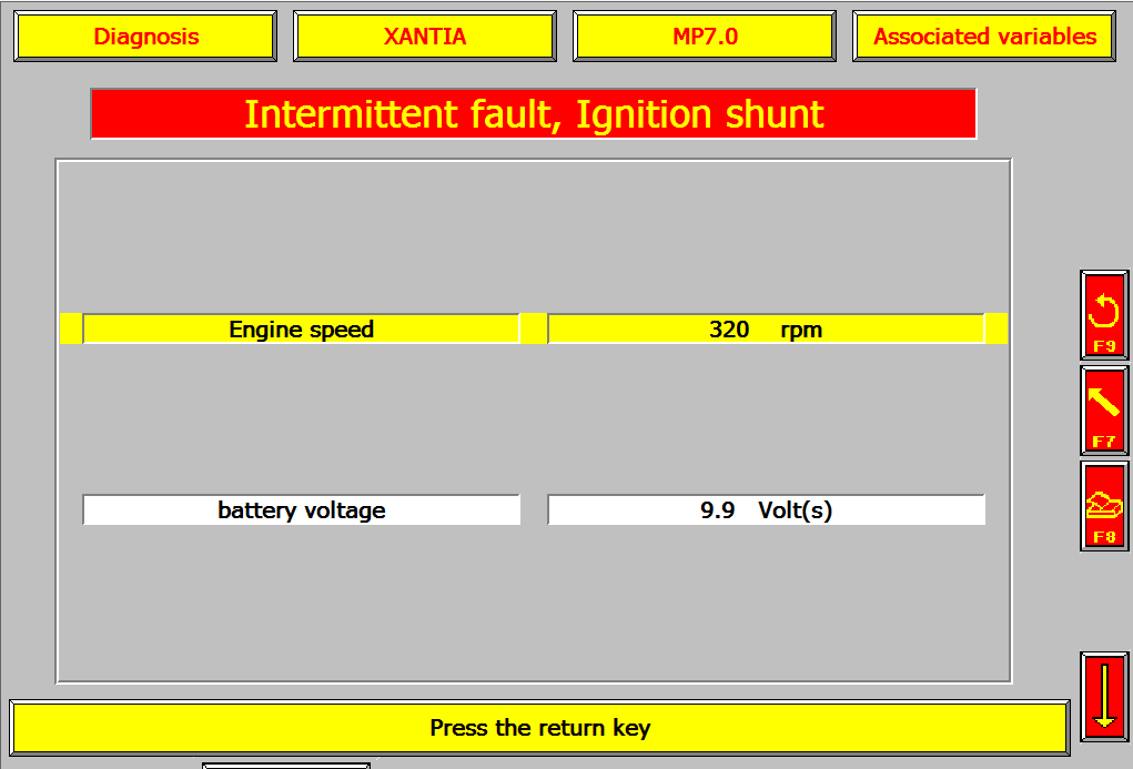

No idea what the "Ignition shunt" error is reporting ?

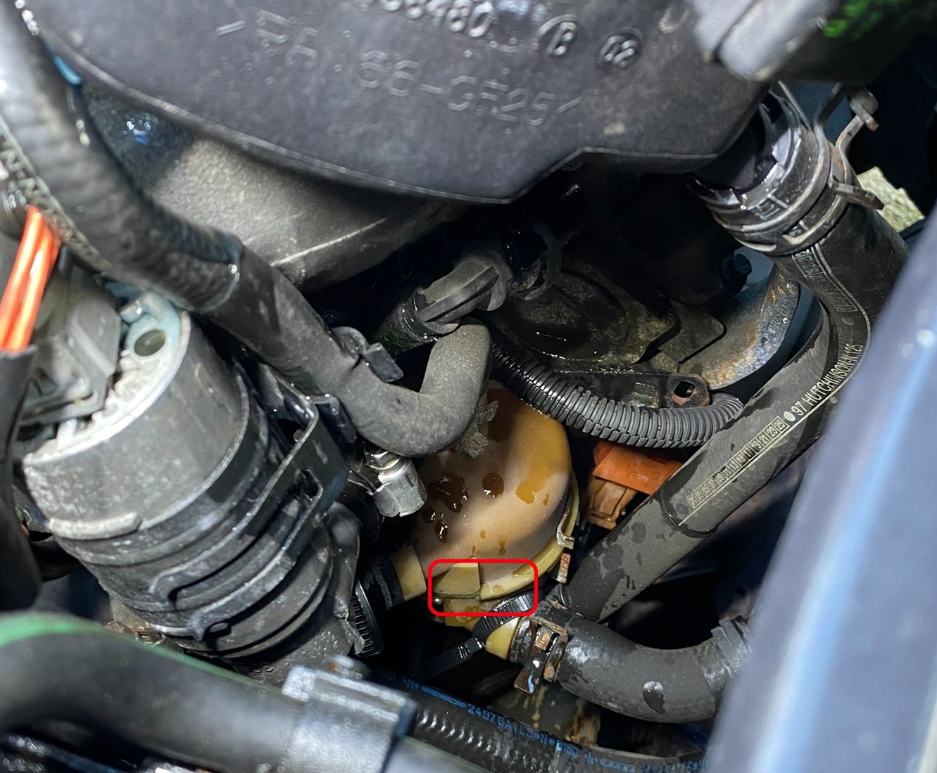

The second thing I found while I was warming the engine up is I noticed the cabin heater was not getting hot at all. With a sinking feeling I checked the expansion vessel and it was empty. It turned out that it needed well over a litre of coolant to top it back up again. I let it idle for a while until it could get hot enough to open the thermostat and bleed itself and the heater and radiator both started warming up as normal.
Now another month later I went out to check the car and the coolant was not visible again - despite the car not even being driven. It took around half a litre to top it up this time. I let the car run for a while until the coolant was maybe 60 degrees and I think I've found the culprit:
With the engine running and the coolant hot/pressurised there were two tiny streams of coolant squirting out the side of this "Bulb" connector along the seam indicated by the red box.
As soon as I cracked the expansion vessel cap it stopped leaking so it only seems to leak when hot and under significant pressure.
So what is this thing and is it unobtainium now ? How difficult is it to replace it ? With the coolant expansion vessel removed is there sufficient access to replace it just through the top or does it take some significant disassembly like removing the throttle body ?
Anyone know where I could get one of these ?
I'm also concerned that if the car has been driven 10 miles or so with the coolant level so low that the radiator and heater were no longer working (thinking back the heater was NOT working on the day it was being driven where it keep seemingly dropping to 4 cylinders!) that there could be damage to head gaskets etc...

I think that the plastic degassing tanks (1307HJ) are being remanufactured now, but a quick search does not find them. I have a spare used one (in good condition) that you can have, but I can't get it to you until the beginning of May, as it is in France and I am in New Zealand.
For your fault codes, I would try cleaning all of the wiring connectors that you can find in the engine bay and ECU box.

The coil pack is a good call for all the ignition issues Simon. I had two fail on me when I ran V6s... They are not the most reliable bit of the V6.
Certainly the first thing to eliminate.
