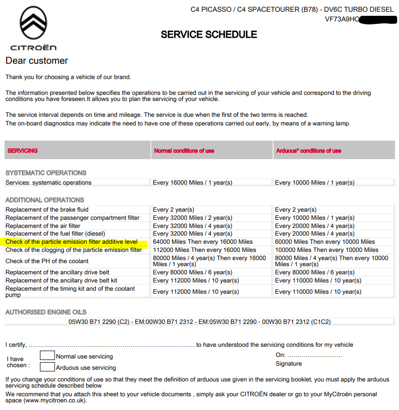

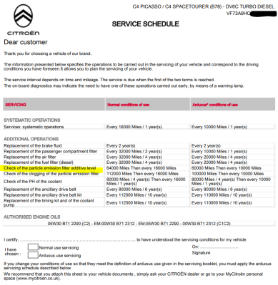

x 6954
Re: Fuel additive level too low error
Dealers do have the information readily available to them as franchised dealerships. They have to go on extensive and expensive training courses to qualify on systems and technical procedures and readily have access to service documentation and procedures in every dealership. I have much the same info that they do.
Here's the summary and I've highlighted the check:
Click Image to Zoom

x 6954
You are getting close as if you look at the servicing schedule it should be checked at 112k miles then every 16k miles. However we have seen vehicles going past this figure - it will depend on the type of road conditions. Lots of short journeys in traffic may reduce the life if the filter slightly, but they are designed to factor in average conditions.
In any case you could opt to have the DPF cleaned instead of replaced. There are places that do this now, but you will also need to tell the engine ECU that the DPF has been replaced if having it deep cleaned, otherwise it will not know and still flag you a warning when the Cerine deposits reach the amount in grammes that I talked about previously.
As for the monitoring, I can't see that helping too much as this level will fall and rise according to the particular time you undertake the test. Once he filter has regenerated the pressure will fall again and gradually build back up until it regenerates again.
