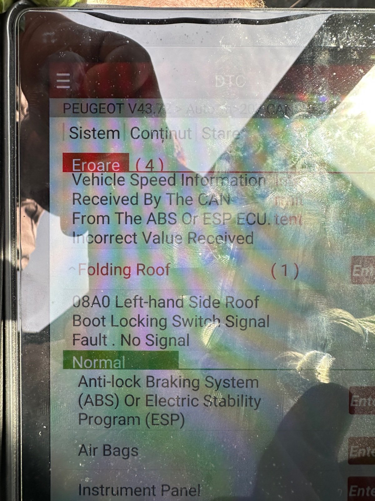

Hello! I have a provlem with my Peugeot 207cc. Roof problem. Error code is 08A0 left hand side roof boot locking switch Signal fault. No signal. Any fix FOR this error ? Thanks a lot.

I think that I saw a video where that fault was caused by a broken wire in the harness that goes from the car body into the boot lid.

I try search in on google, bur nothing.. have you this video ? Thanks

Not the video I was looking for, which was on a french YouTube channel a couple of years ago, but maybe helpful...

There is a video where some chap repairs the loom just have a deep dig on youtube i think its a red 206cc but it might shed some light on your 207.
