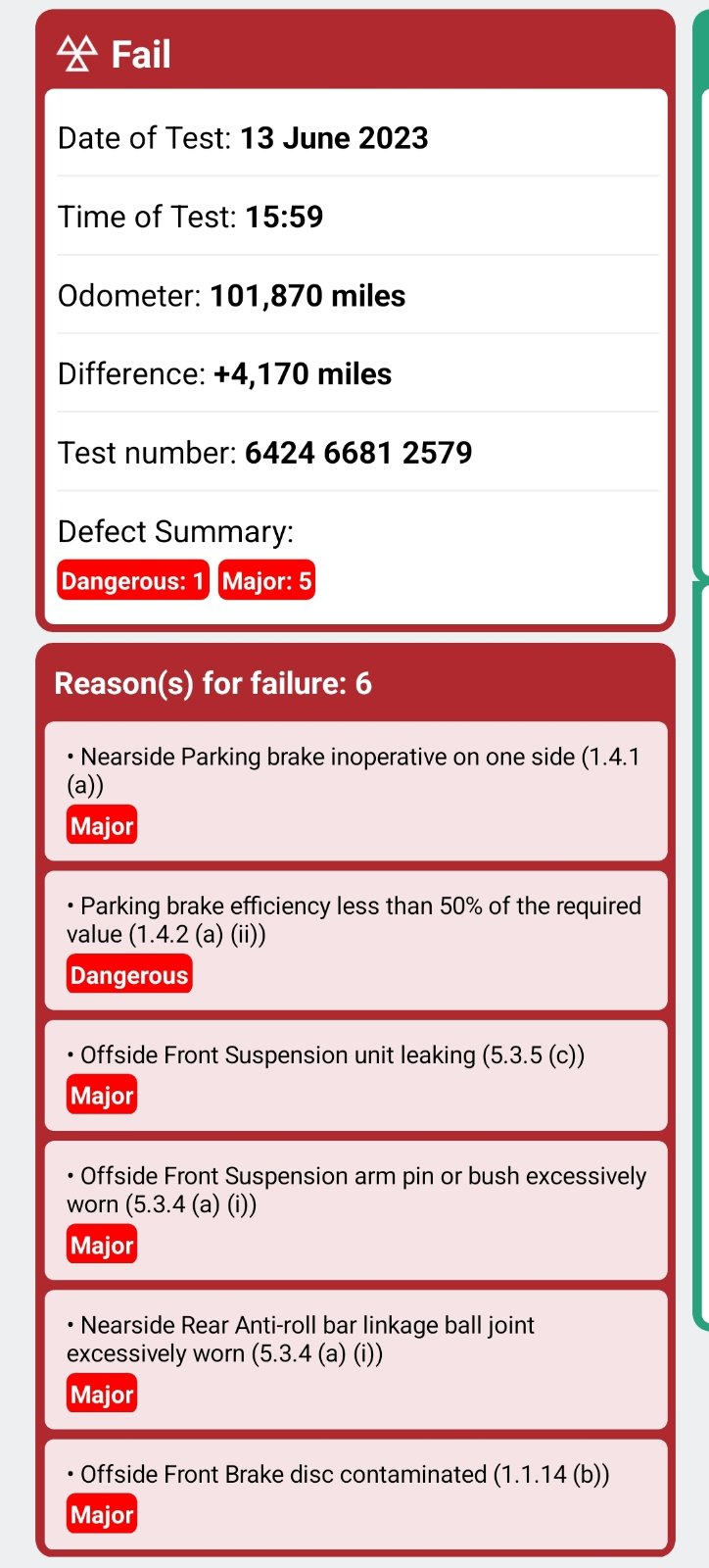

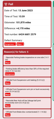

I have a 2007 Citroen C6 2.7 HDi which until recently was my daily driver. I absolutely love the car and of course the feeling of it being rather special. Recently I took it for its MOT and it failed, not spectacularly but enough to cause a large bill. As anyone who is familiar with the C6 knows, large repair bills are just an aspect of owning one, but it is more some of the specific items I am reluctant to pay over the odds for.
How difficult are the suspension units at the front to change as a DIY repair? I have Lexia to hand which I'd imagine is needed for assistance in bleeding the LDS system, they are available as a new genuine part from Neo Brothers on ebay in the region of £250 to £300, but garages I would trust to do this will only buy them from Citroen themselves who are now charging double this.
The handbrake units on these are of course ridiculous in the fact they can only be programmed once so a secondhand one is useless, luckily I've found someone who makes aftermarket cables for them, and I'm told they are not overly hard to swap out, I would do both at the same time.
Other bits I can either confidently do myself or entrust someone local to carry out the work, it's mainly the hydraulic suspension unit that I'm worried about. Has anyone here changed one themselves?

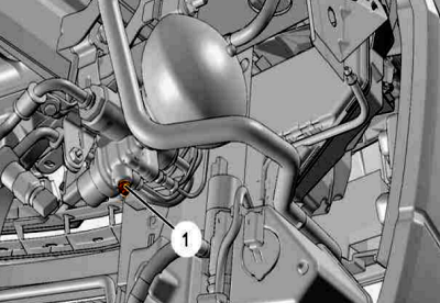

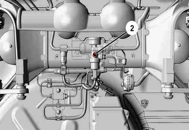

I just paid my dealer to fit only - as I supplied them with the original new OEM strut that I got from Poland at at least half the price Citroen wanted.
You don't even need Lexia, as you can depressurise the system on either the front or rear axles independently if you don't want to completely depressurise the whole system.
Just don't re-use any collected LDS fluid that seeps out.
Front suspension: Undo the detensioning screw (1) by one turn.
Wait for the pressure in the hydraulic circuit to fall fully.
Rear suspension: Undo the detensioning screw (2) by one turn.

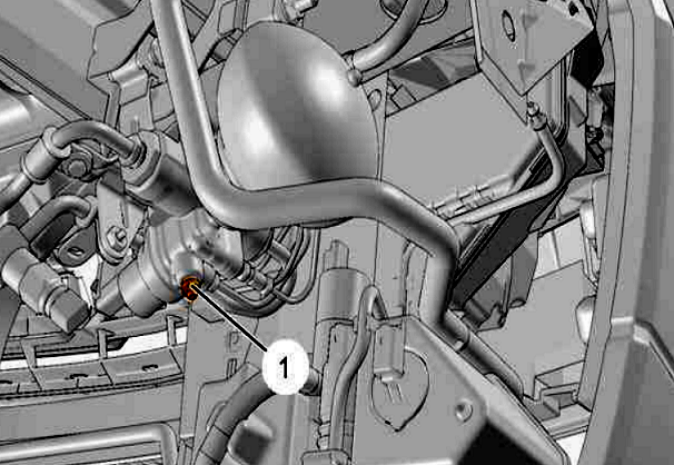

- Start the engine.
- Set the height control to the "LOW" position.
- Stop the engine.
