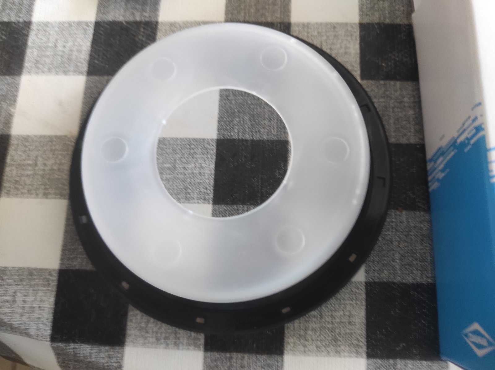

Hi all just a quick post for anyone who is looking for one of these seals. See pictures below. It's a Victor reinz seal
Darren

These are the seals that shrink fit with heat off the running engine. You don't oil the crank to install them. If you do, they can fail as they can't seal correctly. Got this from the local engineering shop.
