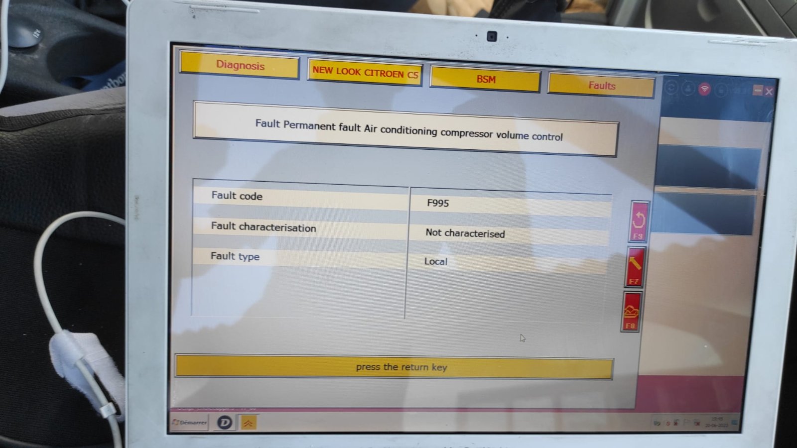

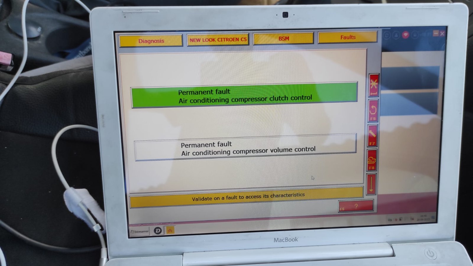

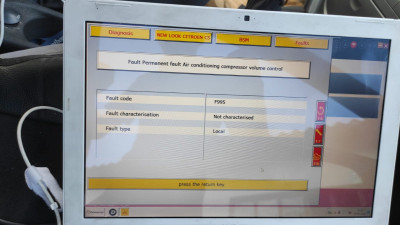

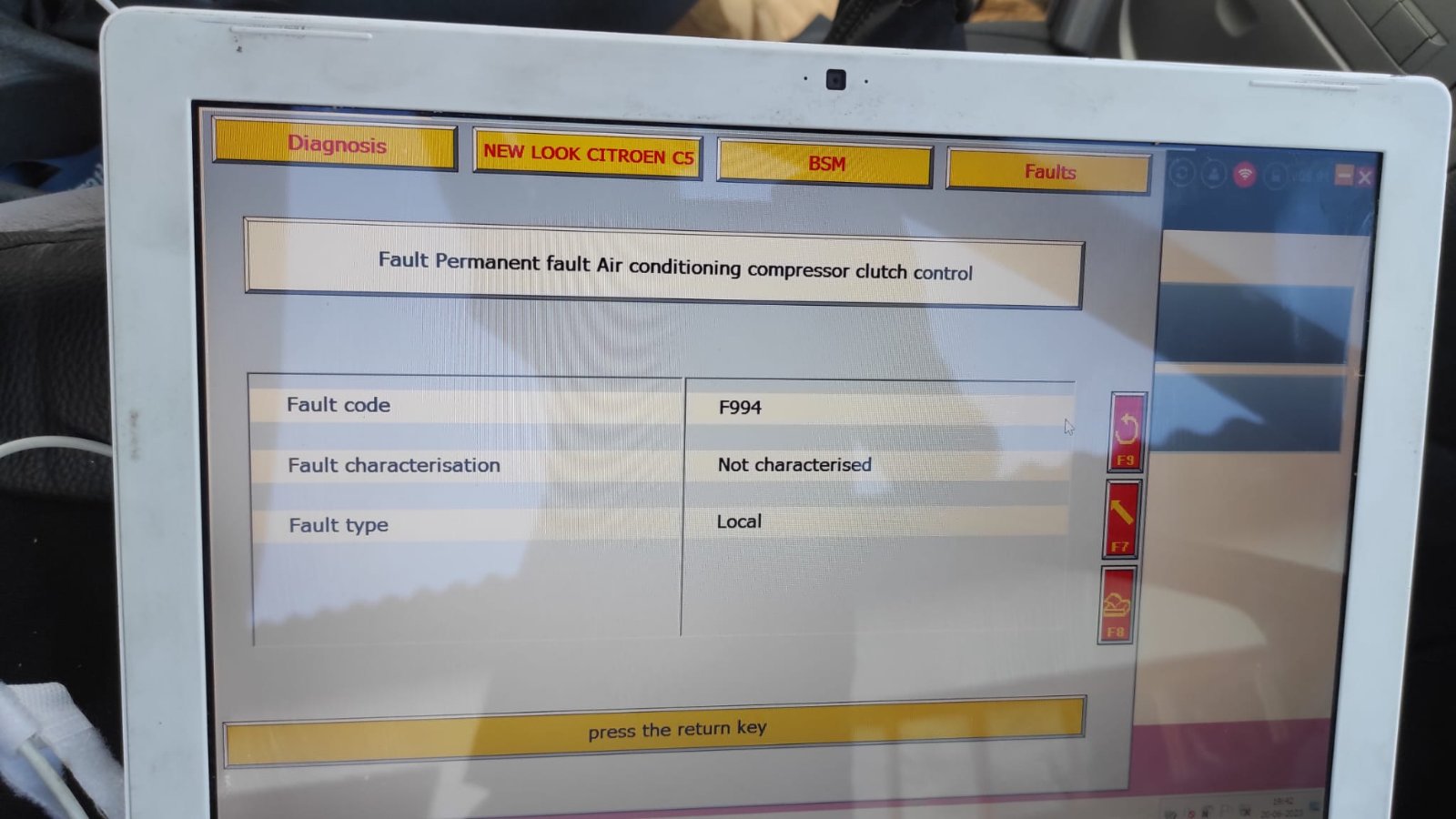

However, after connecting the Lexia scantool, I get the following errors:
F994 - Air conditioning compressor clutch control
F995 - Air conditioning compressor volume control
Could these errors be attributed to the low refrigerant pressure or could there be anything wrong with the AC electrics in my car?

Forget all that - you really need the A/C system tested for leaks first of all, because if there is low pressure, the AC compressor is switched off intentionally so as not to damage the compressor.
It needs taking to a specialist who check the entire circuit, valves and determine if there is any gas leaks. Once that is repaired and re-gassed, you'll probably find the system is working, but if not, at least you can rule out the A/C system. The compressor may have even failed, but you won't know until you have the system checked first.
