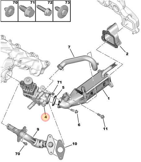

I'm looking firstly for the oem number of the egr that would have been fitted to my van, and can anyone recommend a good quality manufacturer of an aftermarket egr valve for the boxer?

Hi John - a couple of things - can you please put any official parts requests in the official parts thread - as I may miss any requests asked elsewhere, given the huge number of posts we get (viewtopic.php?t=69962). Second, I can't remember if I told you, but your Boxer is outstanding an after-sales campaign. You really should give Peugeot a call and they'll be able to tell you what the work involves - but it will be free of charge. This is important as if you are experiencing issues, there could be a software update or some remedial work that could impact on the vehicle's performance..... So I'd certainly get this sorted before you go replacing parts.
Back to your request:
(4) EGR Valve
OEM Original Part: 9800555380, £450.40
Ford Exchange EGR, part: 1638155280, £282.32
(4) EGR Valve
