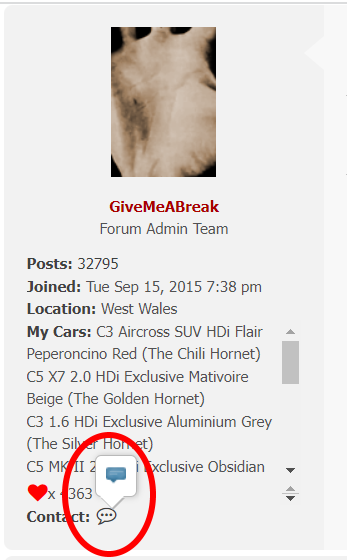

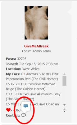

Re: 2014 Grand C4 Particle Fluid Error
Unread post by Paul-R »
If you click the three dots next to the word 'Contact' and then click the small balloon that opens up just above that will take you straight to the PM board with Marc's username already filled in.
