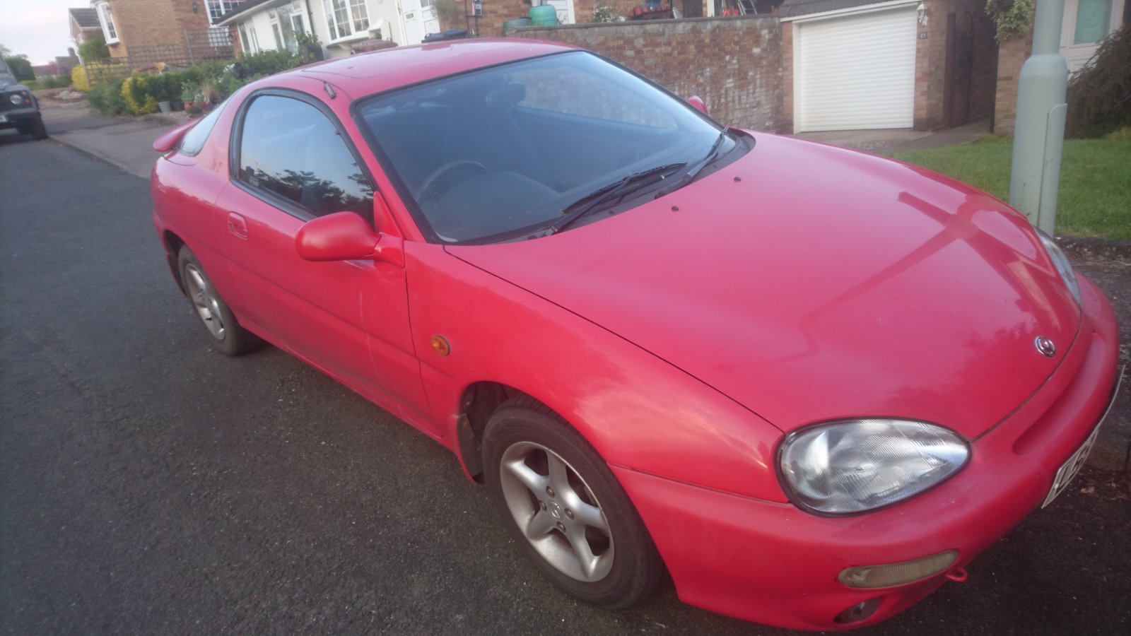

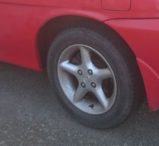

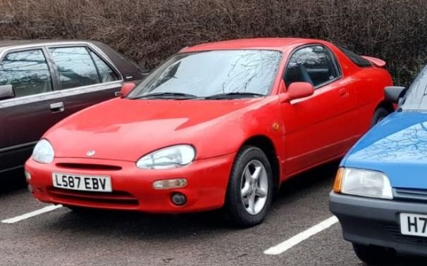

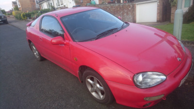

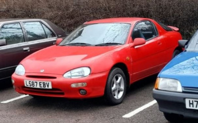

Finally got round to sorting the remaining major body issues on the MX3 today. That being the surface rust in front of the rear wheel and the horrendously faded wing mirrors. I still have to polish the works but the initial results look very promising and perfectly good enough for me:
Wheel arch before:
Wheel arch after:
mirror before:
mirror after:
I just need to give the whole car a wash , wax and polish and it will be ready to show!!

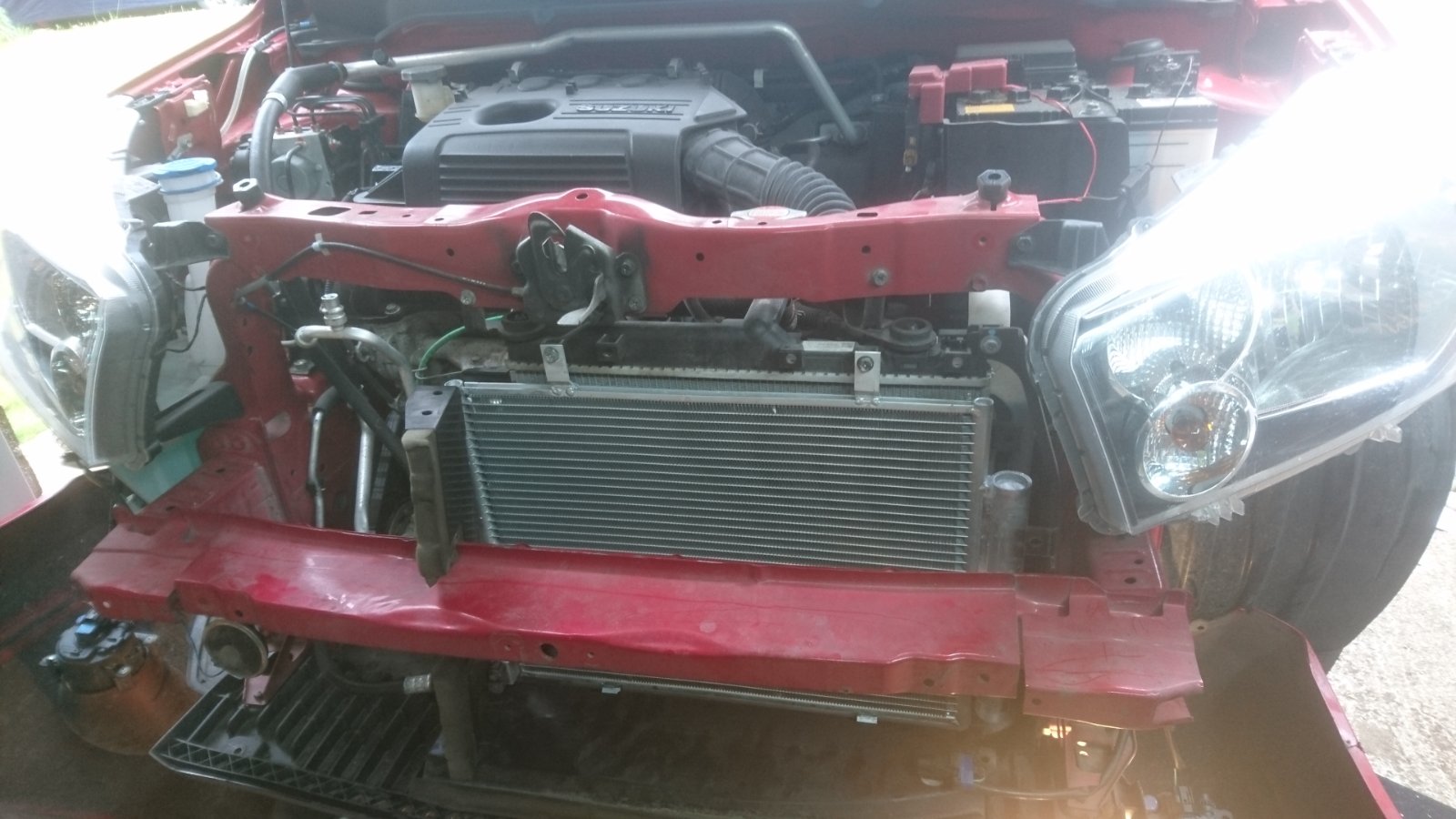

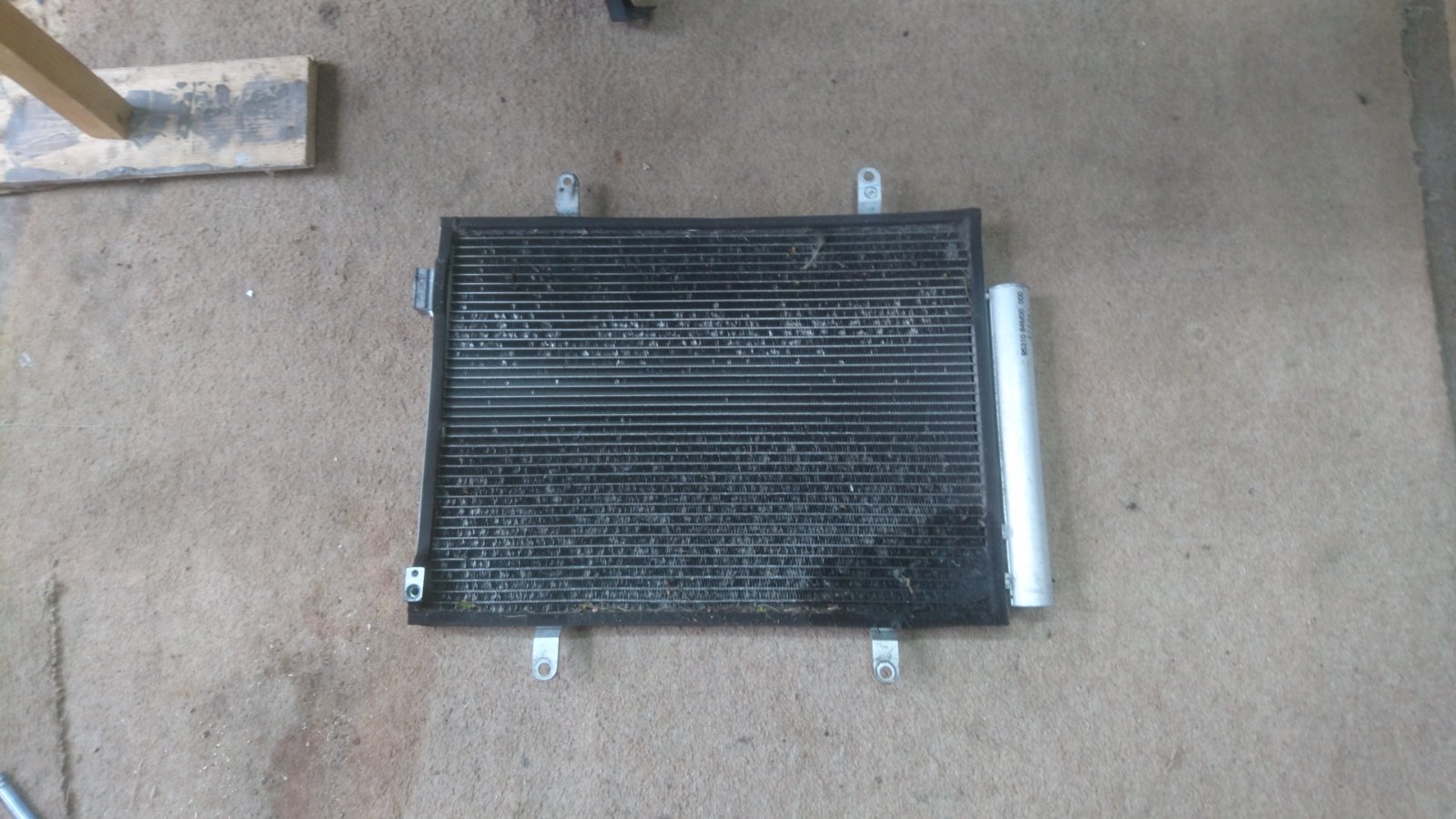

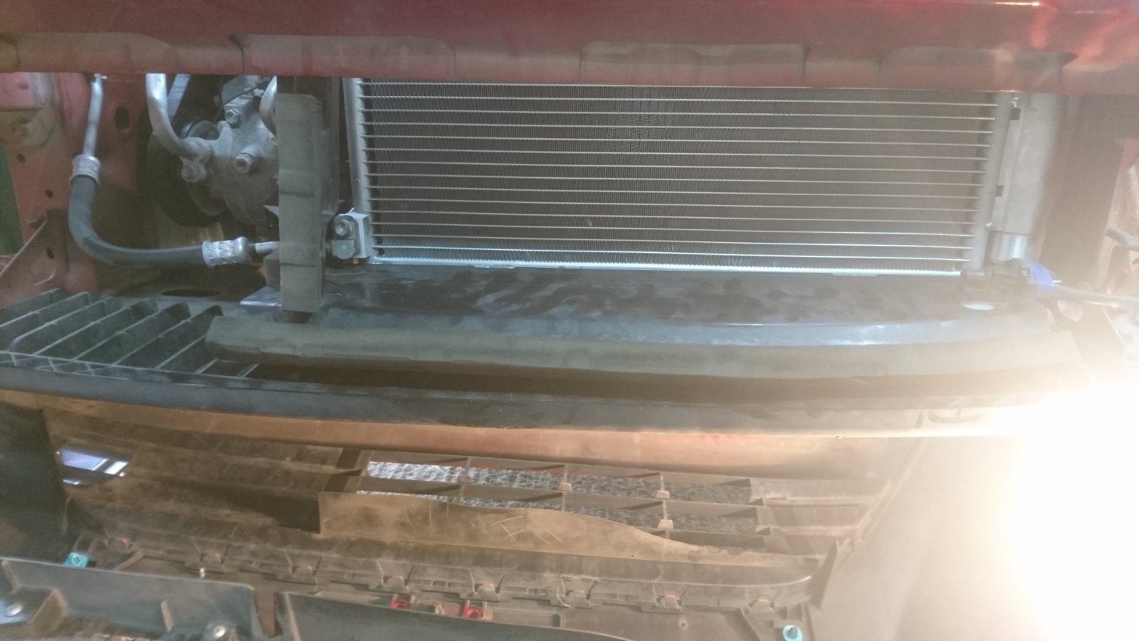

I had an early rise today to get a job done before the heat sets in. Basically a reasonably easy replacement of the A/C condenser in SWMBO's Suzuki Celerio. She had a mobile aircon chap come to do an A/C service a couple of weeks ago and he detected a leak in the condenser. He quoted £548 to supply and fit a new condenser which I thought was too expensive. I found an OEM condenser for £80 and the O rings for £10, given that I had to go to Bedford to collect, and got up to do the job today.
A matter of removing the front bumper held in place by 4 bolts, 2 screws and 12 pop fasteners, removing the cowling, 7 pop fasteners, and then disconnect the two pipes, remove the four mounting bolts and lift out the condenser. Replace the O rings lubed with A/C oil, install the new condenser and reverse the procedure above and all done in time for morning tea!!
I only remembered to take some pics after the new one was in and I'm afraid the light has spoiled them but you get the idea!!

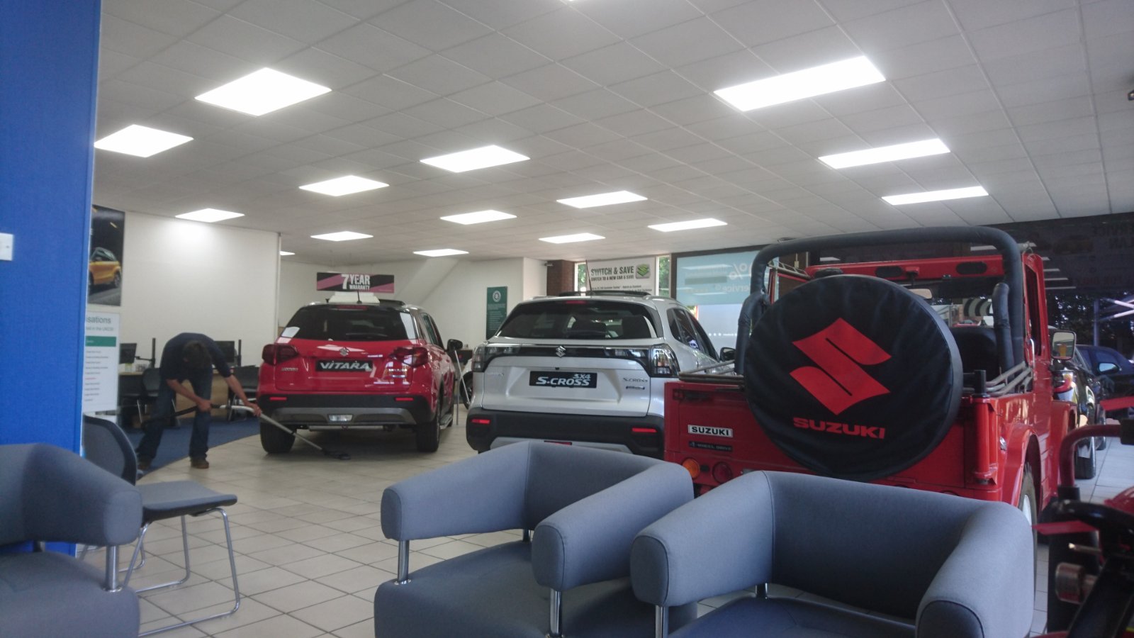

Following the new condenser install SWMBO took her car to our local garage who look after our MOTs for a regas. Unfortunately they were unable to do it as it was showing a 'low pressure fault'. Not surprising to me in view of the condenser change but I was surprised that they were not able to clear that to deal with it! However in view of the current hot spell I have brought it to Hilton Suzuki in Spellbrook where it is currently in the workshop being sorted (I hope!!)
So you find me in a very alien place this morning, a main stealer service reception area with free wifi and a TV for company. So I thought I'd post this just remind other like minded members what a main stealer looks like!

Indeed it is thanks Jim, car has ice cold aircon and was hoovered, washed and polished to within an inch of its life!! I'd reconsider my opinion of main stealers if they were all of the same service level that I experienced!! Maybe times are changing for when I had settled the bill and got back in the car I actually felt that it had been reasonable value for money. It actually brought the total cost of my DIY replacement to £239.35 which has to be compared to the £548 SWMBO was quoted for the specialist aircon firm to complete the work!!CitroJim wrote: 15 Jun 2023, 16:04 Reminds me of the time a few weeks ago I went with Robyn to collect her Clio after its service at our big Renault main-dealer.. It was both interesting and quite a culture shock!

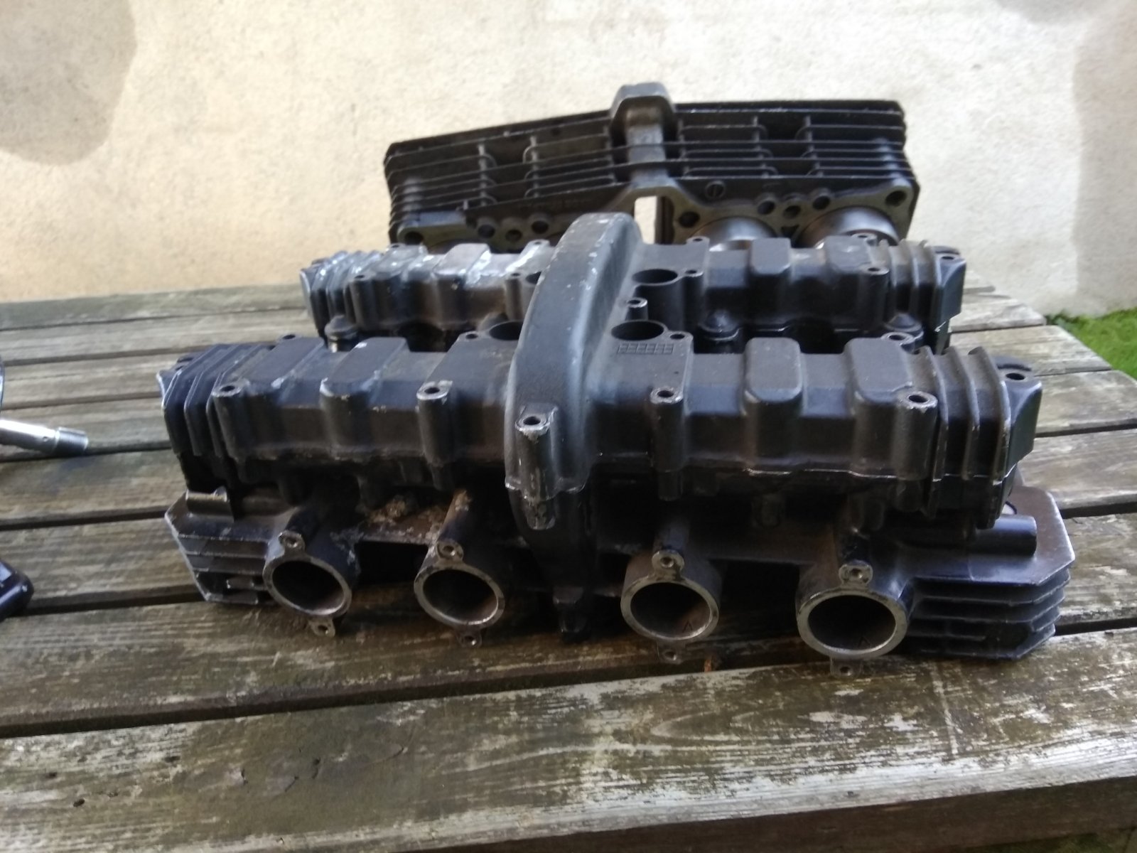

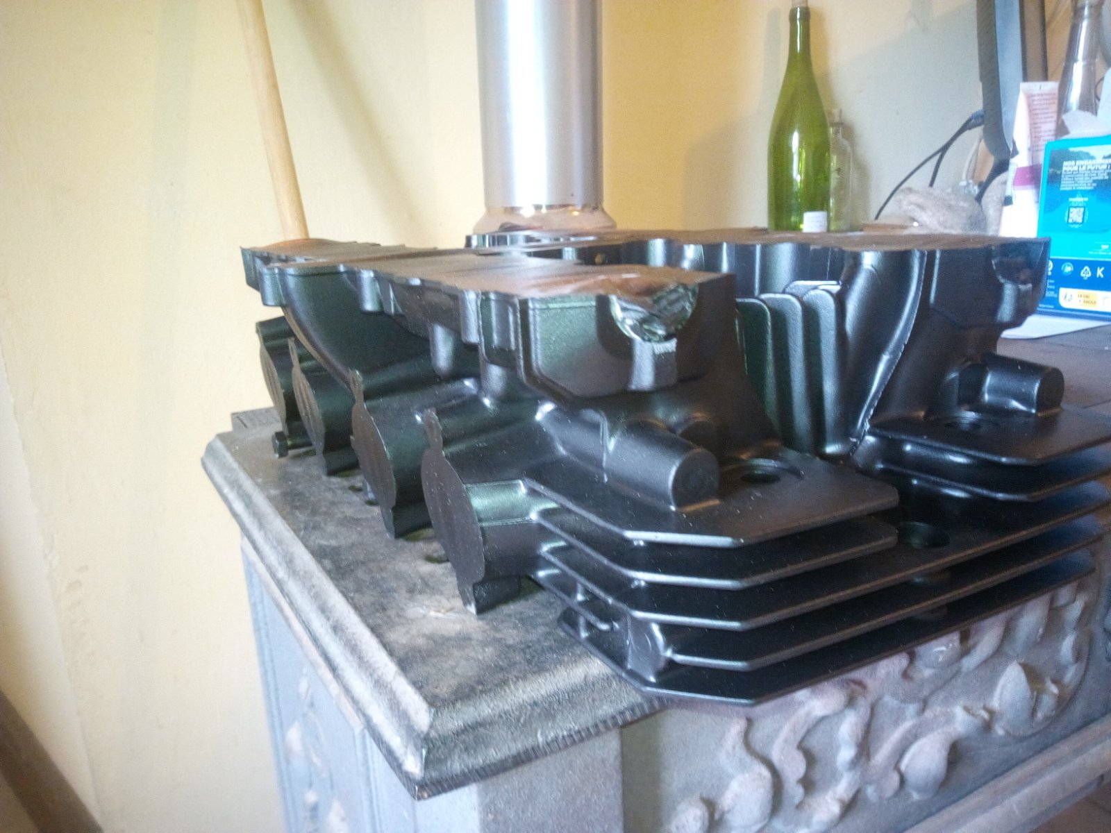

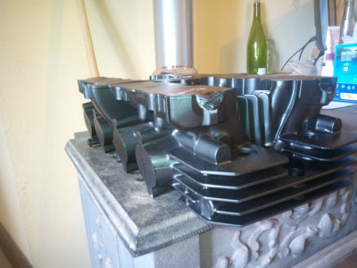

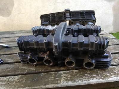

Just to follow up on the cylinder head. It now looks like this
Instead of this
And the paint used is a rattle can.
Used by many on classic bikes, I've also done the forks, yokes, and other engine parts. Just the 2 crankcases to go and a rebuild can begin.
