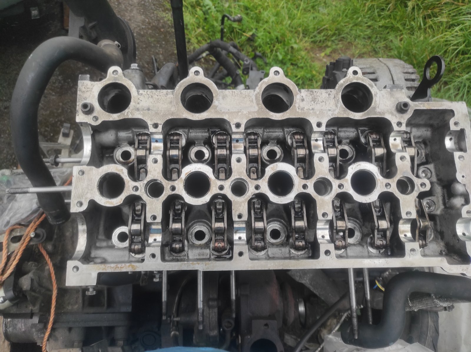

Only got the lifters in last night and cleaned up the cams

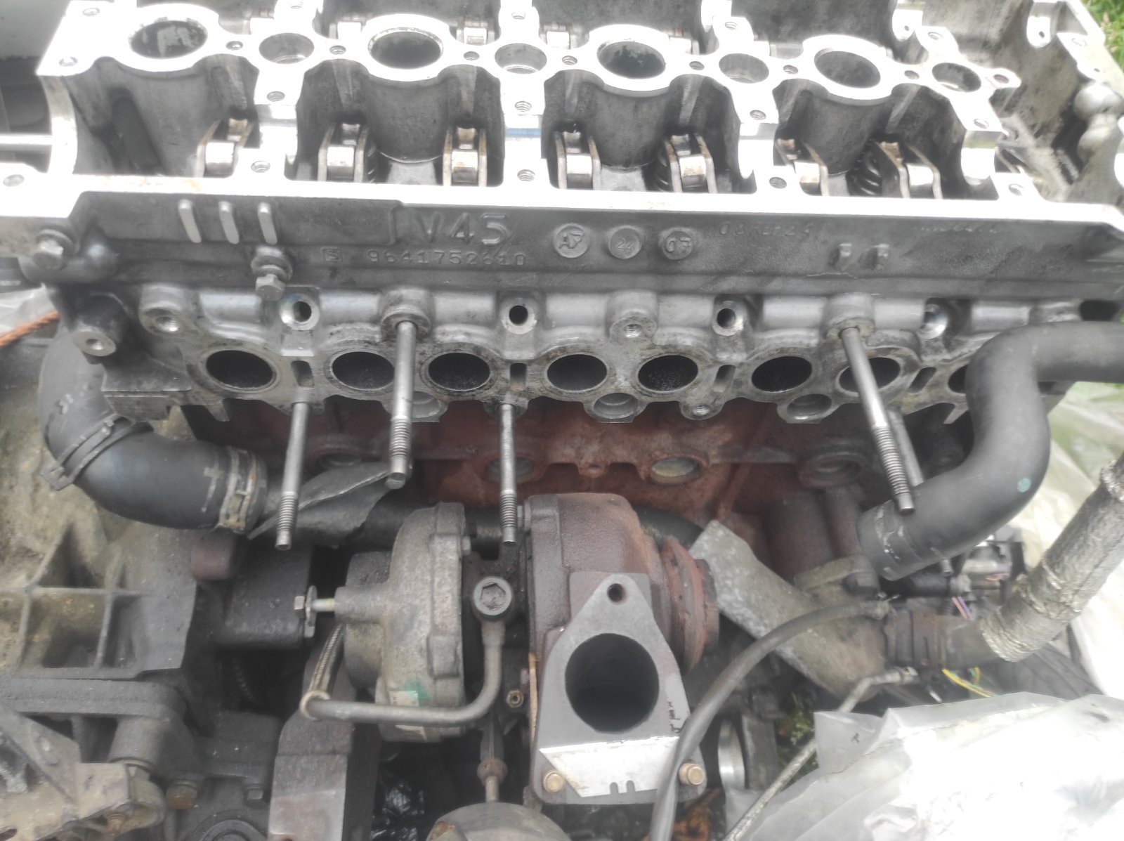

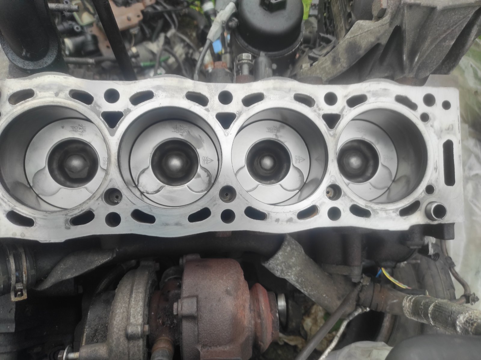

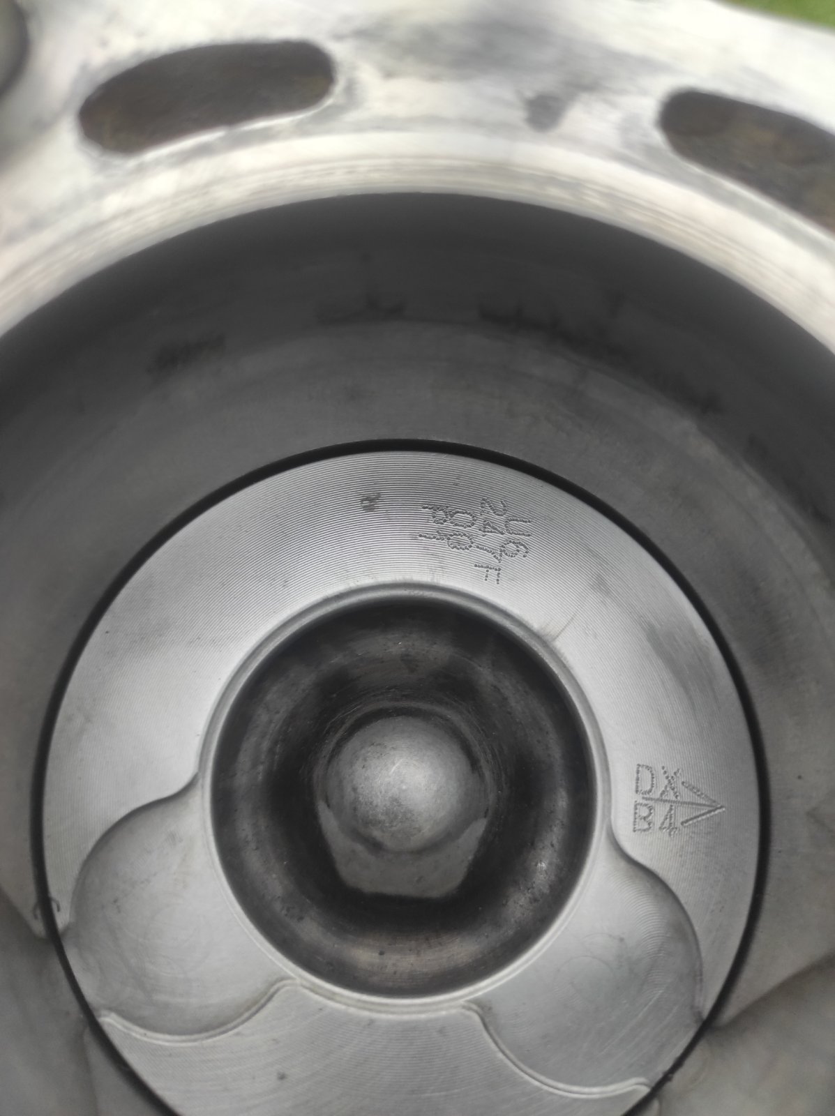

Hi lads and ladies, I have a few more pics of my engine rebuild, I forgot to photograph the head gasket itself. I discovered three of my tappets (hydraulic lifters) are no good so have to wait on new ones to arrive to finish it off. Nearly there now.

Great pictures, looks spotless
Couple of questions:
Did you treat yourself to an engine stand? (I remember they seemed to have gone up on price considerably since I bought one for £37) you've more patience that I have if scrabbling about at ground level!
How did you test/find out your hydraulic lifters were duff? I didn't test mine at all, just squeezed them in a jam jar of new engine oil (and each ejected a little "cloud" of filthy black oil into the clear new stuff= made me feel better even if no actual benefit!)

Thanks Matt, no not this time, too expensive. I will get one eventually for a few other projects I have planned for the future unlike this unplanned one. I am just taking my time with it.
Scotch brite pads on a screw gun so not so much patience needed and done on the driveway so done in the sun and throwing the ball for the dog
simple pleasures.

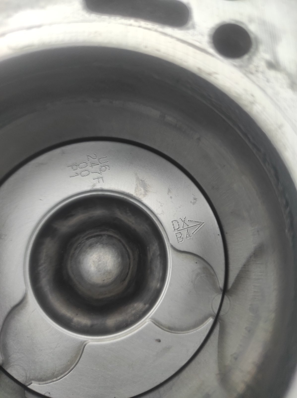

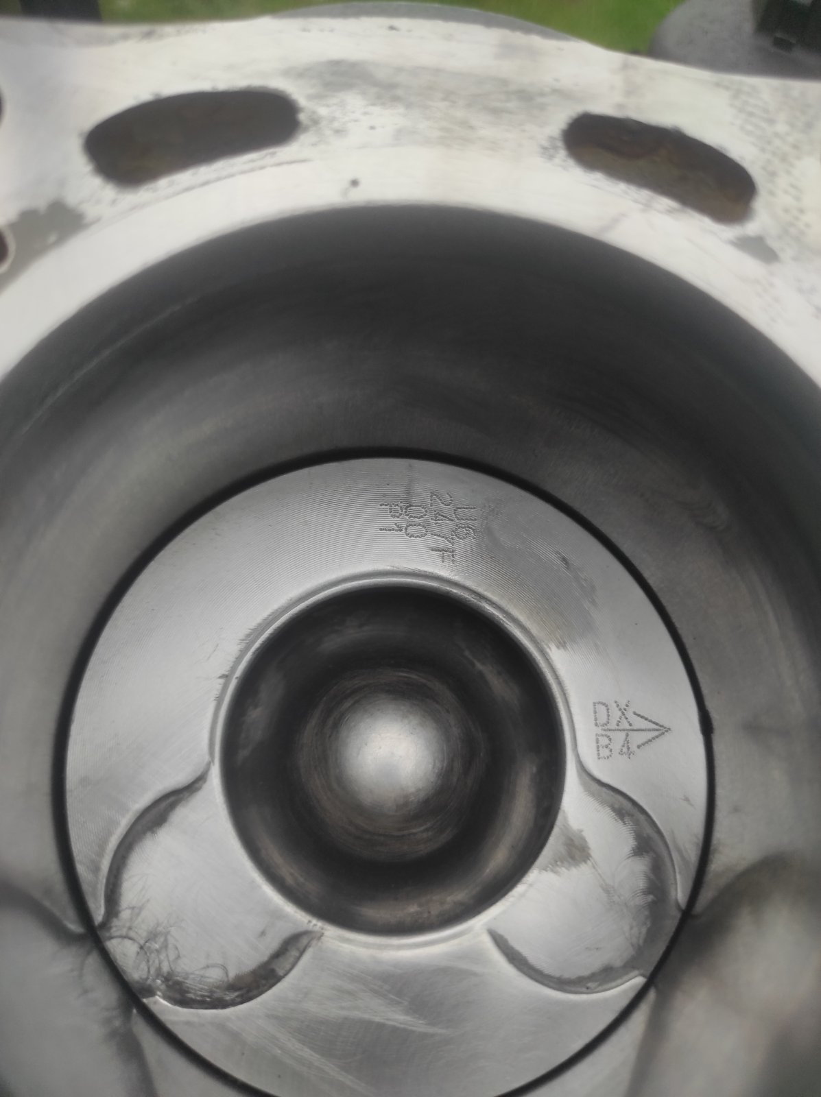

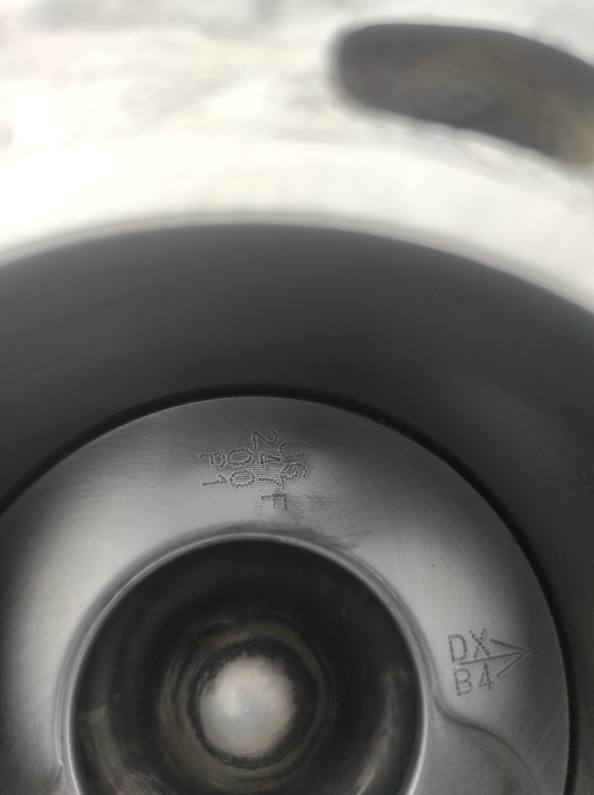

They are not supposed to be compressible by hand is my understanding of them, three of mine were very soft and on guess where cylinder 3.
There was something very strange going on in there.if you zoom in on the first cylinder pic you will see a circular indent on the piston on its outer edge where it was hitting something which I wasn't able to determine,
but I think if memory serves me there was something in it but I had originally thought it was from when I pulled the head so didn't think about it until I discovered the someone was at it before that much I do know. There was damage to the shroud of one of the head bolt seats but nothing to bad to fix thankfully.

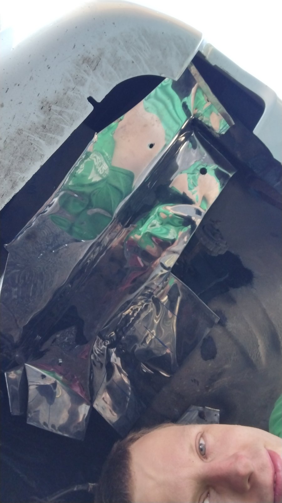

.it's really just tidying up left to do on it now then put the engine and gearbox back in. I am going to have to make a new manifold heat shield. The foam and tin-foil original is torn to shreds and was before I started.

I can recommend stainless steel from an old cooker hood! That's what I have used: Think enough to cut with aviation snips, easily bent, shiny shiny! I bent all the raw edges back over to remove the lethal edges. Surprised how time-consuming it was to do!darbuck wrote: 06 Jul 2023, 15:23 Hi all got the timing belt and covers back on today, have new rocker and intake gaskets on the intake manifold ready to fit.Weather is turning crap again though so probably won't get back to it today

Jasus that is shiny, stainless is difficult to cut with snips it can be hard on the blades too. I used go through an awful amount of tin snips when I was plastering, stainless steel stop beads would wreak havoc on the blades. Hmm should have something lying around that will work no cooker hoods though.

A little grinder would eat through the stainless steel, stuff cutting with snips!

Yes true it would be a lot easier. I have a kind of foil polymer heat shield material I forgot I had bought I'll let you know how I get on.
