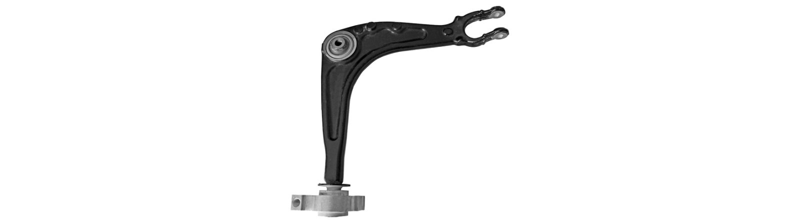

you wouldn't know what that part is called, would you?

Chapron wrote: 07 Jun 2023, 20:11 Dear Steve
Thanks
Lower "wishbone", or "control arm" :)

Or triangle as they call them over here in French Land

Thank you, that is very helpful.
