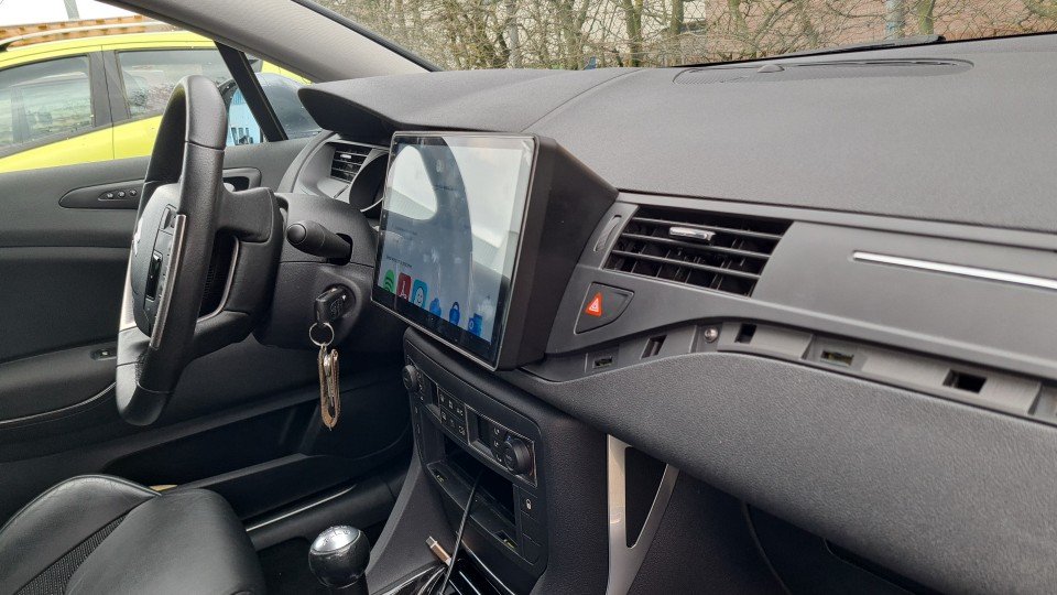

I fitted a Chinese Android unit to my 4007 & i Gained :-
USB & aux in for music
Bluetooth music streaming
Reversing camera
Built in updateable offline navigation (can also use Google & apple maps)
Apple carplay emulation (wireless)
all the other use of android apps so i can even link my dash cams in via the android apps.
This is all with full use of the steering wheel controls & voice control.
What did i loose? My CD player. As I havent used CD's for about 10 years this wasnt even a tiny bit of an issue for me

Just used the harness that came with the kit. You order them for your model so the come with the correct surround & harness. Most stuff is done via the CAN. The steering wheel controls are fully programmable, you just configure it on screen the first time you set it up. You can even change the buttons to do different things.

I've been nosing around trying to find answers for Android HU installs specifically for a C5 X7 for ages, so I hope you don't mind me asking some things.wheeler wrote: 06 Jun 2023, 16:19 It will depend on your car & spec but yes you may loose some features but the gains may well outweigh them. Eg you might loose the parking sensors but may gain a camera, i know what i would rather have.
Reversing camera
The main thing I have been trying to understand is how do you actually install it? Does it work with the old radio, for example, and only replace the screen or do you have to remove the old radio as well?
I know these sound basic but no video shows things like this, and I haven't risked getting a Chinese HU because of the lack of the most basic of information.

I'm considering installing android radio as well. I did a little research and it seems that you will not have have the old radio and cd changer. Android tablet fits in the old screen place with some plastic cover. It should look like one in the picture.citroC5 wrote: 17 Jun 2023, 12:33I've been nosing around trying to find answers for Android HU installs specifically for a C5 X7 for ages, so I hope you don't mind me asking some things.wheeler wrote: 06 Jun 2023, 16:19 It will depend on your car & spec but yes you may loose some features but the gains may well outweigh them. Eg you might loose the parking sensors but may gain a camera, i know what i would rather have.
Reversing camera
Buttons on steering wheel will work, but you will need to assign them in new android radio settings.
I think you can leave old radio in place, but it surely won't work as all connectors will go to android radio. One thing that stops me from buying it is that I can't find some plastic covers to fill the empty space (you can see it in the picture) from the old radio.

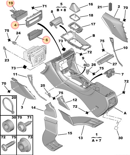

@citroC5: That's not a problem, are these the fittings you are thinking of?
(4) Floor Console Face (Nero Mistral), part: 7589ZW.
(6) Floor Console Storage Compartment Nero Mistral), part: 7589YQ.
(19) Dashboard Storage Compartment (Black Cornelie), part: 16089498ZD.
Note that in the second photo in the post above, that fitting was for vehicles on the last production run fitted with the 7" Touchscreen, where the head unit is inside the fascia and the switch block controls for some functions are moved either side of the compartment.

Yes, that's itGiveMeABreak wrote: 19 Jun 2023, 09:28 @citroC5: That's not a problem, are these the fittings you are thinking of?
(4) Floor Console Face (Nero Mistral), part: 7589ZW, part: 7589ZW
Problem is, they're nigh-on impossible to find anywhere
- x 6963
Re: 2009 C5 Android Head Unit Install
You can buy these direct from Citroen - the above are the official part numbers. They won't be cheap though...
