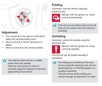

I've looked at paper manual that came with car and online version and neither say to rotate switch to bottom. Anyway sorted now :-D

Yes that's the instructions for the DS5 and on this vehicle it's always move the dial down to fold / up to unfold. All the online versions are the same.
On the C3 it had a dial, but required rotating 180 degrees to fold / unfold manually, but may PSA card have the mirror foldback control on the driver's door panel with the directional control switch that is moved down to fold. Glad your sorted the issue.

To clarify - I do have a DS5, so the manual is wrong or the switch has been changed? Either way, rotating the switch worked, as per the C3 instructions
