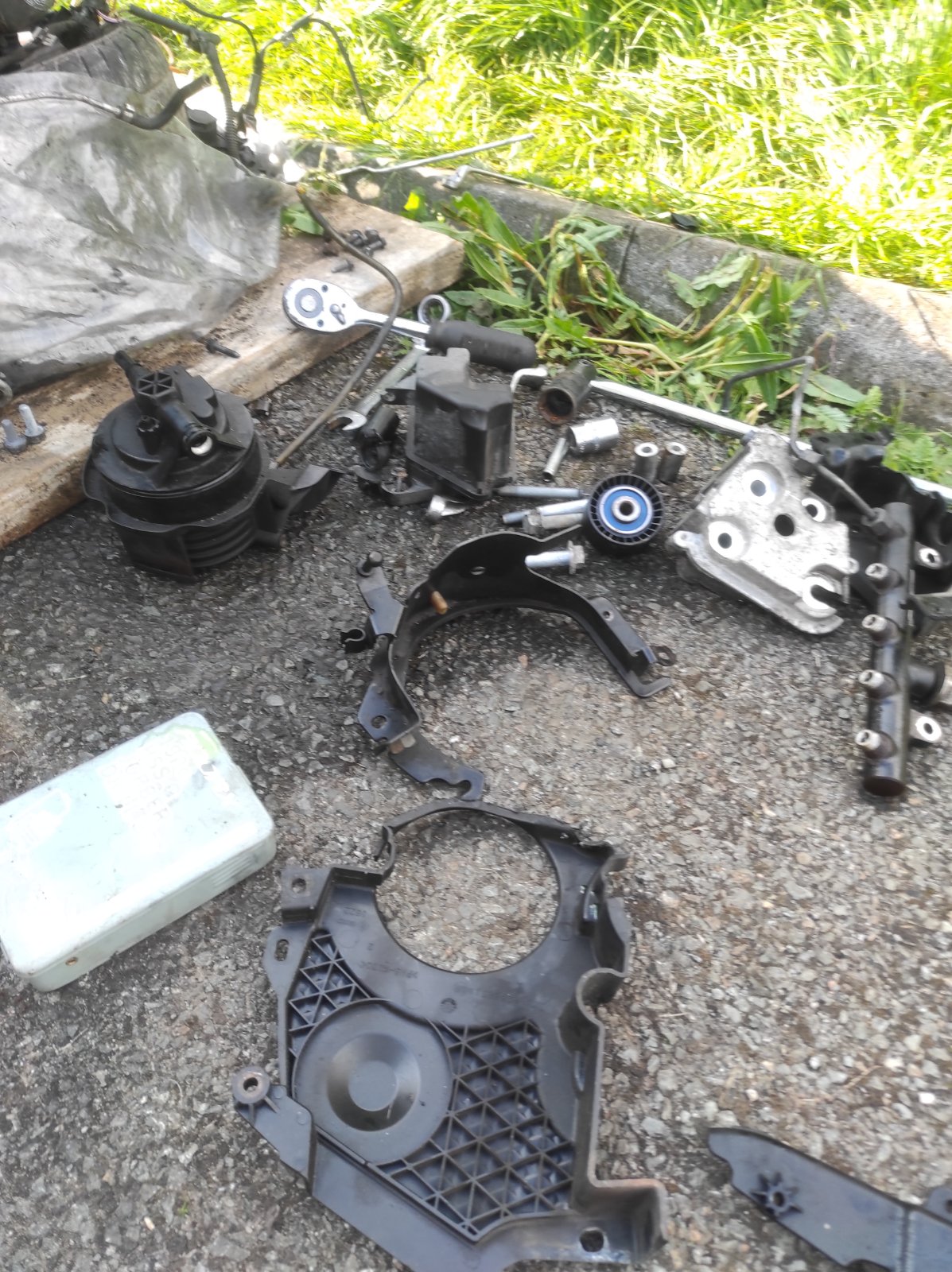

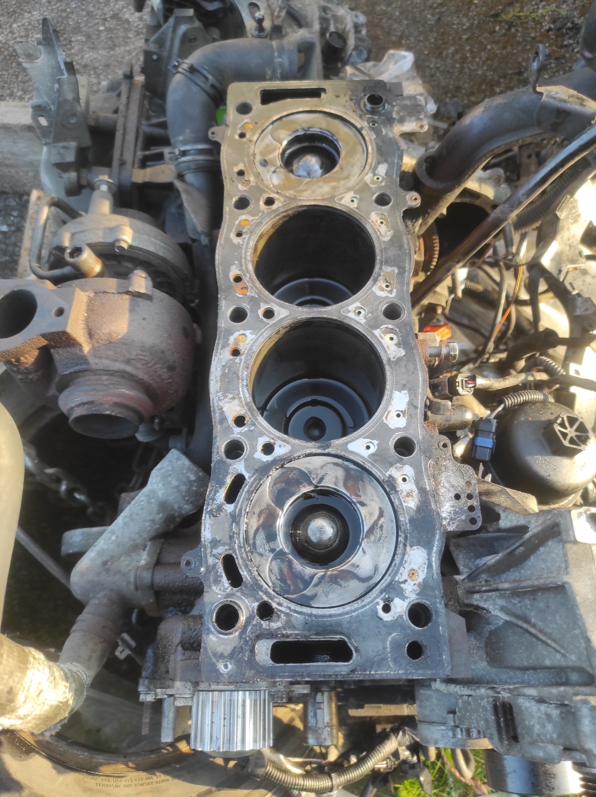

Hi all I finally pulled the head and tapped out the rest of the injector. I will post up more later

Re: Injectors misbehaving but trying to understand the numbers
Good progress, bet you are more than glad to finally have that broken bit out!
How is the head / inlet ports for filling up with crud? Much cleaning out to be done there?
